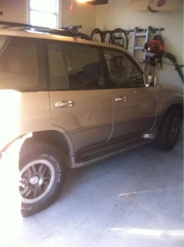

1 Have them, love them.
2 Balance perfectly.
3 1 inch on all four wheels.Got them from Carl @ www.[B]justdifferentials.com (great guy)
4 N/A
5 Pics attached
The only downside to the spacers is that not all shops will work with them. They think spacer and assume cheap chineese junk and liability which floors me when i come in in a Lexus..... If it were me i would spend the time and paint them flat black/dark grey and most all techs wouldn't even notice they were there. A minor inconvenience for the look i wanted/love
