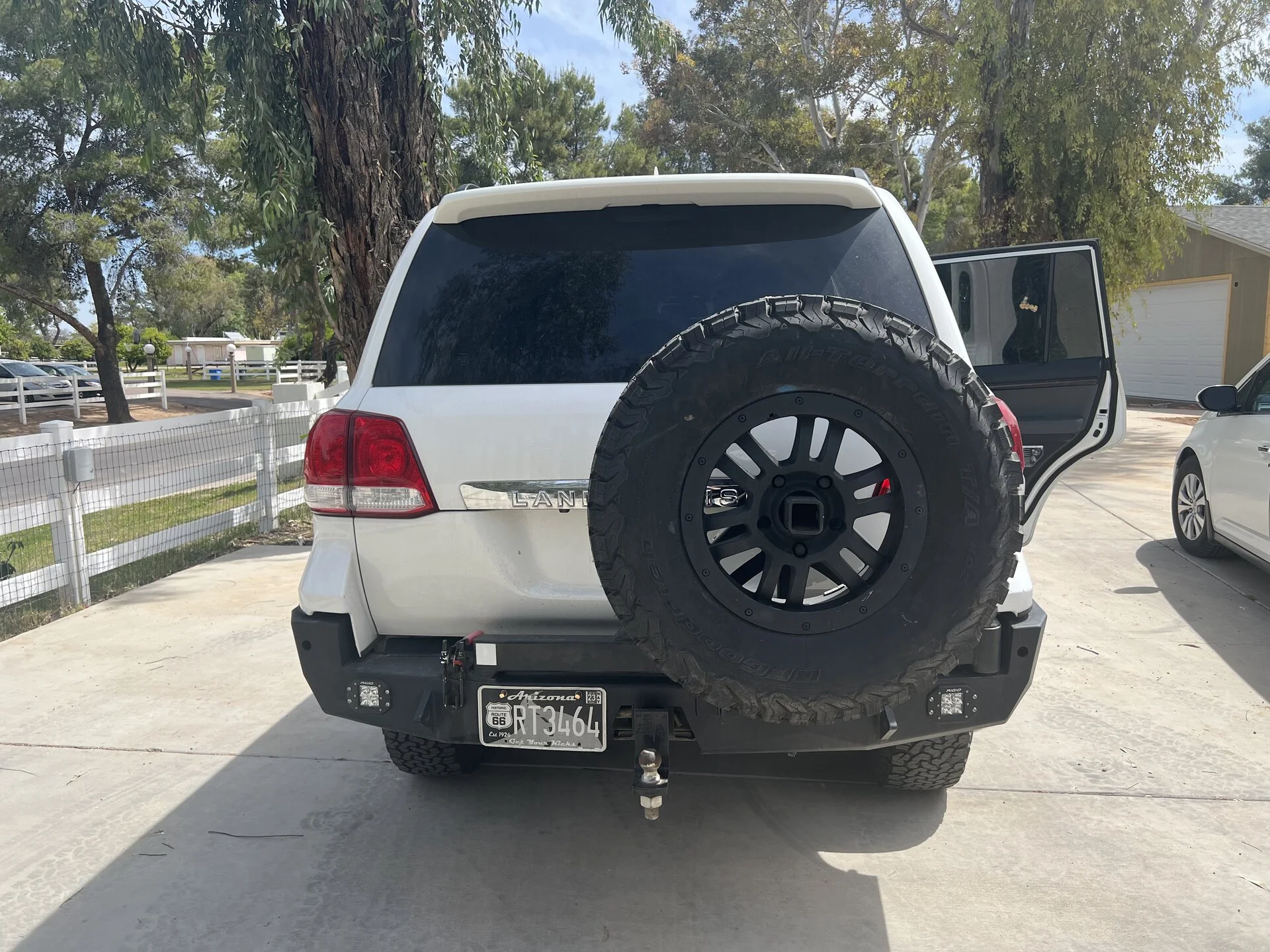

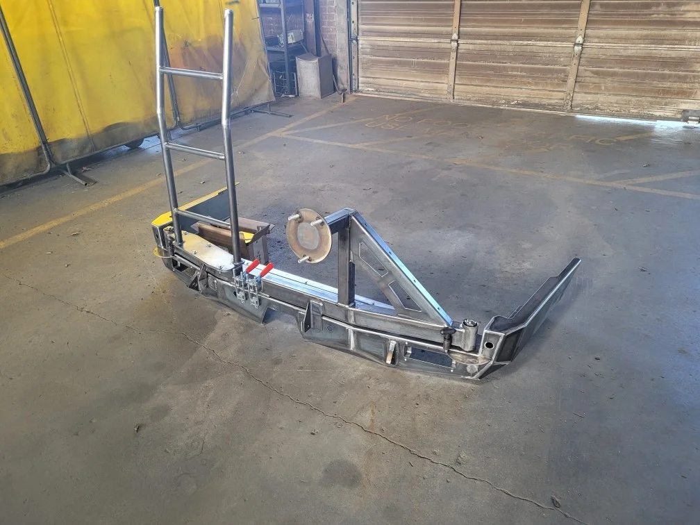

Progress pics:

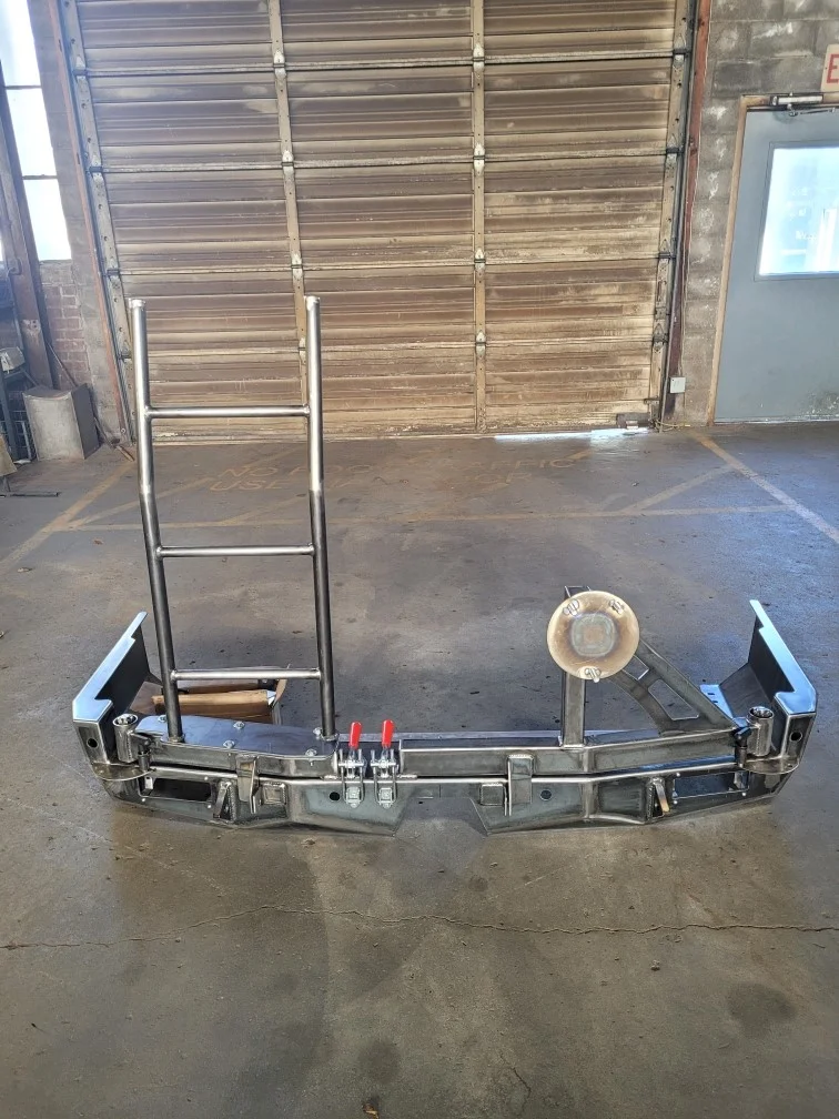

What's the purpose of the tabs sticking out of the bumper that matches the swingout tabs?
That's what his wife ties him up to at night.

Just an update that I customized the RLC bumper a little.
Added the following from 4x4labs:

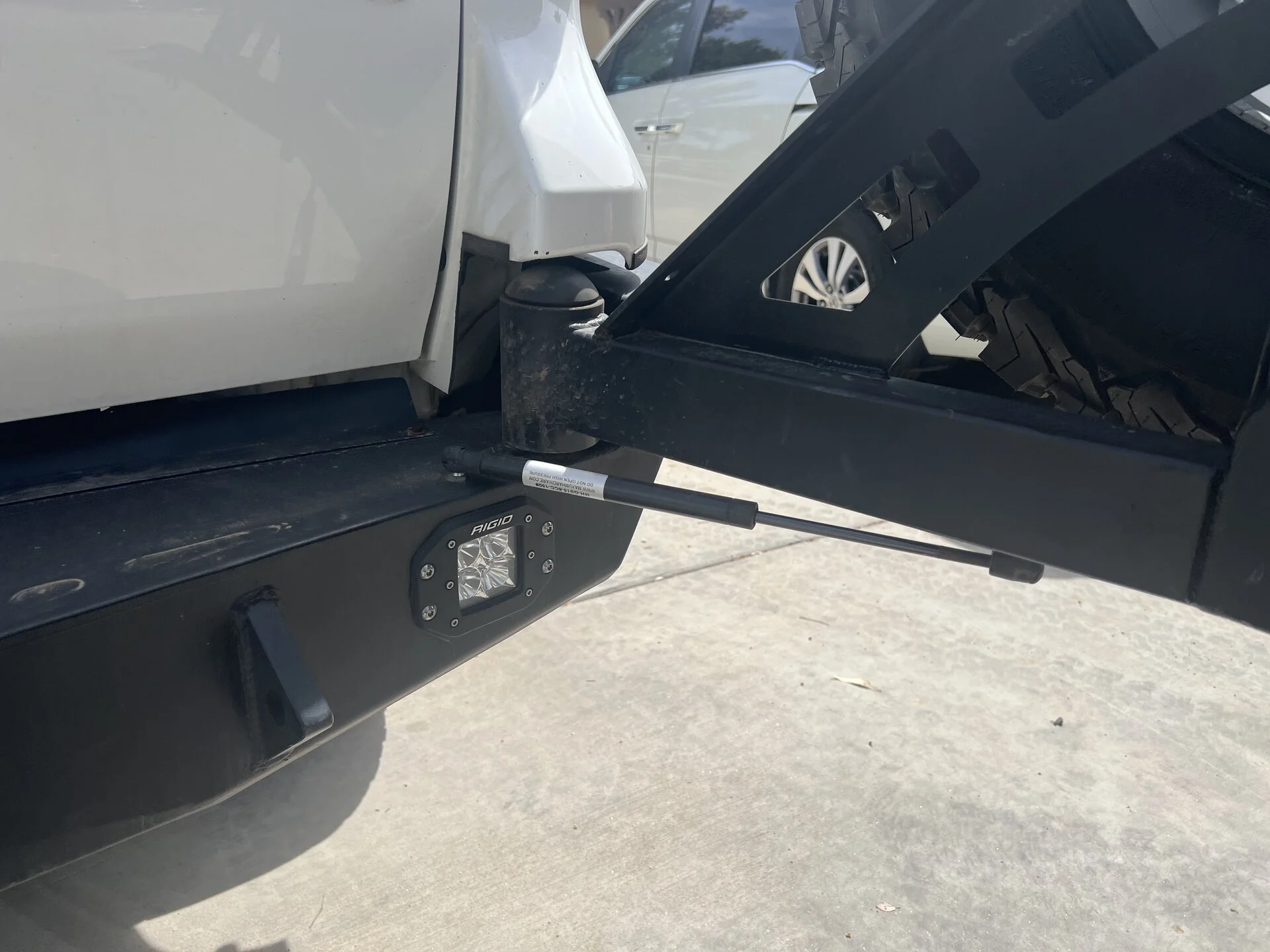

Spindle - three days w Jerry loaded Jerry cans and a trasharoo tweaked the stock RLC spindle.

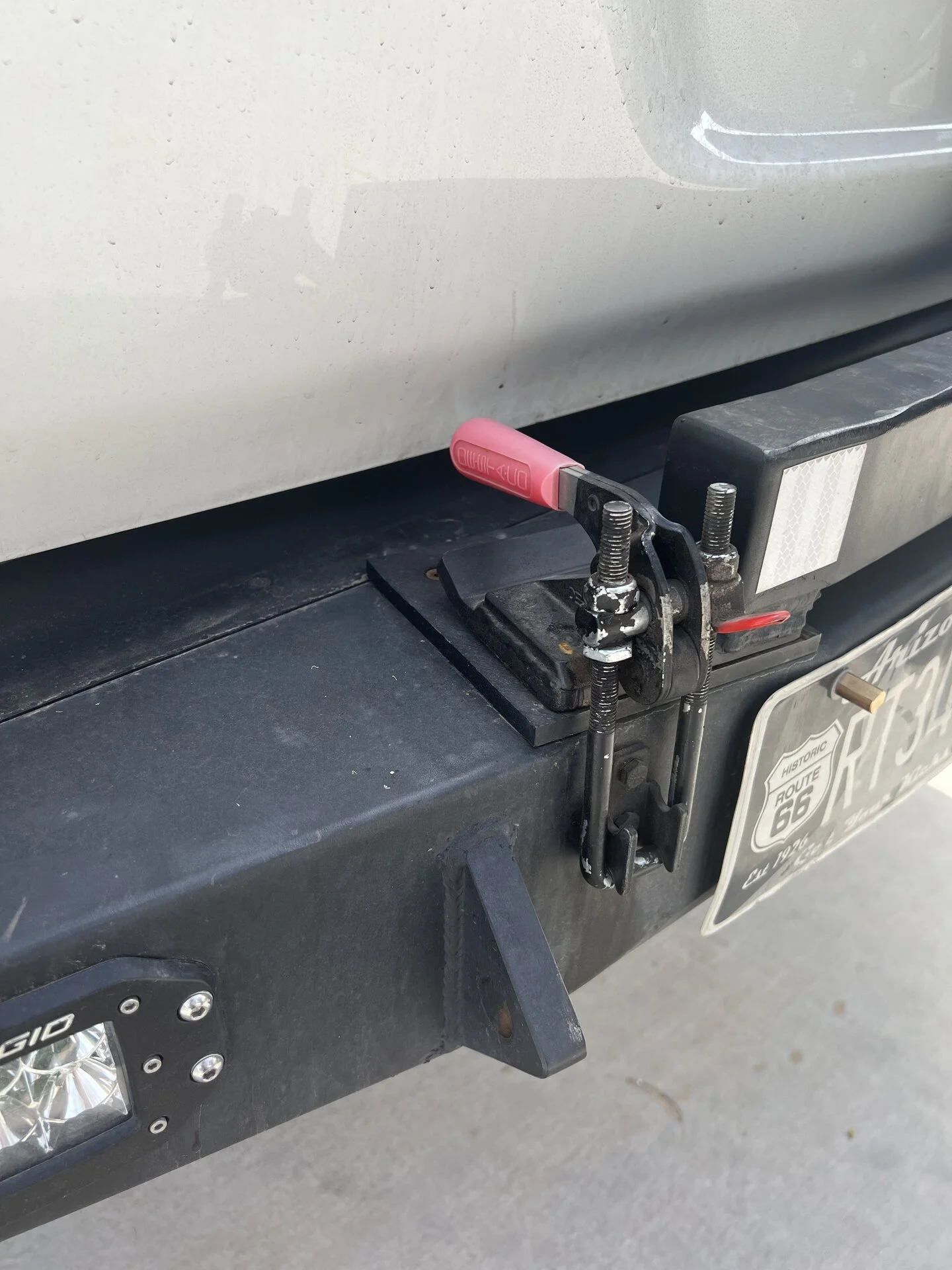

Latch - improved confidence in the latch staying closed relative to the stock RLC latch. DeStaco vertical is what I have for the single swing out.
Gas Strut - opens and closed more smoothly
Spindle Assembly - https://4x4labs.myshopify.com/products/spindle-assembly
Then, I added hdpe perch for when the swing arm is closed. To fit the gas strut, we moved the swing arm slightly up on the new spindle.
We also moved the tire holder a little to the passenger side to open up the factory reverse camera. It doesn’t obstruct the over the shoulder look out the rear window.
And we relocated the license plate w some license plate lights.
Very pleased with this setup.

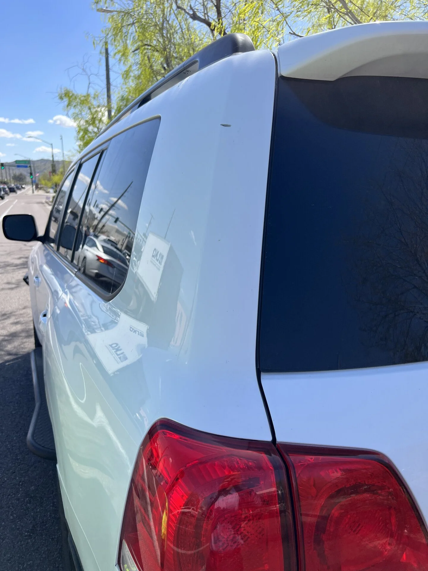

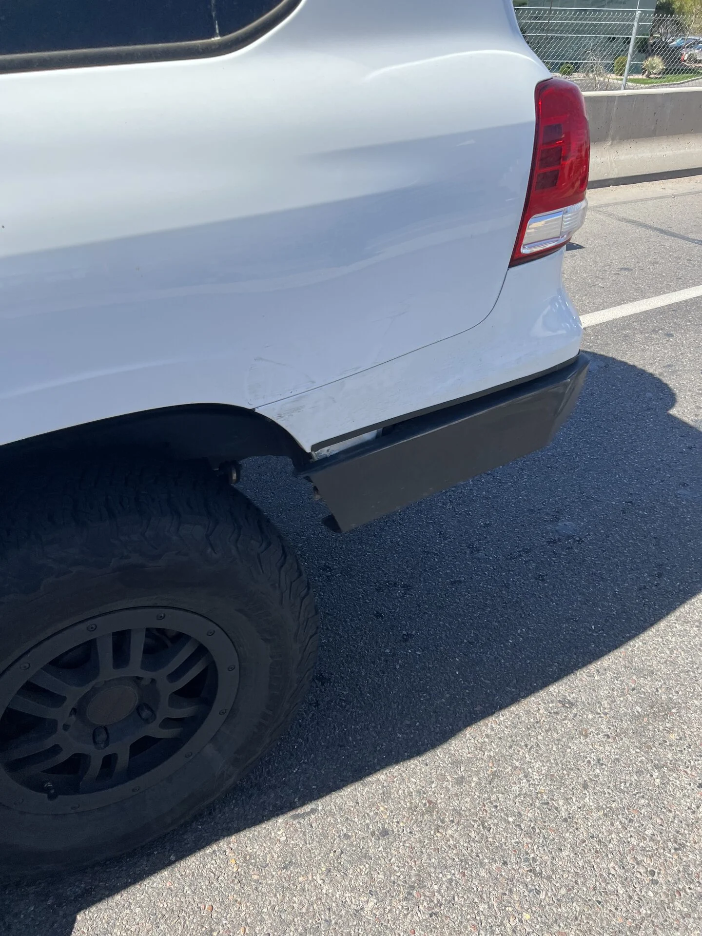

Then, I got hit by a city bus driver in training. Clipped the driver side of the rear bumper before scraping against the side of the vehicle.
RLC bumper took the brunt of the 43k pound blow (20-30mph while I was stopped).
Frame measurements came out 2mm, where Toyota factory tolerance is 3-5mm. So, the 200 got hit by a bus and didn’t flinch. Love the fully boxed frame.
Am now ordering a replacement bumper from James at RLC, bc you can see the old bumper is now compromised. But, even w these modifications, his bumper remains the best bang for the buck out there, imho.
And it took a hit from a city bus.
Body shop said there would have been far more damage if we didn’t have the steel bumper. Our Honda Odyssey would have definitely been totaled.
Thanks James! Great bumper!
Pics of the damage after getting hit by the bus.
Mainly pushed the bumper down and bent the side wing holding the drivers side in place. And the bus’ side mirror left a blemish on the rear pillar. Minor damage to the bumper insert and to the body panel over the rear tire.

Like your mods. I'm wondering for my dual swing if that 4x4 horizontal would be a good upgrade. 1 latch versus 2 sounds like a win to me. I am a fan of the two DeStaCo's I have on there though.
"Clamptek 7500 lb with forged handle (Double Swing Out)"
I like your gas strut idea too. So those are in addition to the T-pins....or completely instead of the pins? Just curious without the T-Pins how you get the open position correct so the tailgate can drop. Also curious if they lock open at all. Did you do these at home or did you have a shop do the work?

Regarding the T-pin, the gas strut eliminated the need for the t-pin. It’s so nice just opening it up and having it stay open and then closing when ready to close. I do not miss the t-pin at all.
The gas strut holds it open. We added a metal tab to the bumper so the new spindle housing could stop the swing arm from opening beyond the needed angle to clear the tailgate when down.

As I just have a single swing out, I don’t know the practical difference between two vertical latches and one horizontal. Welcome pov of those who have lived w both.
But, I am a big fan of the DeStaCo vertical latch. It clamps w authority and bites like a pit bull.

Vertical latches are better as they pull the arm down a bit which helps hold it in place. I have a horizontal latch, which pulls the arms together so they don’t swing out but I had to add some rubber bumpers to keep the arms from wanting to bounce up and down at the latch point. they work but even still I get a bit more wiggle than I’d like.

Yeah the DeStaCo latches are def solid. Well sounds like the double vertical is best to stick with then.
As far as the gas struts go, I ordered a pair yesterday. You think there would be any way to fit to mine without new spindles? My truck is gonna be down at Higgy's next week for suspension upgrade (MRR), so I was gonna bring the struts to Scott to see if he had any ideas how to fit. If he doesn't have any easy solution I'll DM you about your mobile welder guy.
