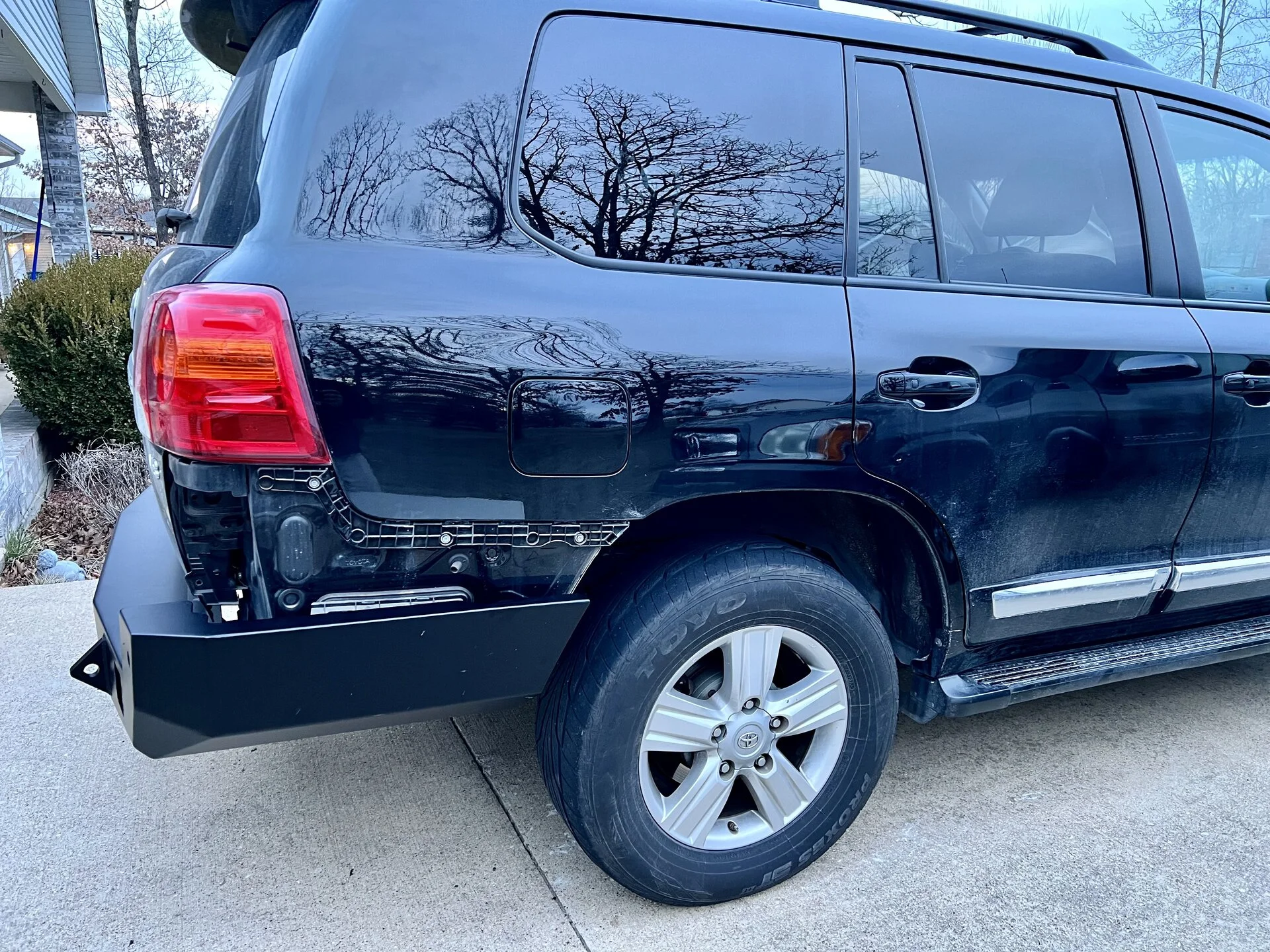

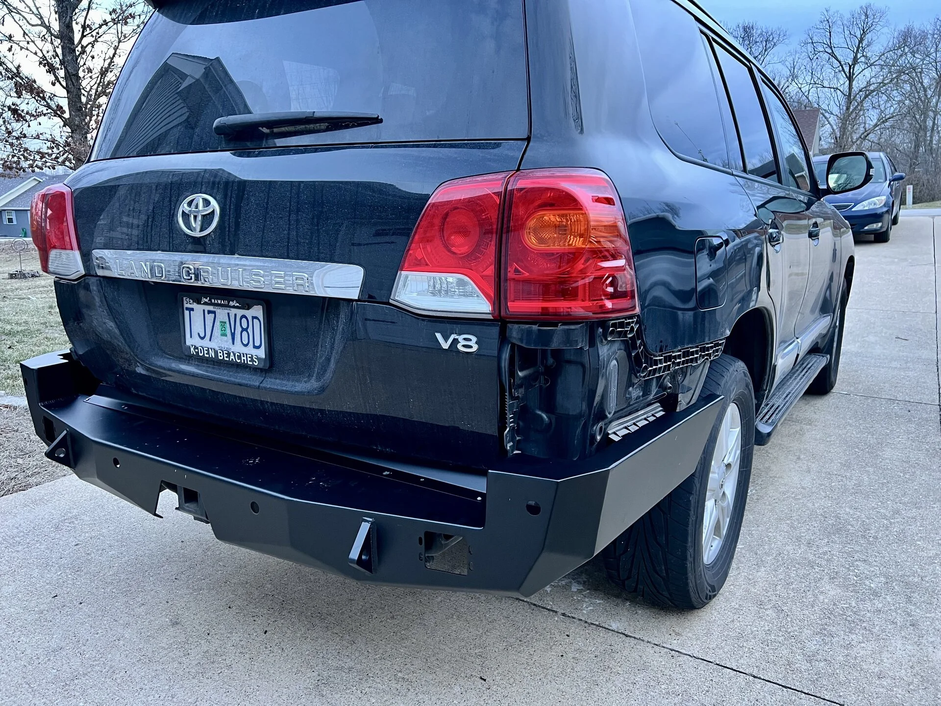

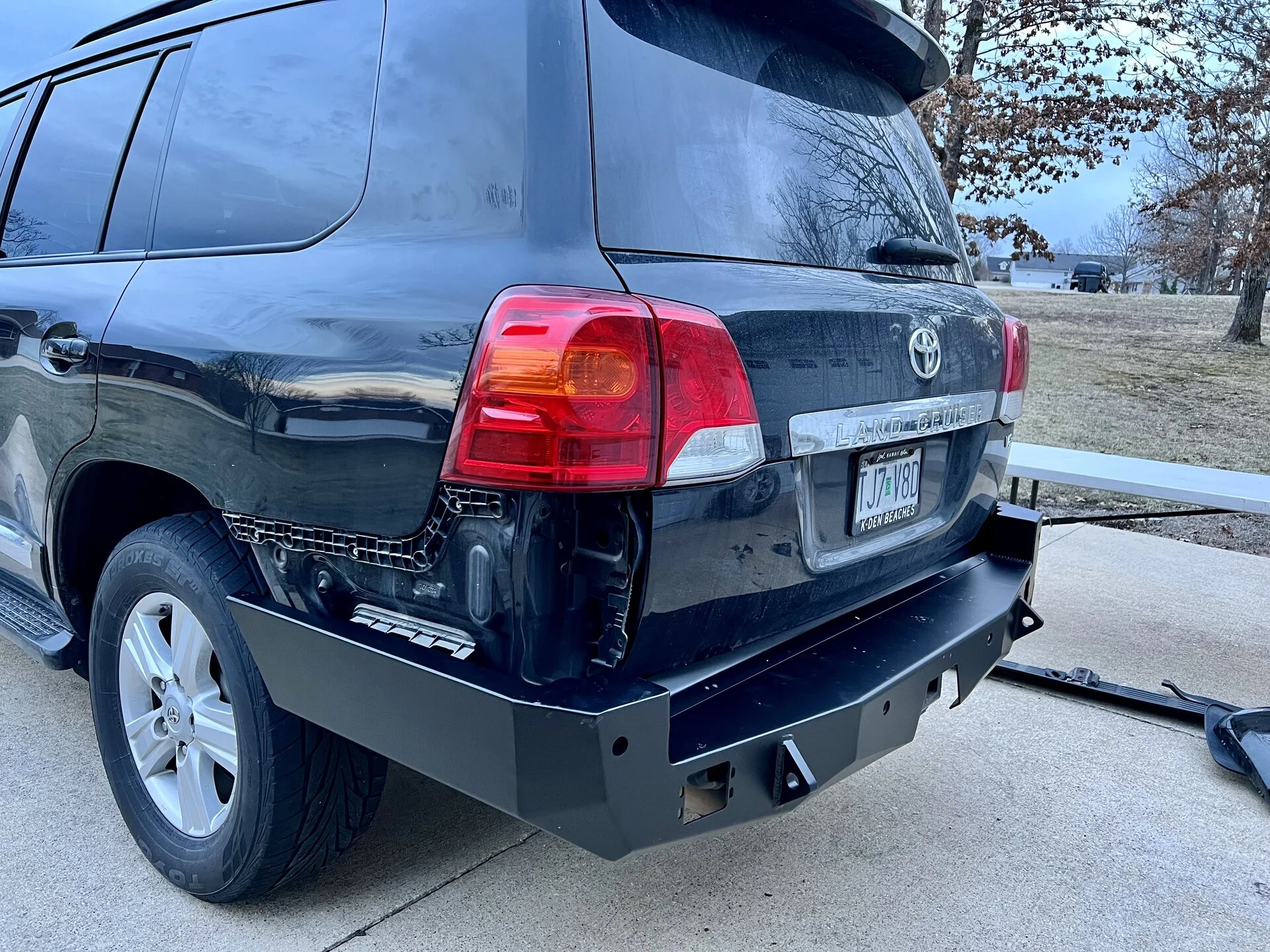

Just left Louisville, KY about an hour ago, did a turn and burn from Fort Leonard Wood, Mo. looks like I’m dropping this off to get media blasted and coated tomorrow. Looking forward to getting this on the wife’s 200
Is that a no swing arm version?

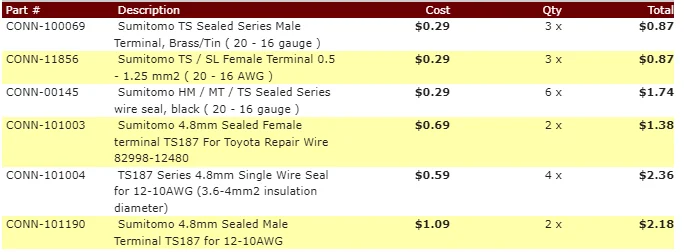

If anyone else wants to replicate what I did for the pigtail splitter/extension the parts are below for posterity. The rest are just 4 and 6 way DT connectors
Hey @linuxgod I'm getting ready to build a similar harness as I move my bumper over to the new 200 (I just spliced into the OEM harness before). Good work here and thanks! I'd have never figured out what pins and seal parts I would need for the OEM connectors. I wish Toyota would just sell the pins and other bits with the connectors. They only seem to sell the pins with pig tails as harness repair parts but instead of $.29 for the pin, they want $9.00 for the pin/pigtail and then you end up with a splice/crimp in the wire.

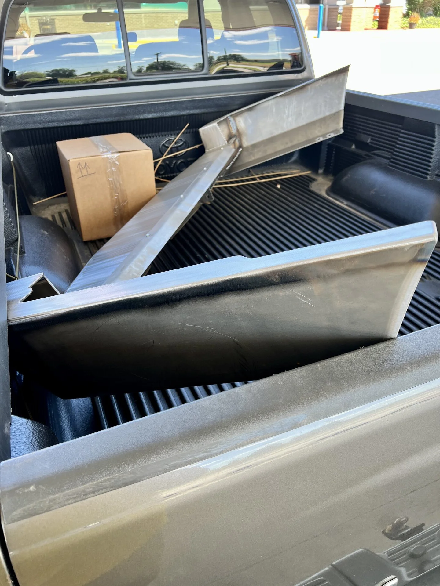

After 60k miles of hard abuse, My tire swingout on my dual RLC bumper snapped off. Ive since then upgraded to a double shear hinge from 4xinnovations.
Double shear
Double shear
Since I run my bike rack on the swingout this looks like a pretty good idea. Did you just weld it on yourself or farm that upgrade out?
