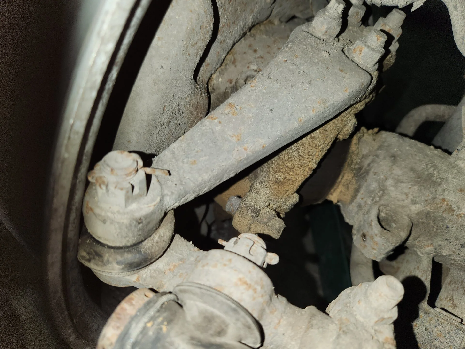

I currently have 15 inch and wanted to swap to 16 inch to fit my almost brand new 275 x 70 x 16 tires. Current ones are road tires and perform horrible on sand (well they are just as bad on road tbh brand called crystal first time i ever heard of them).
I have tried 2 16inch rims so far and they dont fit due to the steering arm (picture below)
Do i need to find rims with mounting bolts closer to car so the rim edges have enough clearance ? Or should i find a solution with 15 inch rims?
I am living in Egypt so options are very limited
When I changed the rims on my 82 FJ 60 , I wanted to go with bigger rims. I measured the back spacing on my original rim and used that as a guide. After searching on the net. I couldn't find any larger rims with the same back spacing except for 16" steelies that were too narrow . I stayed with 15" . If you can't find rims with the correct back spacing, wheel spacers are also an option .
That makes sense, this measurement trick will help thanks!
So i meed backspacing like the originals and a large negative offset to achieve that
I think i found the rims that can work, apparently the older Nissan patrol's had a similar issue with rims and steering arm. Measuring from studs to back is almost the same like the stock ones.
Will go have a look in the next couple of days and update the thread.

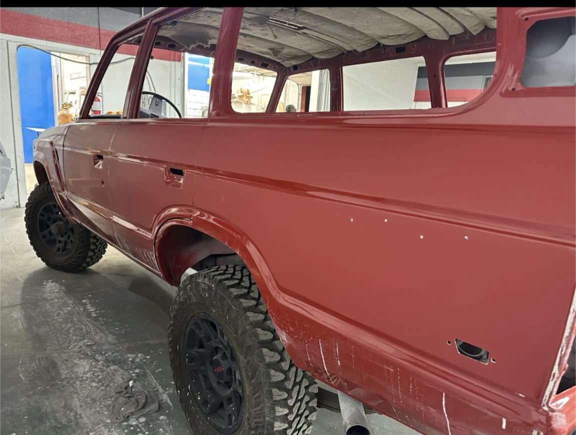

I went up to 17" TRD Taco rims, TRD 17-In. Matte Black - Alloy Wheel - https://autoparts.toyota.com/products/product/trd-17-in-matte-black-alloy-wheel-ptr2035110bk
There are a ton of choices for tire sizing for 17" rims. No spacers needed and fit inside the fenders with no problem. There is also 3 color choices, black, bronze and the gray that I got.
I went in this direction too!!!! Rims were very reasonable at $130 (i think) and Tire options open all the way up!!! As mentioned....direct fit too!!! And for me itll fit even nicer after the Coil conversion!!!

That looks amazing! Absolutly love the rims ....
