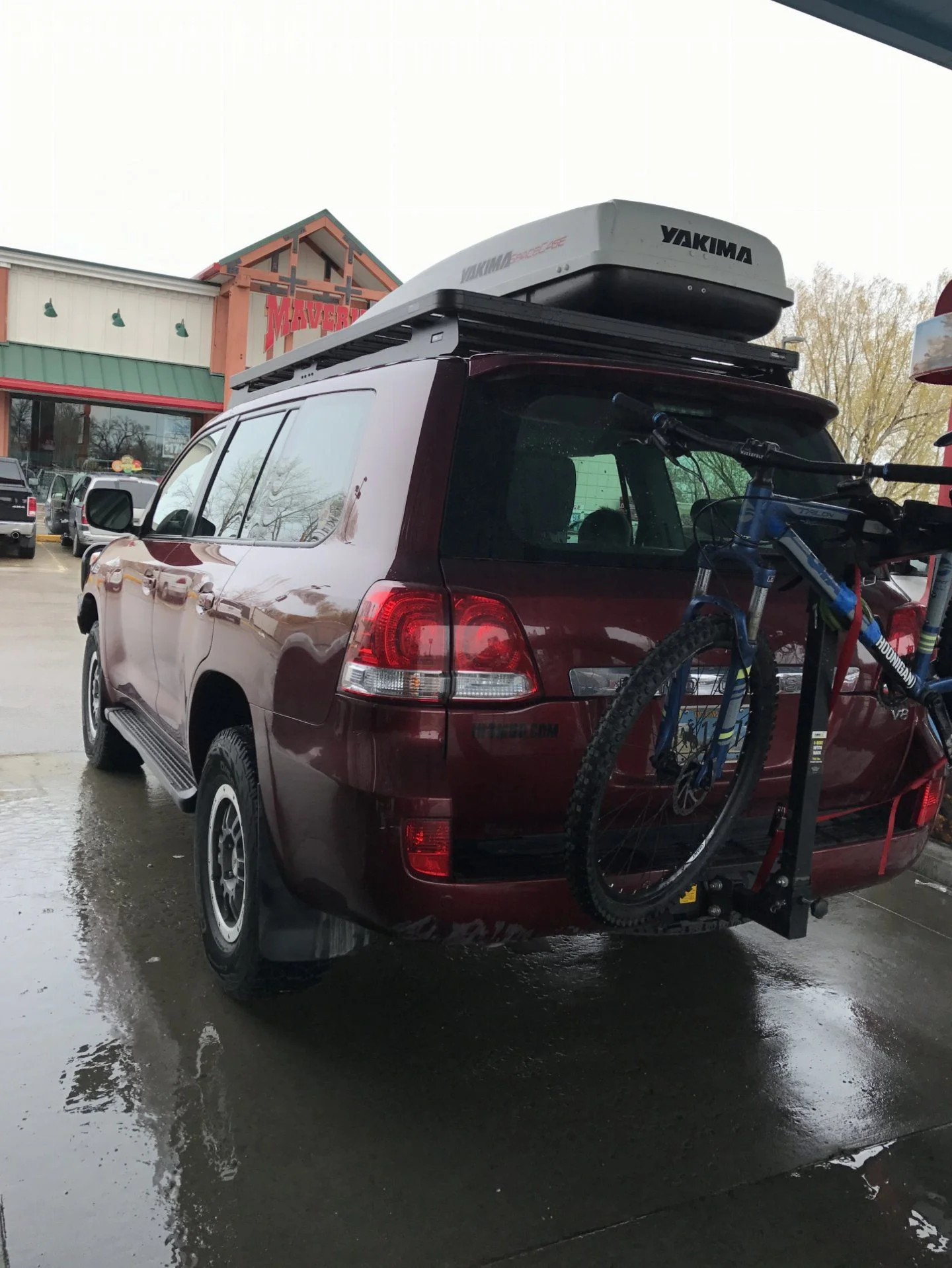

We love our 200. Have done Cruise Moab twice now. It's a fine truck. I'm so amazed that we can pile six of us plus a weeks worth of gear and a bicycle in this thing, drive it for 10 hours at highway speeds, unload the gear, throw off the Yaki box, air down to 16 psi and ride the slick rock like we own it!
Life is good!

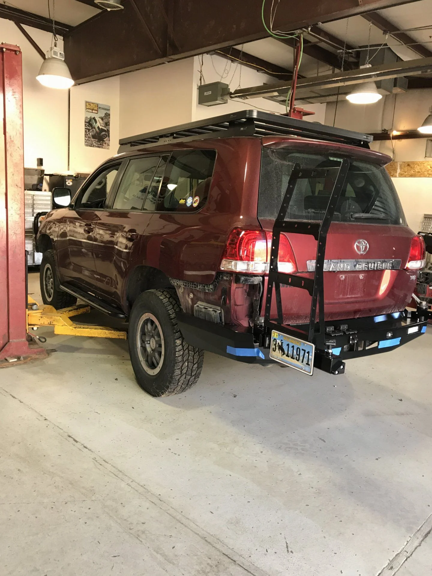

Headed to Slee Off Road, for a new rear bumper.
Sweet! I scraped, banged and buffed mine quite a few times...but a little rattle can, and she's no worse for the wear. Not even a HINT of a bend on any whack, bang or crash. :hillbilly:
My mashed up running boards are in the dumpster. Got some sweet Slee sliders on there now.
My spare is sorta grubby.

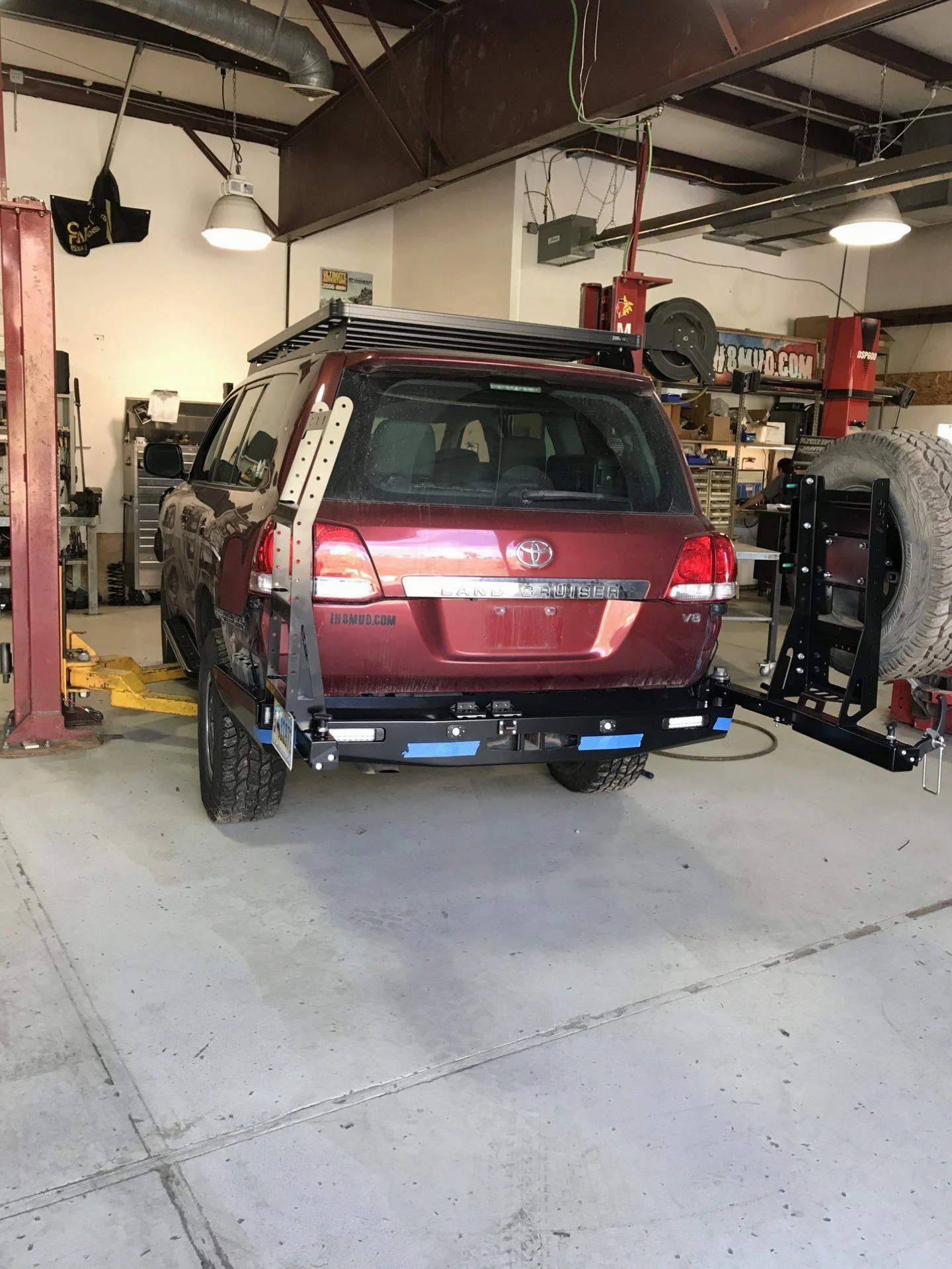

Thanks @sleeoffroad for taking care of our truck.
They got the rear bumper installed; works great, looks great. They got the step sliders installed; very stout, and functional. Also got us a new set of front brake rotors and pads, which are a huge improvement. That brake thing was a last minute deal, and Slee's guys got it handled on short notice.
All the guys at Slee are really nice, and helpful. Our mechanic was very accommodating. Amory was helpful and professional. Slee is adding on to his shop. I'm sure the expanded building and extra square footage will be great.

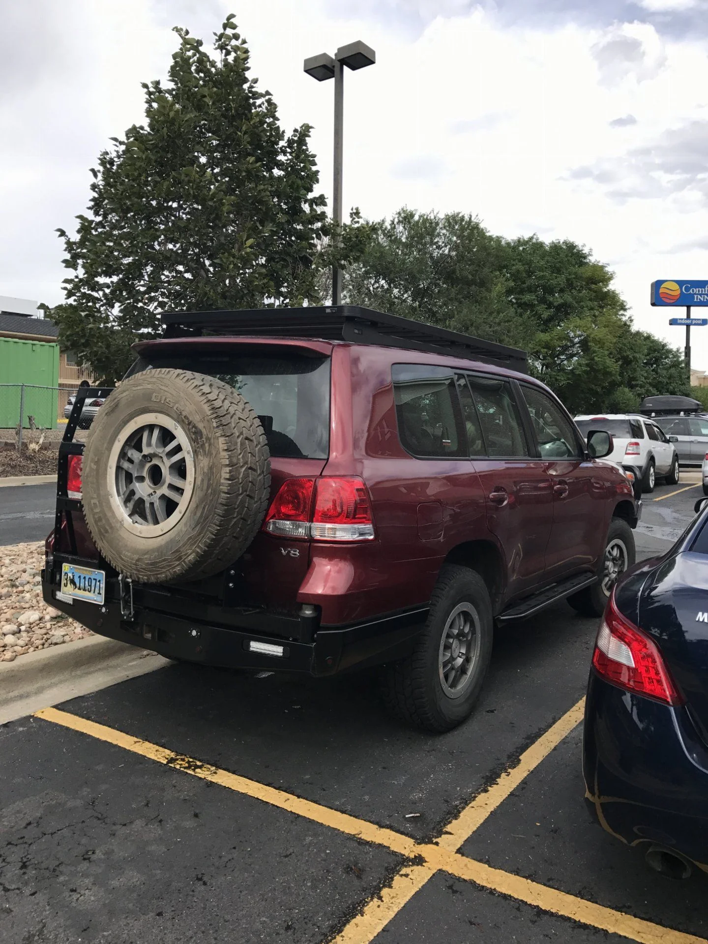

While in Denver, we stayed at a Comfort Inn, where things were very nice. We rented a car from Enterprise on Kipling. Nice folks there, very helpful. We spent Monday at the Denver Zoo, and Tuesday at IKEA and at Park Meadows Mall. Next time down to Denver, I'd like to see that Railroad Museum in Golden.
We left Slee's shop at around 4:00 pm Tuesday. Got home at around 11:00. A short trip, but nice.

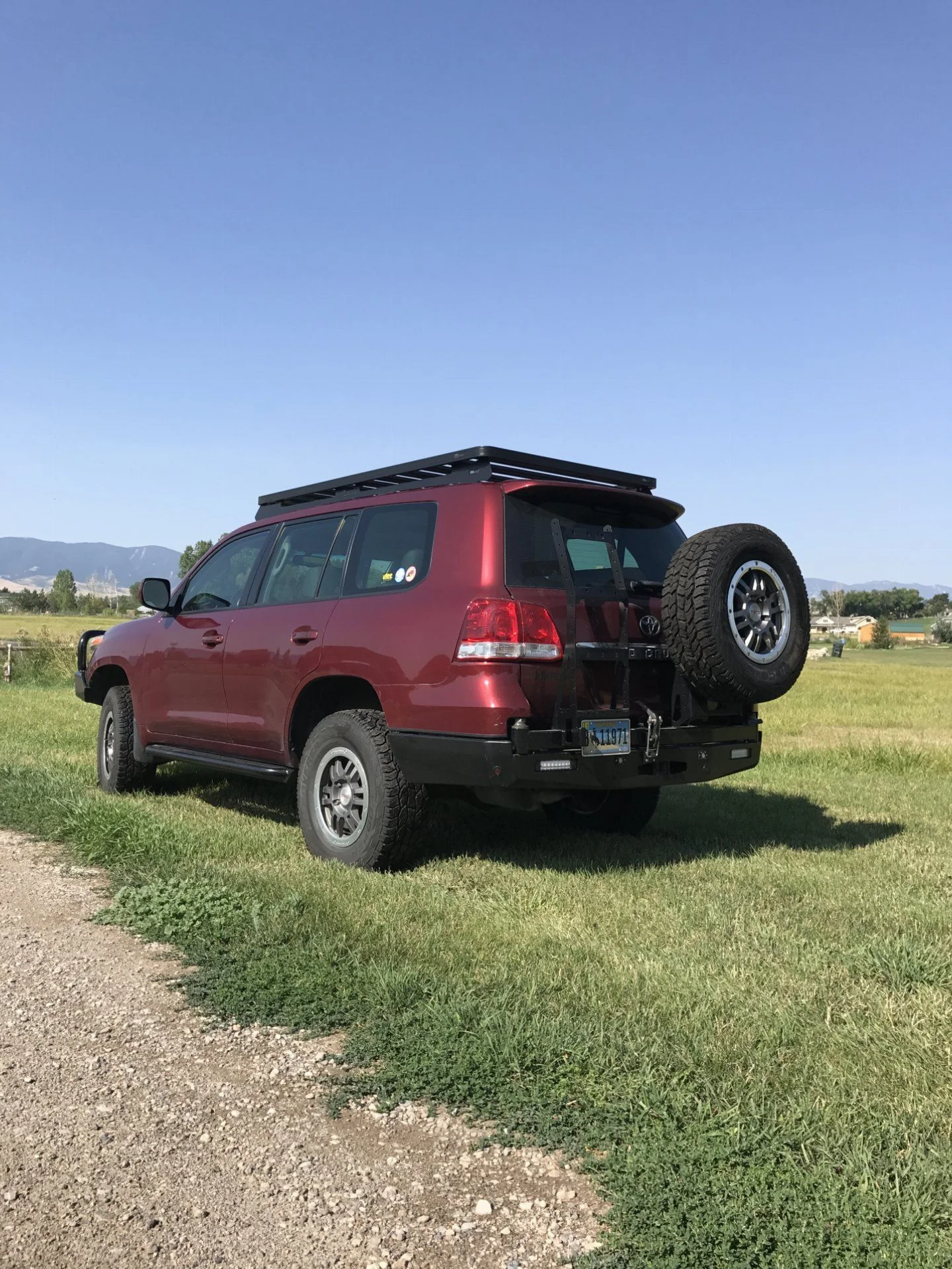

Spent a bit more time studying this rear bumper. Really nice. The best out there, in my opinion.
