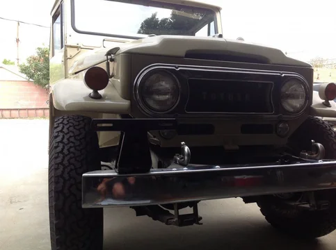

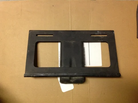

Late yesterday I started on the front of the truck, stripping down the bumper and bib to refinish. Pulled off the 1993 version of the front licence holder image.webp
Now I have a good selection of these to choose from:
Next to redo the tow hooks. The bezel and NOS clear marker lights cleaned up fine. No need to pull more of those off the shelf.
