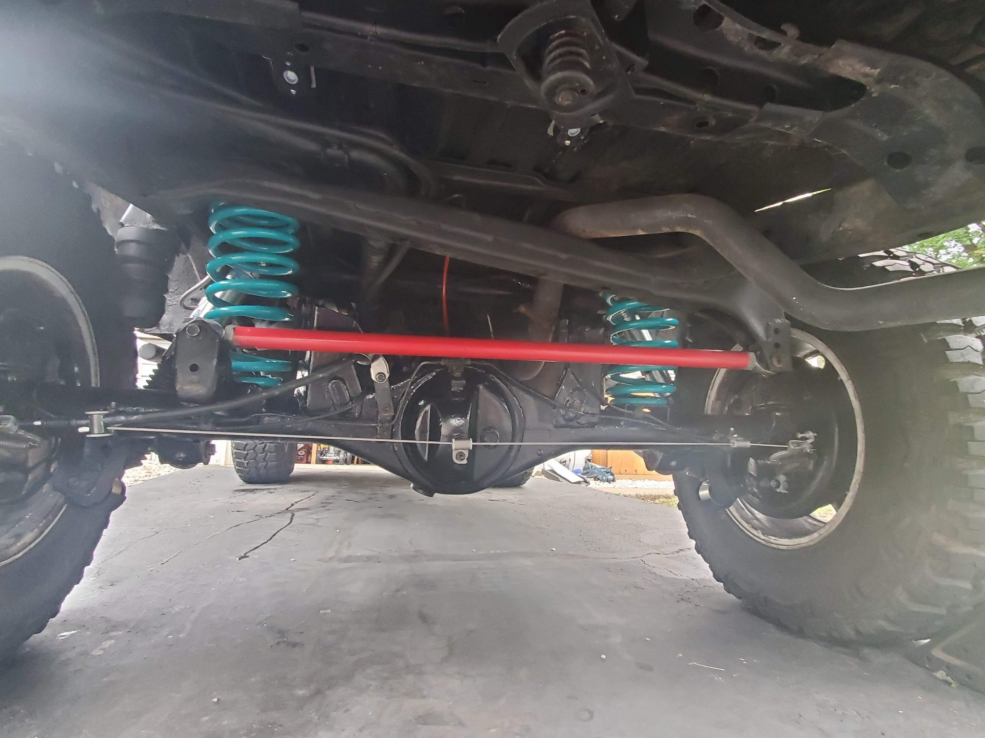

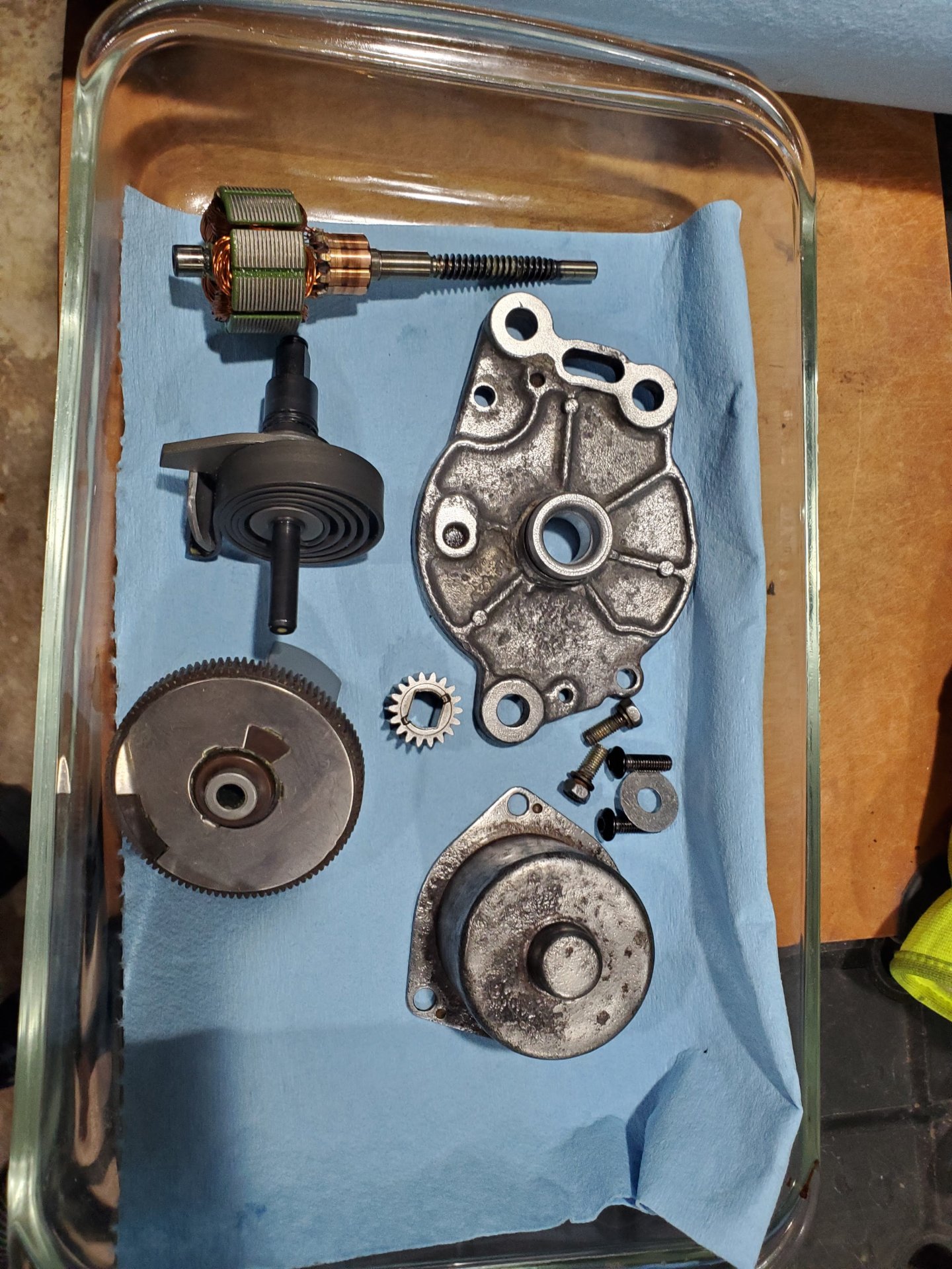

A good friend Billy another 3rd generation 4Runner owner retrofitted a non-elocker axle for me and I rebuilt a e-locker actuator for the rear differential
build.
Since I had the differential out I decided to install new seals and bearings. The rear springs are the Dobinson C59-210V used for the front LC80 suspension and the rear shocks are
Bilstein 5160 from a 4th Gen 4runner/FJ Cruiser.
Installed the 12Volt Guys e-locker wiring harness and finished the rear e-locker retrofit. The next project will be the installation of the new front diff with the Harop e-locker. Hopefully I will finish the 4runner before the end of the year.

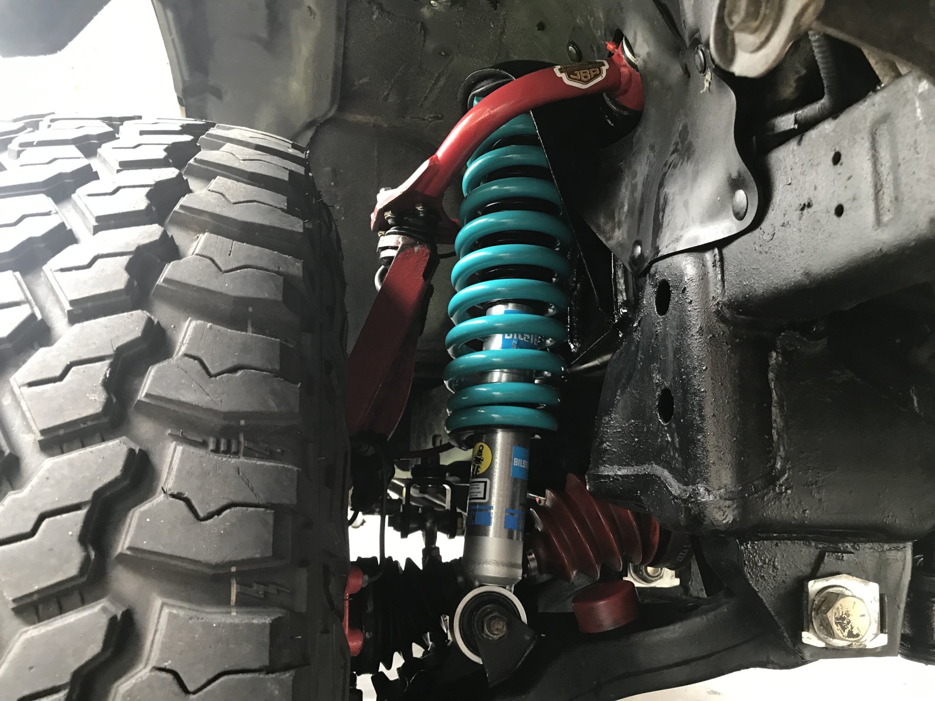

Refreshed UCA w/ new ball joints and bushings
New 5100 struts (Marketplace find) with Dobinson C59-302 springs (testing phase)
