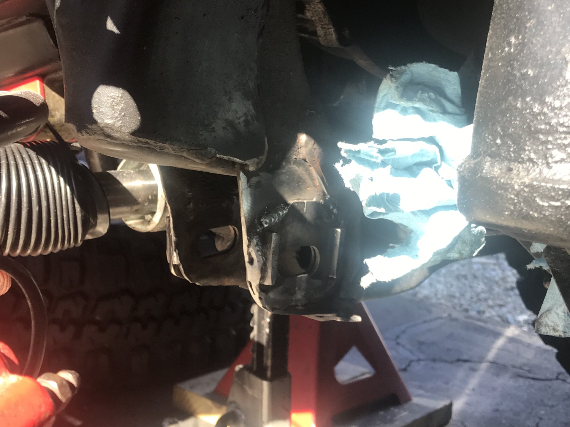

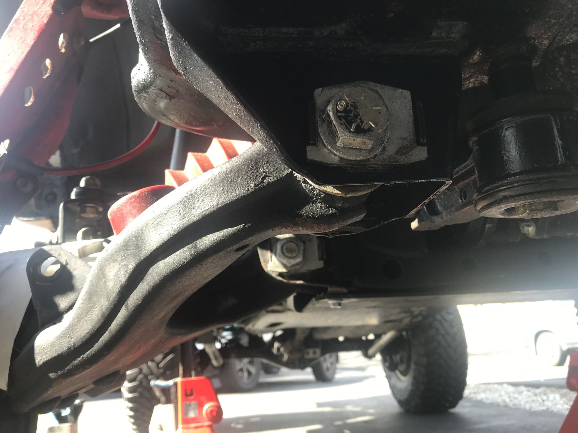

Finally found a nice set of SCS RAY10 wheels 17x9 3.5BS and -38mm offset with a set of used Toyo MT 12.5x35 R17. So finally got some time to fix the cam tabs with the Total Chaos cam tab gussets with the cam delete tabs that I have installed earlier and welded the strut mount reinforcement from Eimkeith. Next I was able to replace my old inner and outer tie rods,

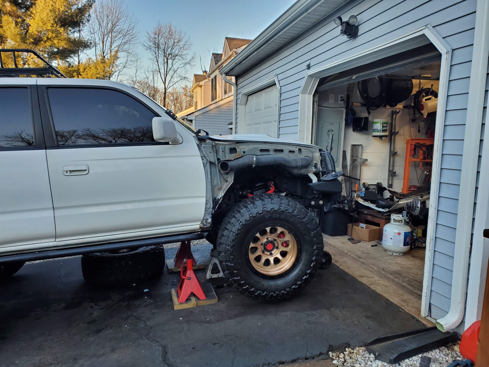

then time to tub the fender well to fit the 35s.
