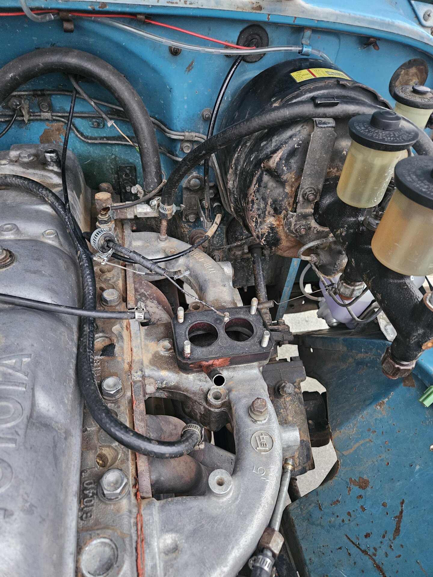

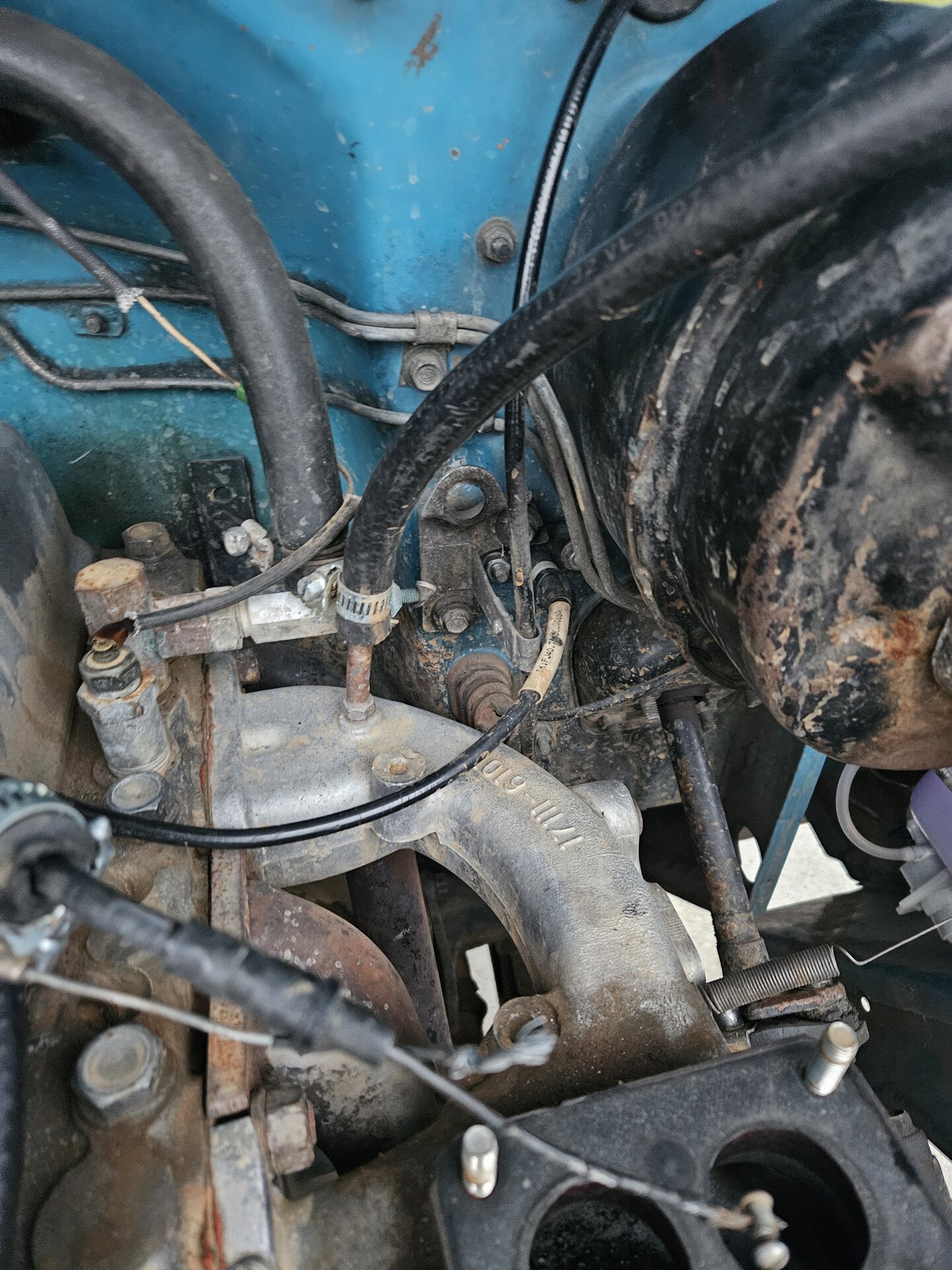

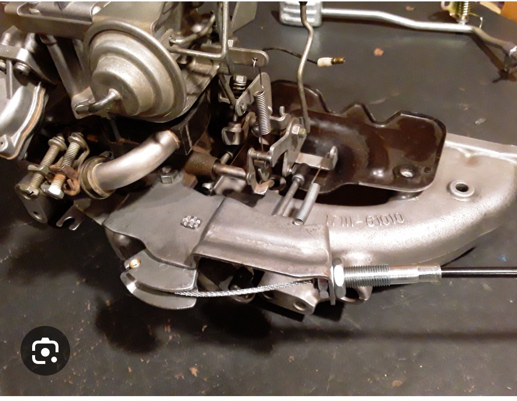

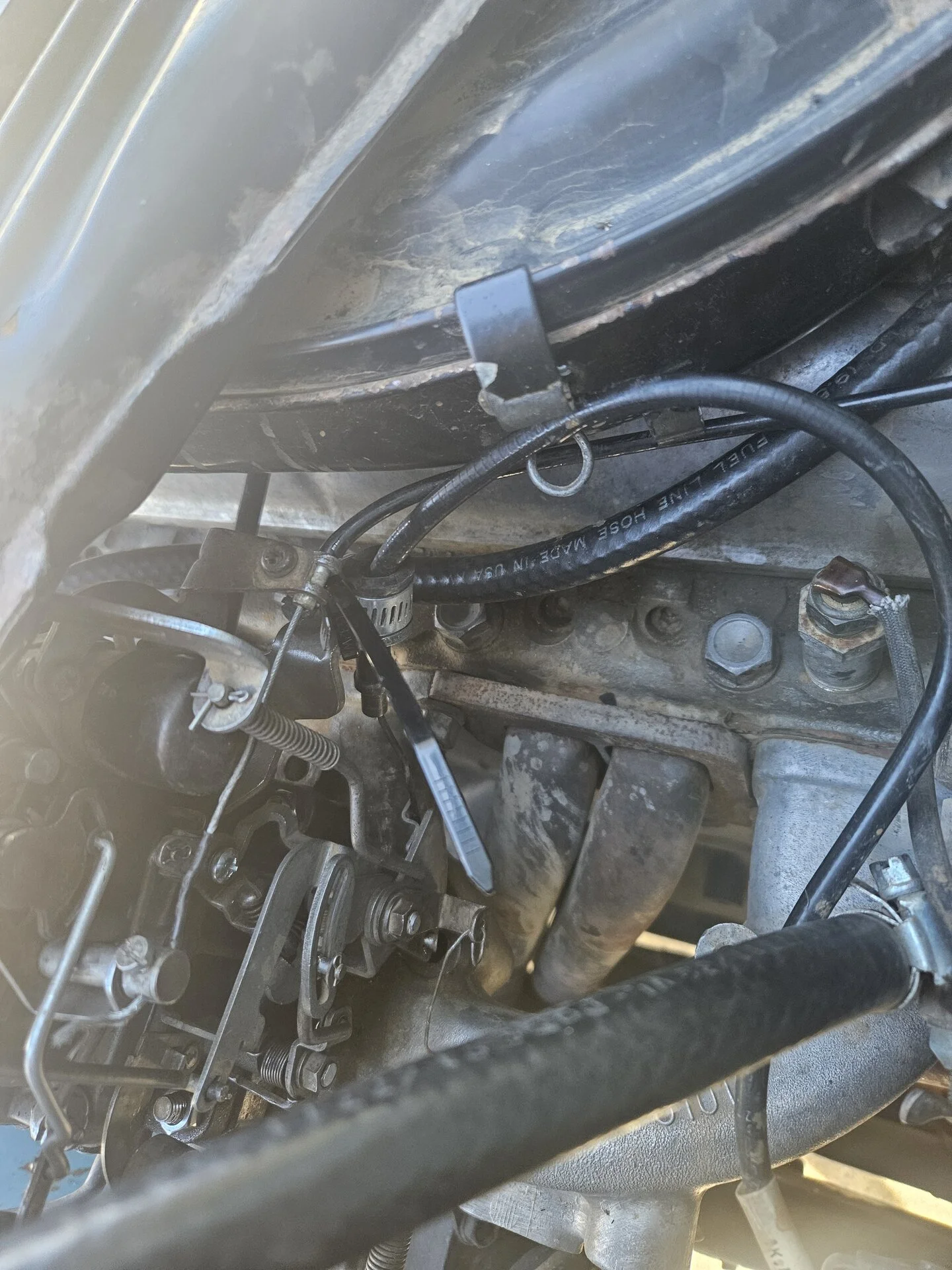

Thanks @ToyotaMatt for the advice! My rig is a 1977 fj40 body and chasis with a new to me 1986 2f engine. Here is a shot of my fire wall bracket. This is the only original linkage component left. The last pic a screen shot of the bellcrank setup I'm thinking about.
this helps alot , good job ! .... :)

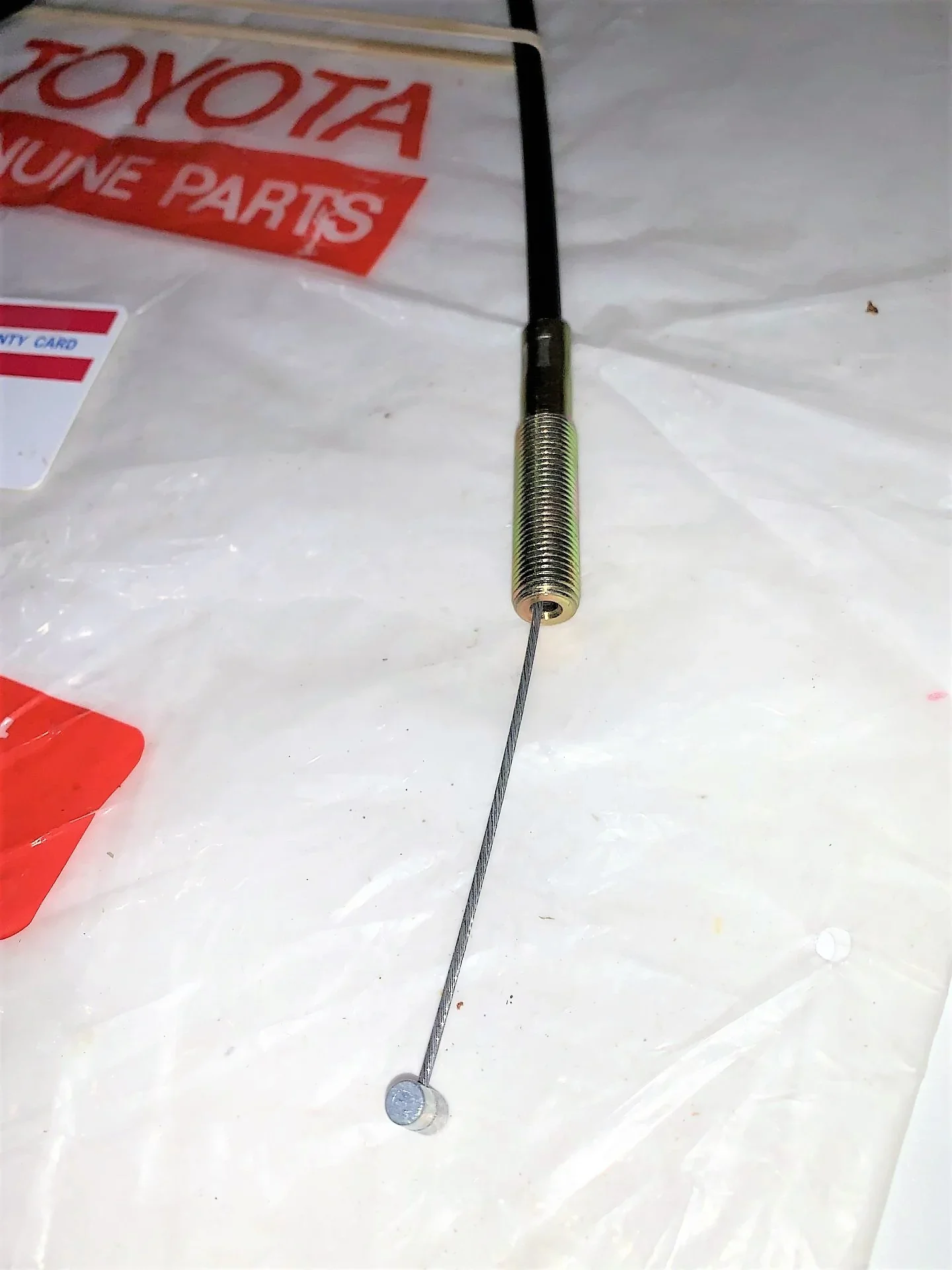

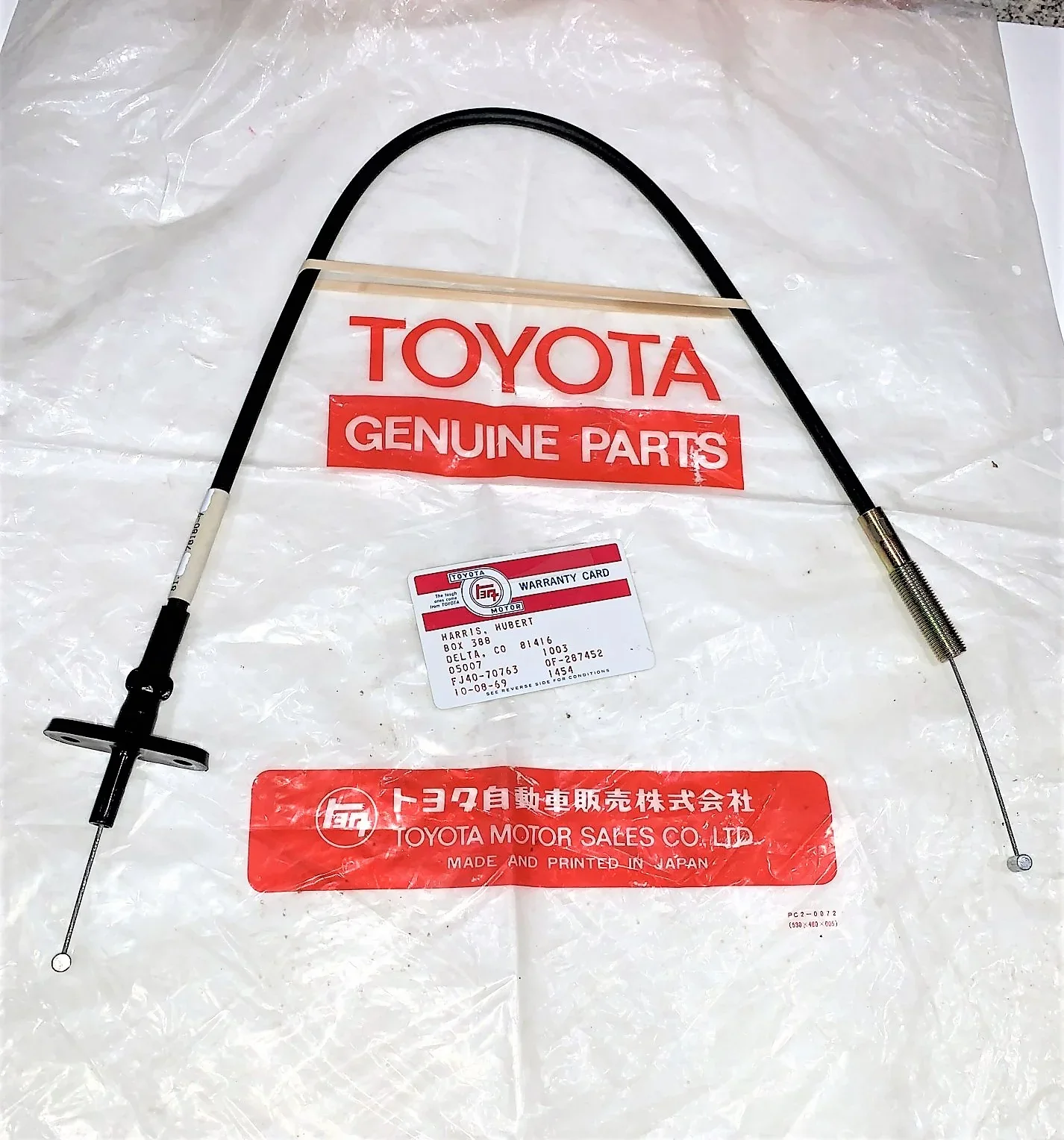

- i am not so certain that the older OEM Toyota Bell Crank set-up parts you show nicely above is somehow compatible with a aftermarket HOLLEY Carburetor ?
- i have never seen the 2 working in tandem , on any land cruiser before , but perhaps you have and can post pics of this and that together , working in a way that is possible ....?

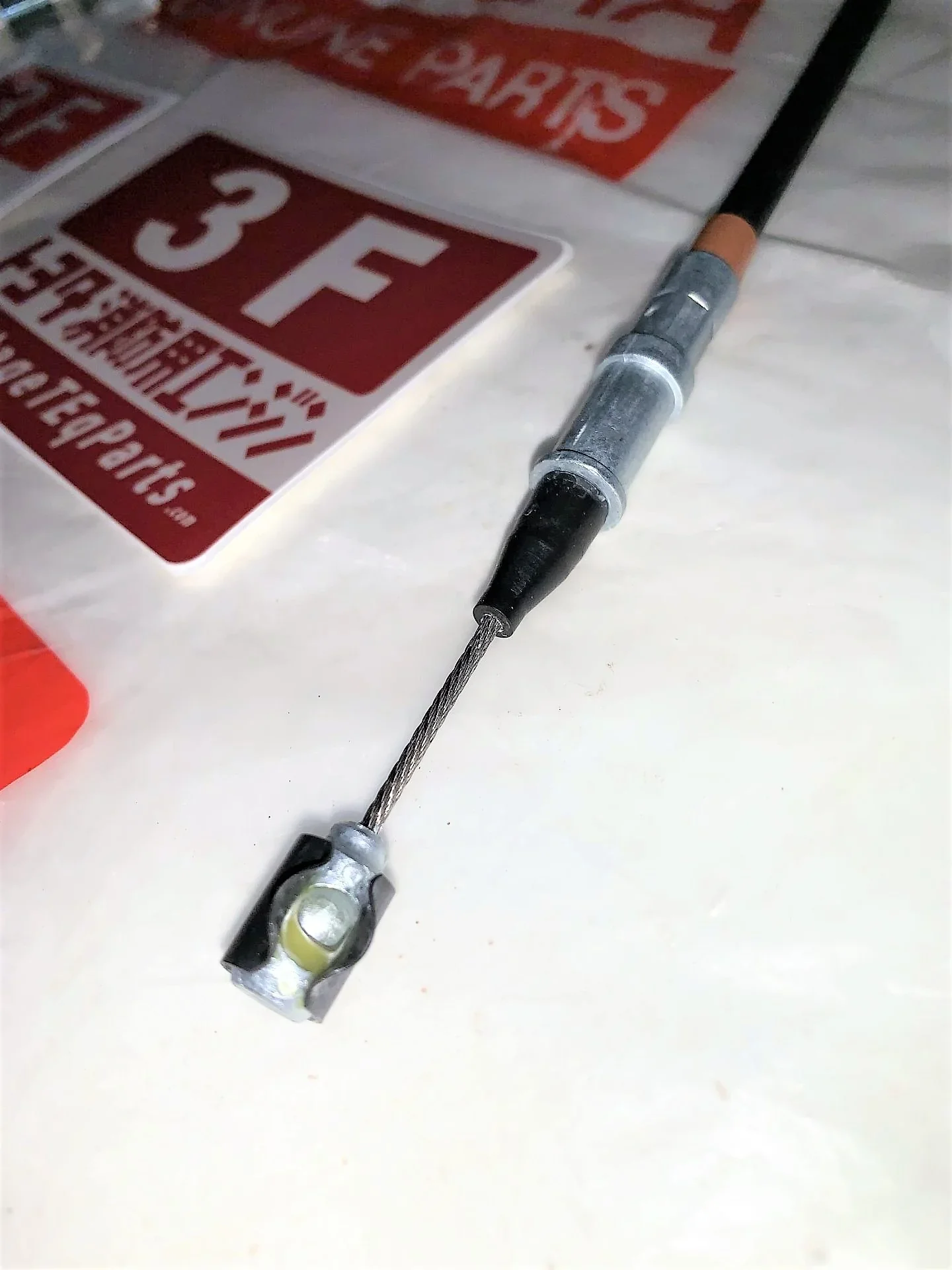

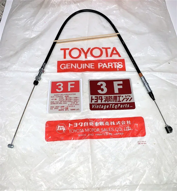

- i DO have a few ideas here to help you in this quest you are now on , one thing i can conclude 100% here is your pedal cable as it sits now above .....
- i can also say for sure the one one i show below , with a cast-on alloy barrel stop detail , is your path to stick to ,.
- some have only on one the gas pedal end only , other end is simply a bare wire end , this is NOT desirable here in any way , and the wrong parts detail....fyi
- i also suggest the 2nd HYBRID approach idea below , this gas pedal cable has the same cast-alloy barrel stop on it as the 1st one i discuss above , but has a UNIQUE female socket on the carburetor side end , this one i get told a lot by folks who i mail them out to that the female socket ball end has all sorts of good and desired various aftermarket FUEL System Accelerator hook up possibilities , including the several HOLLEY Sniper platforms now being installed on a number of TOYOTA Engines , including the 6 cylinder Land Cruiser ones ....
- i do not personally use or have ever installed a non-oem Toyota fuel system set up , i am mr. oem according to some in the Vintage TOYOTA Community ...... i am ok being called mr. oem , this is the truth more or less .. :D:wrench::wrench::wrench::wrench::wrench::wrench:
- i will PM you also , so check your in-box after you read and digest the above and below too ..
matt

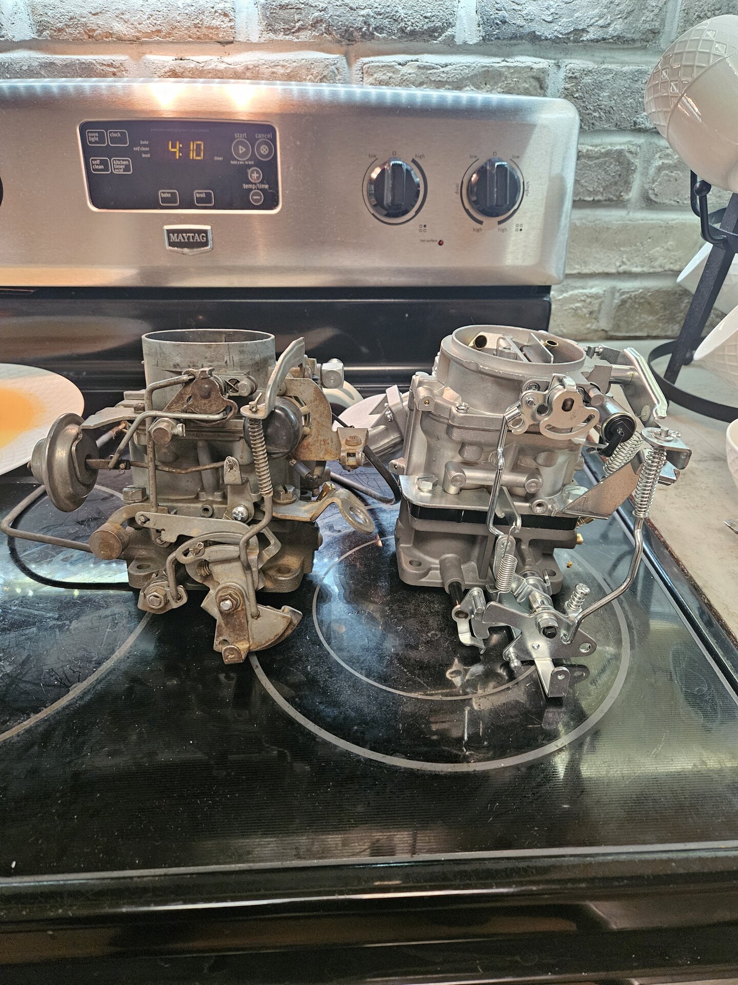

Thanks guys, to clarify a bit more, I removed the holley and purchased a Partol aftermarket carburetor to install. This is when I discovered the accelerator cable I currently have won't work.
I do not know the Partol carb at all.
It sounds like you need someone with a shedload of old parts who knows what they have and what you need for your particular mash-up. Maybe someone who's done it before. Mark A. comes to mind, perhaps @pardion .
Would recommend a correct Aisin carb of course.
Are you going to need to an earlier intake manifold too?
The Partol seems to be a Chinese replica of the oem asin. I have an oem asin from a 1971 but the accelerator cable mounting point interferes with the air filter housing. Also the choke tends to stick open due to the worn bushing I think. Here is a side by side of the 71 asin and the new Partol.
