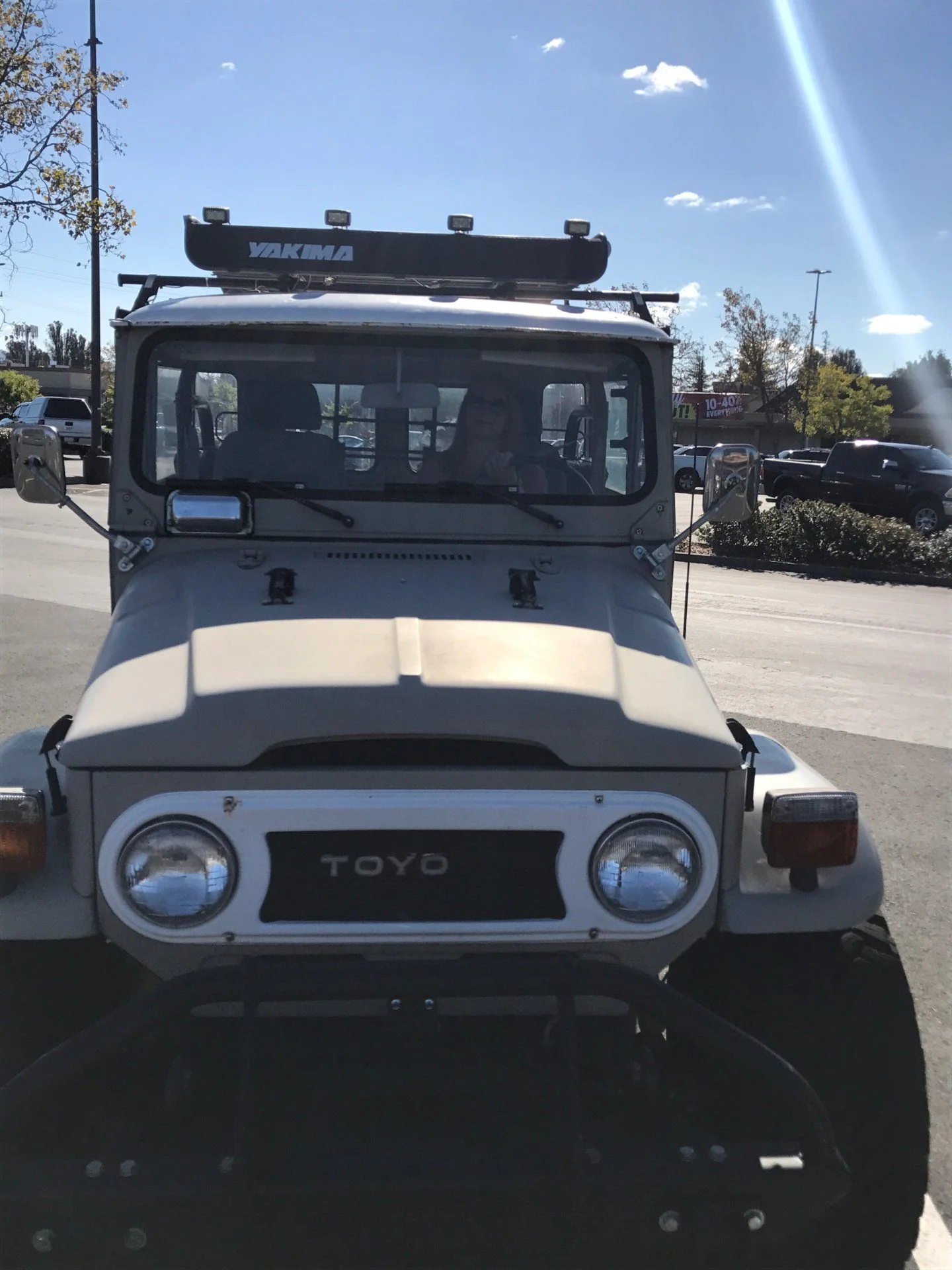

Hello Everybody,
I'm a noobie to the site, but feel like I have learned a lot so far by scoping out the existing forums. I acquired my '75 FJ40 in '04 and have to admit, I was pretty hoodwinked by the seller who claimed to sell "Fully Restored" vehicles. I ordered from him online. When I received it, it didn't even run. My bad... shame on me for being overly trusting. Over the past 15 years, as funds permitted, I have gotten it into pretty good shape with a local FJ40 specialist. Now that she is running pretty well, I am seeing surface and underbody rust show up. I'm considering having it torn down to the frame, all rust repair done, and full repaint. The goal is to make it a reliable daily driver and a fully capable outback adventure / camping rig.
I have already had the guys at Mudrak install:
-A new OME suspension with 2-3" lift done
-a new valve cover for the SBC
-Throttle body injection
-Power steering
-New seats
-long range under seat tank
-New 4-plus front and rear bumpers
-New wheels and 33's
-Air conditioning
Here are a few questions:
Should I keep the throttle body injected Chevy V8 (that is running well but gets about 10 MPG) or go back
to a 2F with a carb.
- Does anybody know what a frame off resto-mod would cost? Ballpark?
- I'm considering doing it myself, since I have already spent MORE THAN the original cost of the
vehicle (with I am embarrassed to say) in repairs / mods.
thanks in advance for any thoughts or suggestions?

By the way - good looking FJ40.

That said, removing the roof rack is probably good for 1~2mpg. I put a rack/fairing on my TDI jetta and dropped 5mpg. Under 40mph, you probably won't much of a difference, but hwy speeds you'll notice it. 10mpg seems low, but you will probably top out at 15ish.
