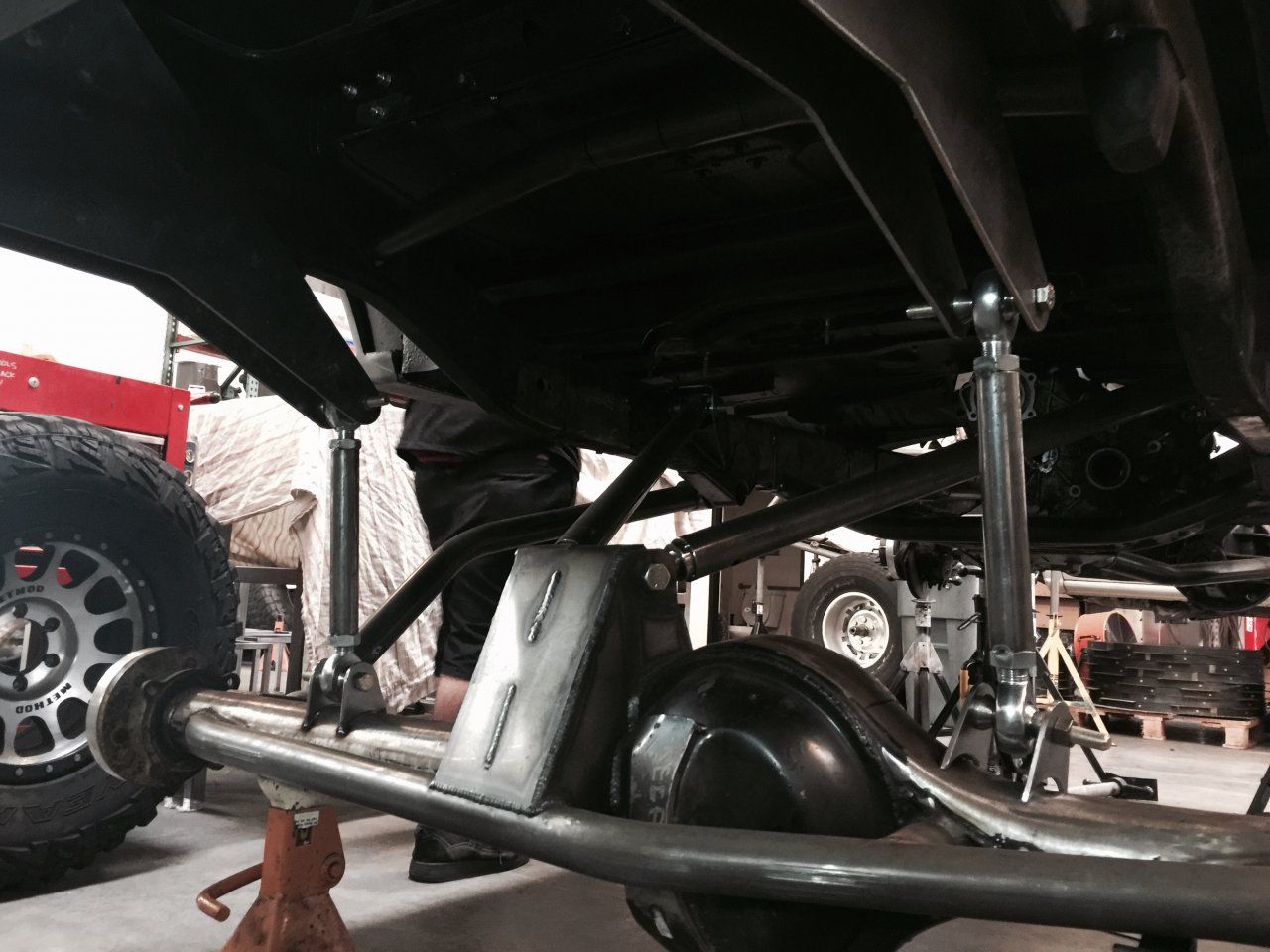

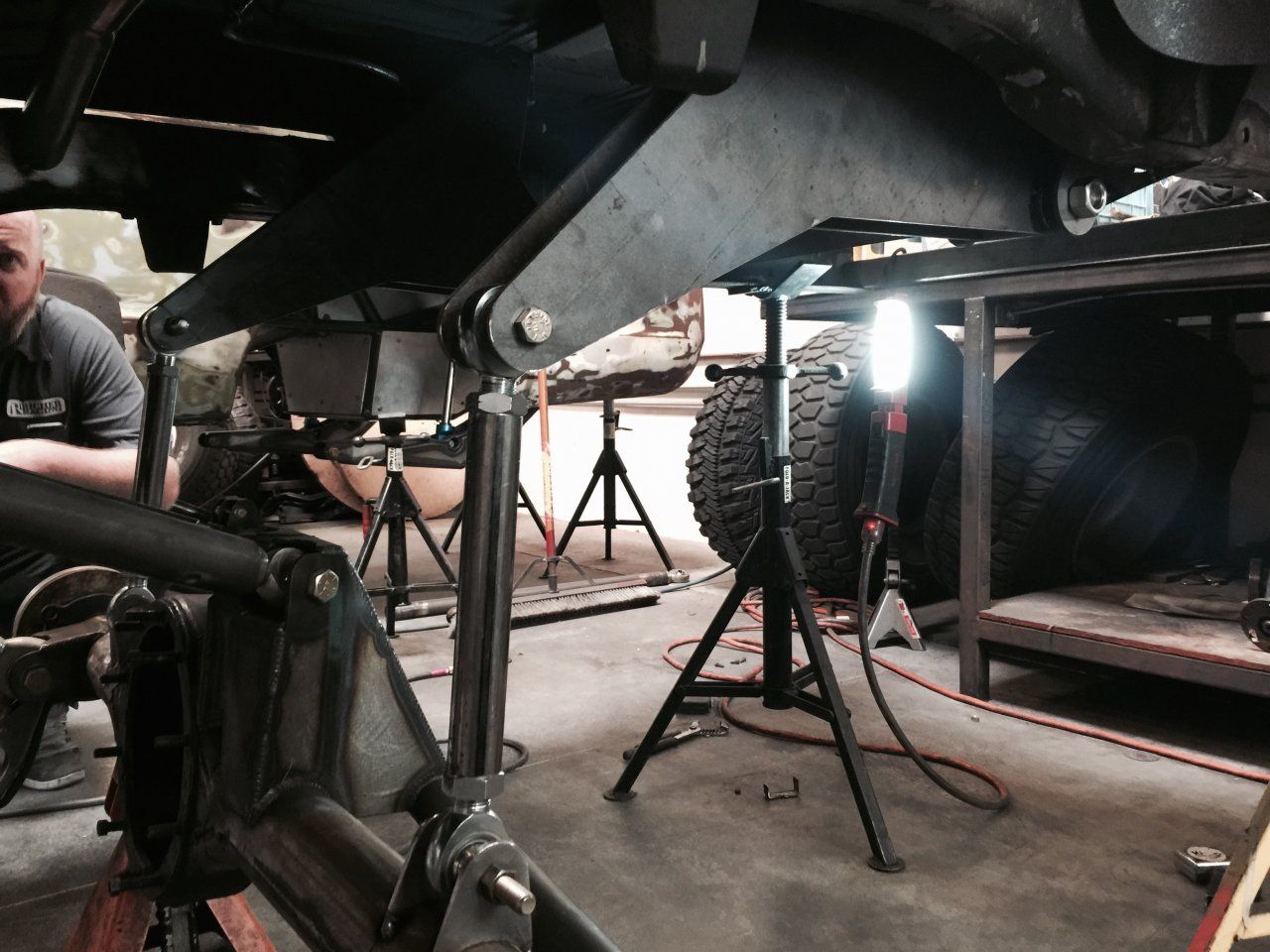

Rear Cantilever mockup started. I'll be using a 10" shock to get about 16" of travel. Once this is done, we'll have to built a funky shaped fuel cell to fit in the remaining space back here. Looking like it'll work slick. Stay tuned.
At last some more pics!
I still wanna come down and check that thing out as it does it's first run! Maybe I'll have that tranny you hooked me up with done by then. What a progression-three different rear ends?
Decided to remove the frame the last 18" and build a new crossmember at the link mount and tube/box in the rest. It'll make building he rear bumper more integrated...
