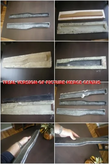

Troll-I have these drawings of door pillar.I'm making a pair for myself molded w/ with epoxy,glass cloth and 1" pipe that runs the full length. The canvas channel will bolt on through the casting.I'm making the plug for the mold on a cnc router @work. I cant determine the positioning of the canvas channel .I have found every image I could on MUD,and just cant get a definative position.Can anyone verify if I have it right? I also am not certain of the orientation of the slot in the canvas welt channel. I have measured my existing hard top pillar and think my dimensions are good.I checked the verticle curve with a template and it lines up. Any input or correction would be welcome!

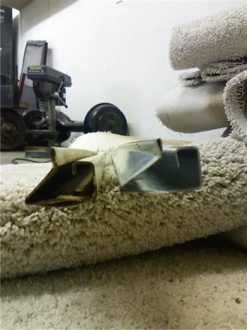

Need dimensioning of frame over door
hiyas- I am having trouble making the frame over the doors.I have found enough information to make all the other components,but i need clear dimensioning on the horizontal pieceover the doors. I found this fj%20window%20channels.webppicture,but it has no dimensions.Also,I have seen other pics showing a second part that bolts to the pictured track,much like the one for a hard top.Can anyone provide those dimensions and a picture of the other part,showing their relationship? Here are a few pics of the b pillar fabrication.combined pics.webpThe parts look chalky,they have yet to be sanded,filled,etc. Thanks to all- Paul

Thanks- Anyone out there have this piece? Anyone know where I can get one?
