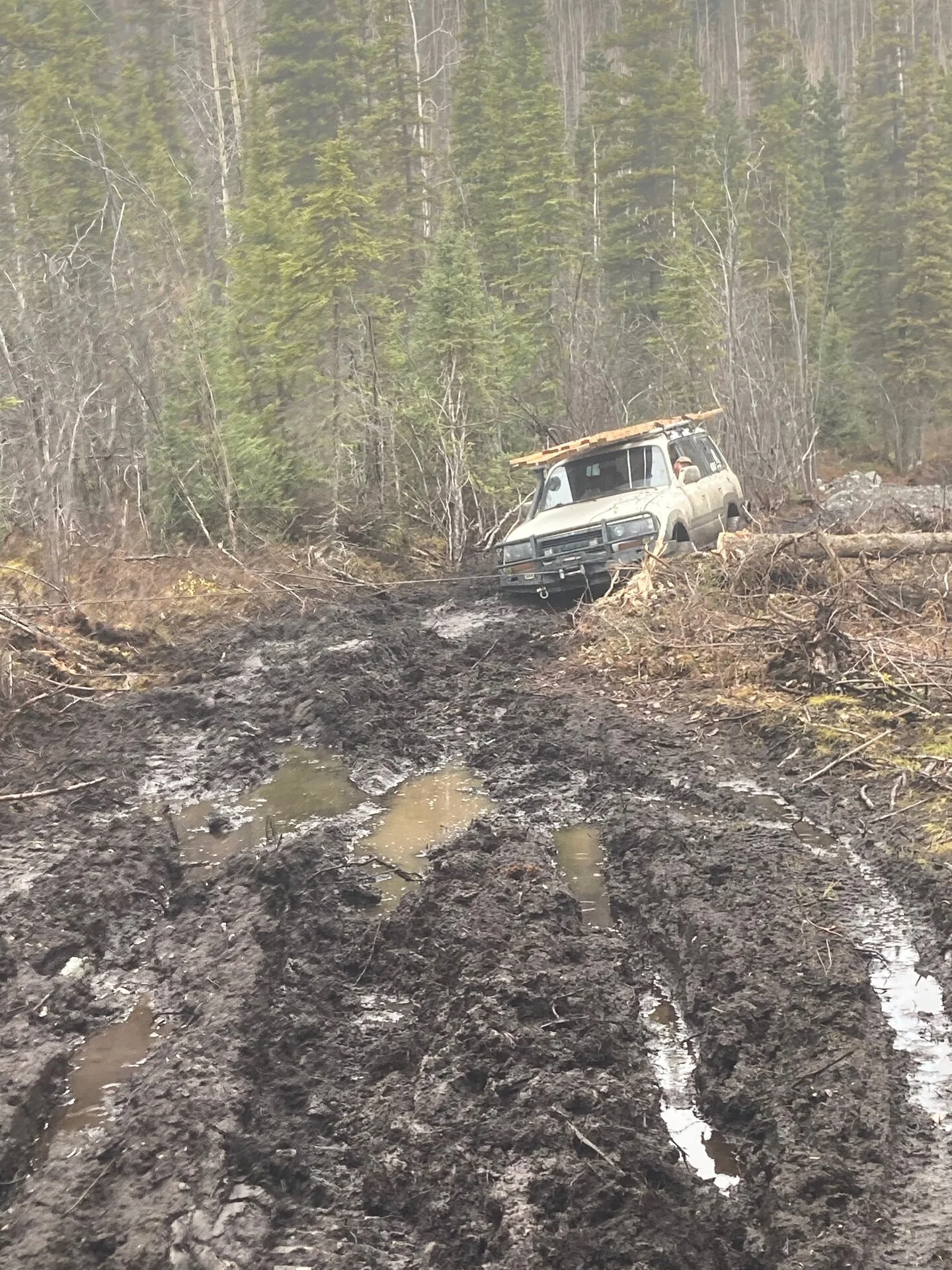

Since such a long post without a pic should be a crime, here's a pic of hauling supplies to build our house.
