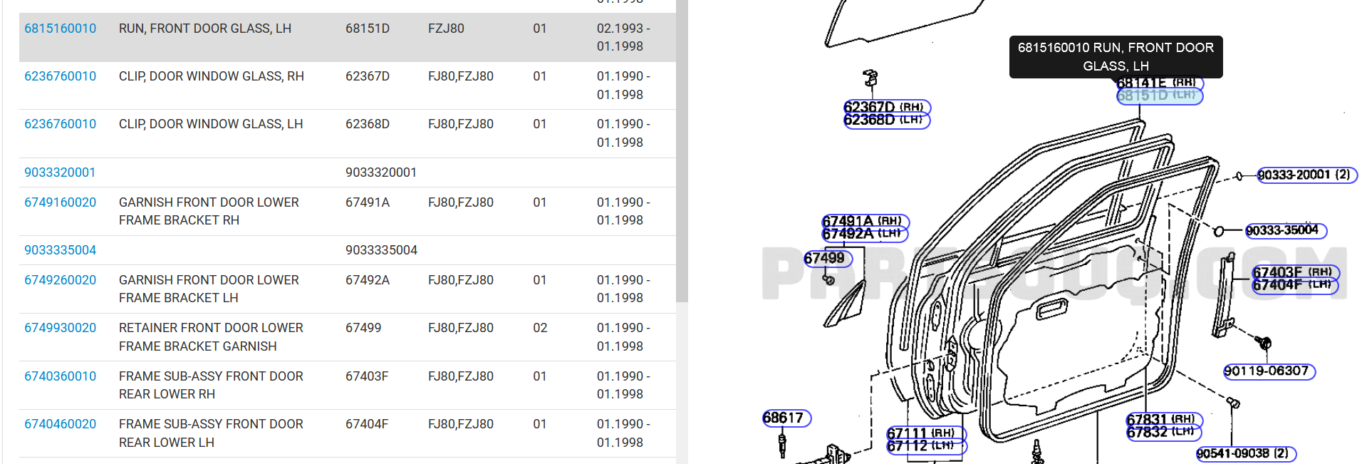

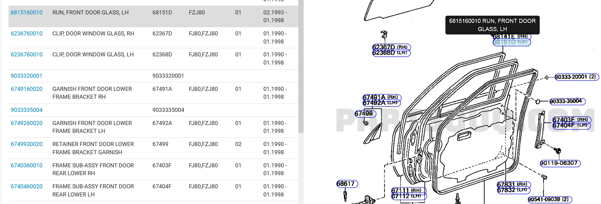

Which windows? FWIW, there are no "guides". The parts are listed as door glass run; for example the driver's side front door is:
These are Toyota parts. You can buy them from your local dealer, an online discount dealer such as Ourisman in Richmond, VA (which sells at discount), from overseas parts sellers (PartSouq, Amayama, etc.).
