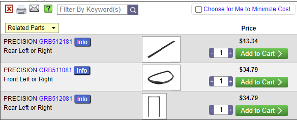

Rock Auto has the Precision stuff which in nice quality. They also have all the door seals if needed:
