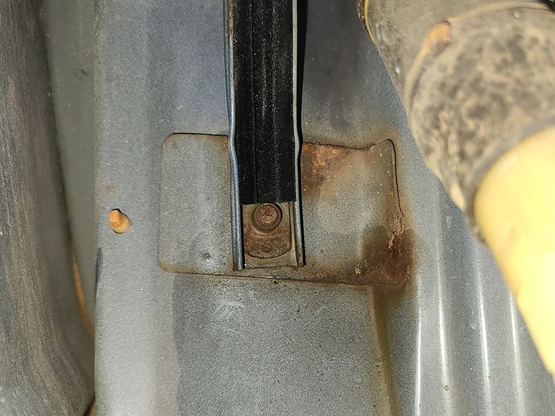

The rear portion end rests against the bolt hole in the removable portion of metal track:
The front section has a stop tab formed into the metal. Having the run long enough to rest against these will also help prevent it from slipping out of place if you roll down a wet window.

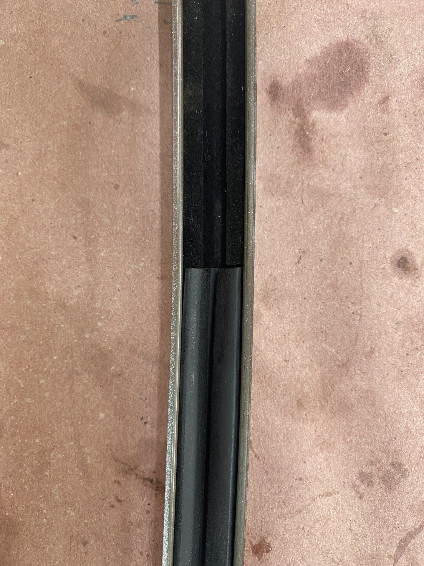

Taking the door apart today so I snagged some pictures of the old versus the new stuff. So you guys tell me if I got something different
packaging for the new stuff
The flocked stuff is the right choice
