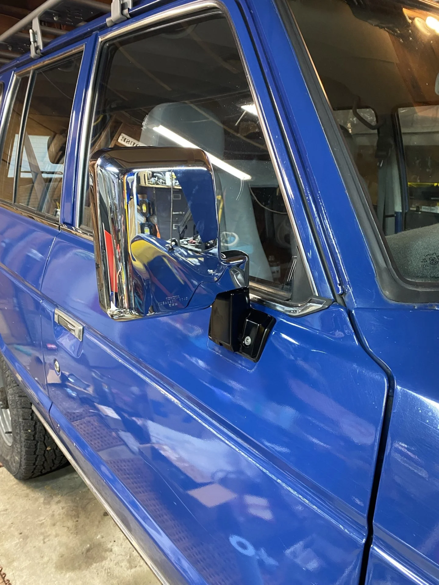

In case anyone is interested. The OEM ones I put on my rig are 87910-60460 and 87940-60420

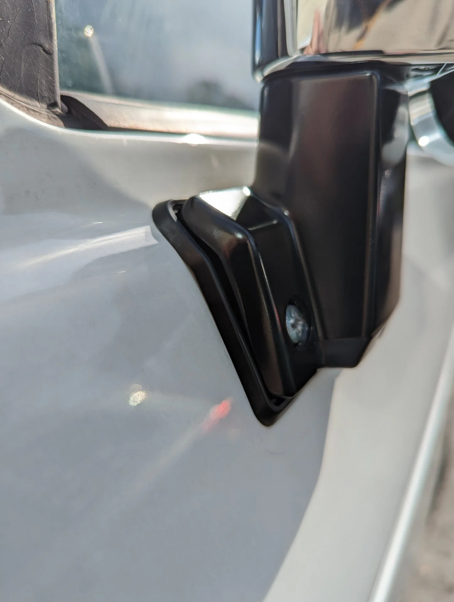

I already had manual-style FJ70's mirrors on her, so I already knew about the gaps, here are what the gaps look like up close:
What‘s your opinion concerning the possibility of water leakage/infiltration? Any idea as to what product might be used to fill those gaps and still maintain a practical watertight yet esthetic appearance while still realizing there is no downward sealing pressure on the pad to vehicle surface from the above mirror bracket at the point of the gap?
I noticed the term “foam“ used in a previous post in this thread as a possible solution!?!?
I cut a piece of EPDM foam. Nice seal.
