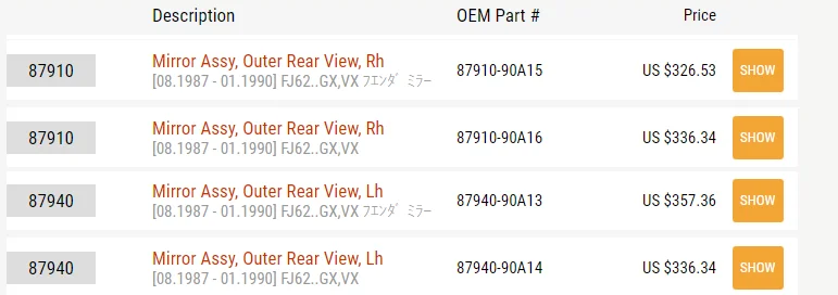

Here is a link - Mirror for Toyota Land Cruiser 60, 7 generation, 2 restyling 08.1987 - 09.1989 - Toyota Car and Auto Spare Parts - Genuine Online Car Parts Catalogue - Amayama - https://www.amayama.com/en/catalogs/toyota/land-cruiser/7-suv-right-60-1987-r-2795/electrics-4/mirror-394, however, I have run into them listing a part, ordering it and they come back with 'so sorry, not available'. I can't find a cross reference between the last couple of digits of the mirrors they show on the electric page and PartSouq's numbers.

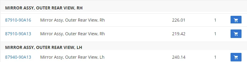

Here is another option I just found - if it is available - they call it an actuator, but its the power unit.

Are any of these the correct or functional OEM power mirror replacements for an FJ62? I think I am looking for the following but have learned just enough about chasing Toyota part #s to question myself:
Driver (LH): 87940-90A15
Passenger (RH): 87910-90A20
Which part(s) are incorrect?

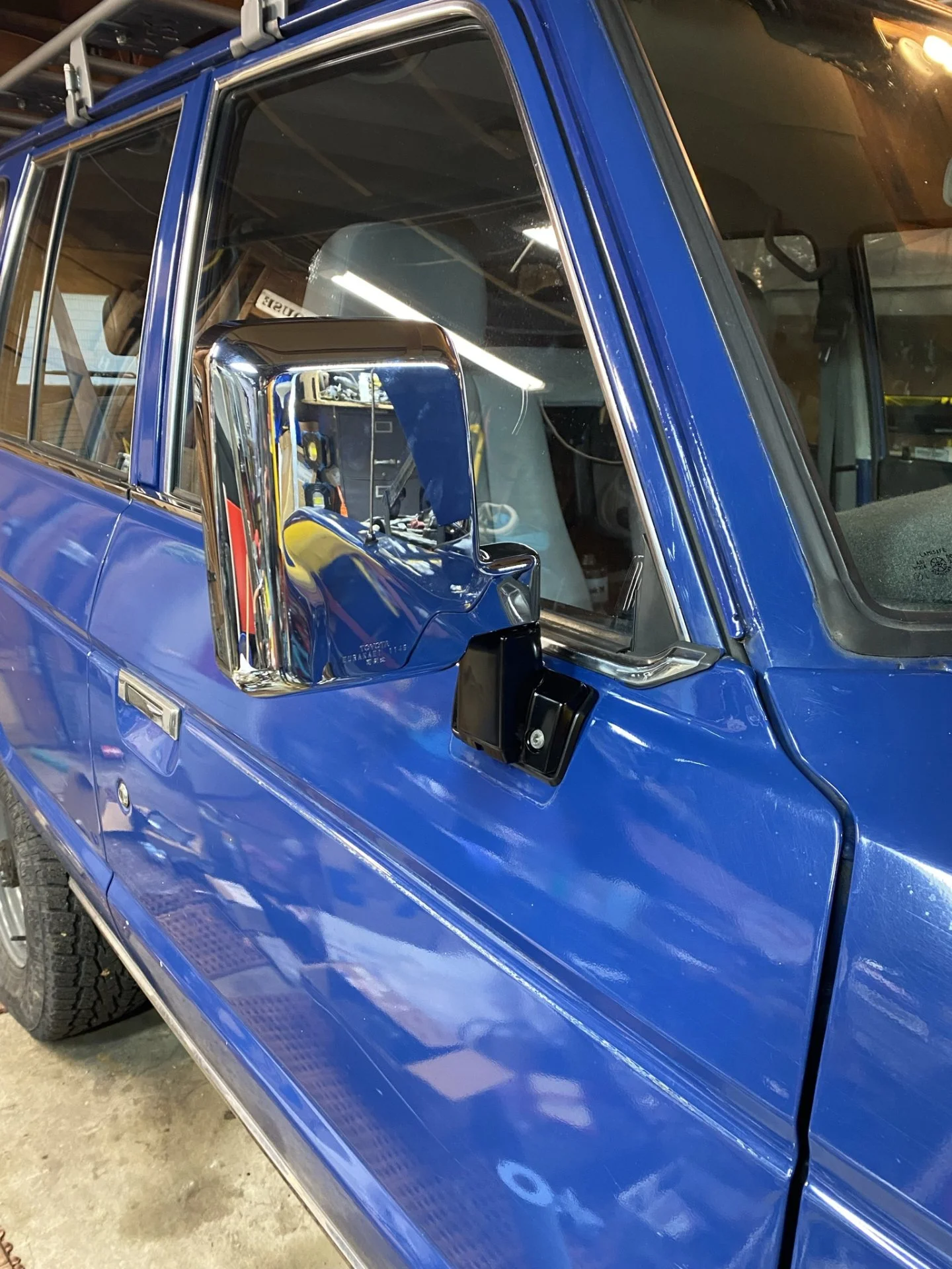

70 power mirrors. Smaller base and have a small gap to fill but the style is the exact same. I’m happy.
If your bases are good, you may be able to even just swap the top chrome part onto the 60 base.

My rig was repainted at some point in its past… and they didn’t do the best job so I wasn’t surprised you can see the paint outline around the mirror. Hahaha. I don’t even notice it anymore. I do notice how nice and clear the mirrors are though :D
