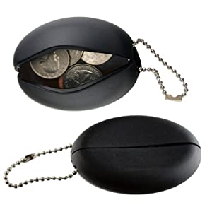

I had same issue with my Avalon and slipped it in one of these till I resolved
