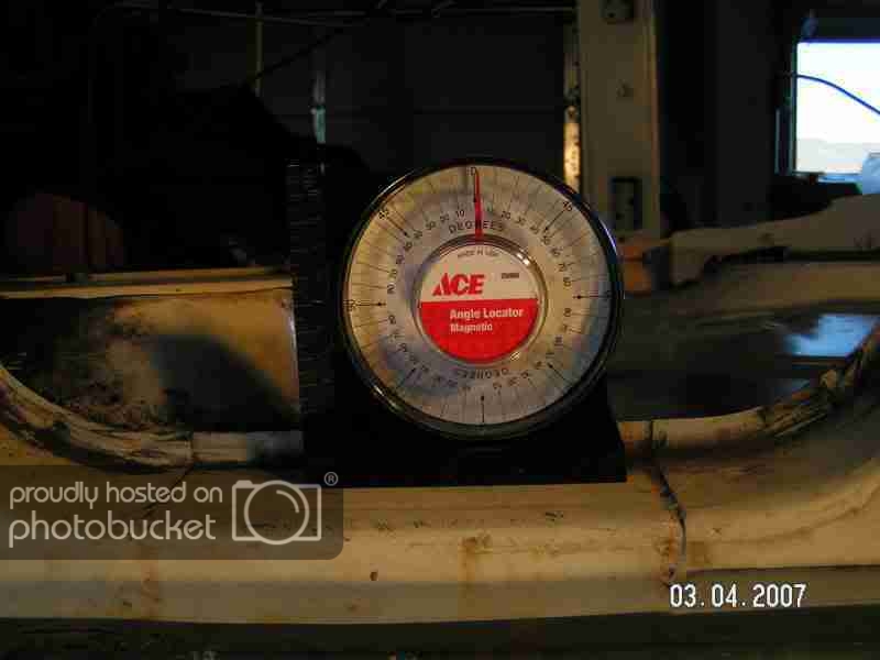

Heather at first I thought maybe your vehicle was bent. Because I thought why would Toyota put a bend there. But just walked out with a flat edge and a tape measure. I concur on your measurements and there is a bend. Wierd. I wouldn't have believed it unless I'd seen it myself.
Okay. I got out the angle finder, heres what I got.
Starting at the door sill to get a zero mark of +1 degree fore and aft.
Moving inward to the outer side of the first set of bead rolls I got +7degrees
Further in to the inner side of the first set of bead rolls I got +8degrees
Keep going in, to outer side of second set of bead rolls, still at +8degrees.
Keep going to inner side of second set of bead rolls, again +8degrees.
Moving towards the front of the truck to get the deflection angle from above the bend. +1degree
Back down to the outer side of the third and innermost set of bead rolls I got +9degrees.
To the center line of the lowest part of the floor pan, +8degrees.
Back down the centerline for the rear seat platform angle, -32degrees
Forward to the rear heater platform. +30degrees.
Now, Checking left to right angle for a zero measurement, +1 degree
Off the rear heater platform, angle is -1 degree
And next to the seat pedestal I show - 2degrees
Hope that helps
I think that helps A LOT! I underestimated the bend, I see. I don't have one of those fancy ACE angle finder thingy-majingies, but I was going to whip out some fancy algebra to calculate those measurements. I am glad you beat me to it, cause I am sure it would have taken way to long to cyper all that stuff. Thanks!

I just noticed something....I took measurements off the 78, which has the rear heater platform dead center. Both Heather's and K9s appear to have the rear heater offset to the drivers side, and has two triangular tabs on the passenger side that the 78 does not have. This might make my measurements inaccurate.:confused:
ps fancy angle finder thingy I got for $13.00 at a local hardware store.
