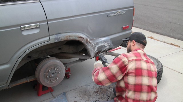

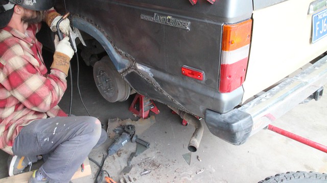

As for getting work done, well getting there as I get time. Weekends have had other obligations so I am throwing down welds and working body panels as I get time/availability. Threw on the first bit of primer last night on the drivers side rear quarter where I had previously done some work.
Untitled by Greg Fisicaro, on Flickr
What it was covering up that had only been rattle canned over...
IMG_2638 by Greg Fisicaro, on Flickr
IMG_2645 by Greg Fisicaro, on Flickr
