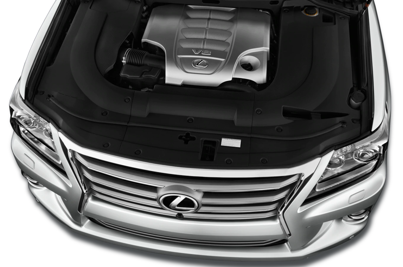

I just picked up a 2014 LX570 for my wife, and the engine covers drive me nuts. It surely makes checking fluids a chore. Is there any good reason to leave them in place? Otherwise, they're coming off.

The integrated forward part of the covers is important to maximizing radiator performance. It won't make a difference until it makes a difference In towing or low speed crawling, to keep the engine from overheating. In towing, it forces the air through rather than up and over. In crawling, it keeps hot underhood air rom recirculating over the radiator.
I cut mine to improve access, while keeping the important forward part.
I’ll second @TeCKis300 on this. The rear parts aren’t important for function, but the parts over the core support will matter exactly when you need things to go well.. when you are really pushing the cooling system.

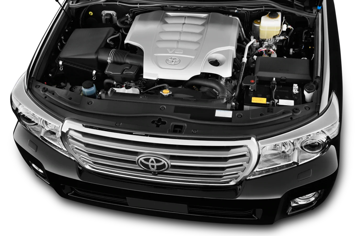

Personally, I’d just have a look under a 200 hood…and find a way to remove anything you’ve got that was deemed unnecessary by Toyota. There is no way in heck the 200 is “heat handicapped” compared to the same-engine LX…so let that be your guide.
No one said it is.. Most every car has some version of a baffle to the upper radiator bracket including the LC. It's just integrated into the larger cover on the LX.
I would love the part number on this baffle.
I'm 99% sure it won't fit the LX. The profiles are different. If you look at the hood latch as a reference, the LX grill is further forward.
