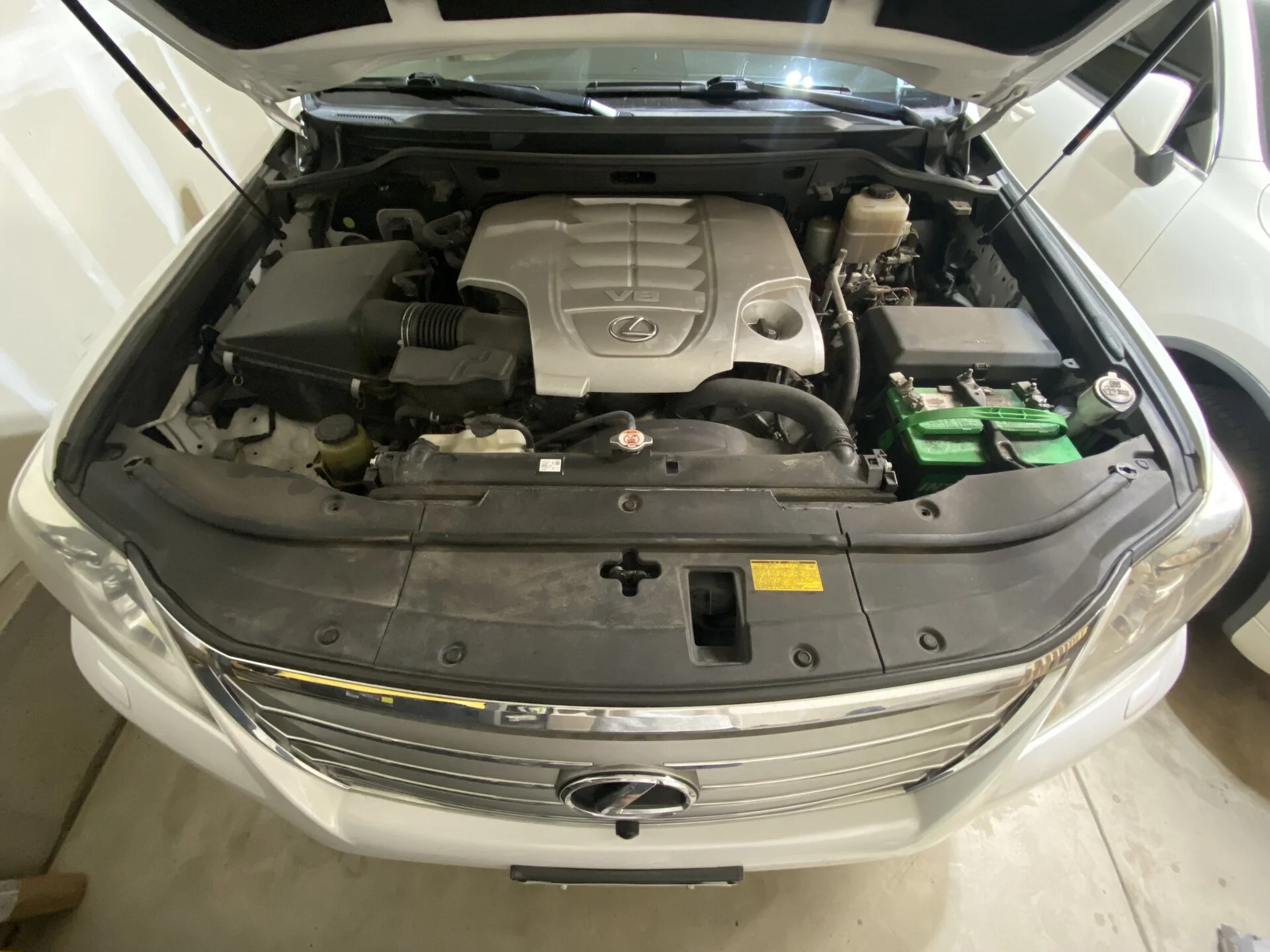

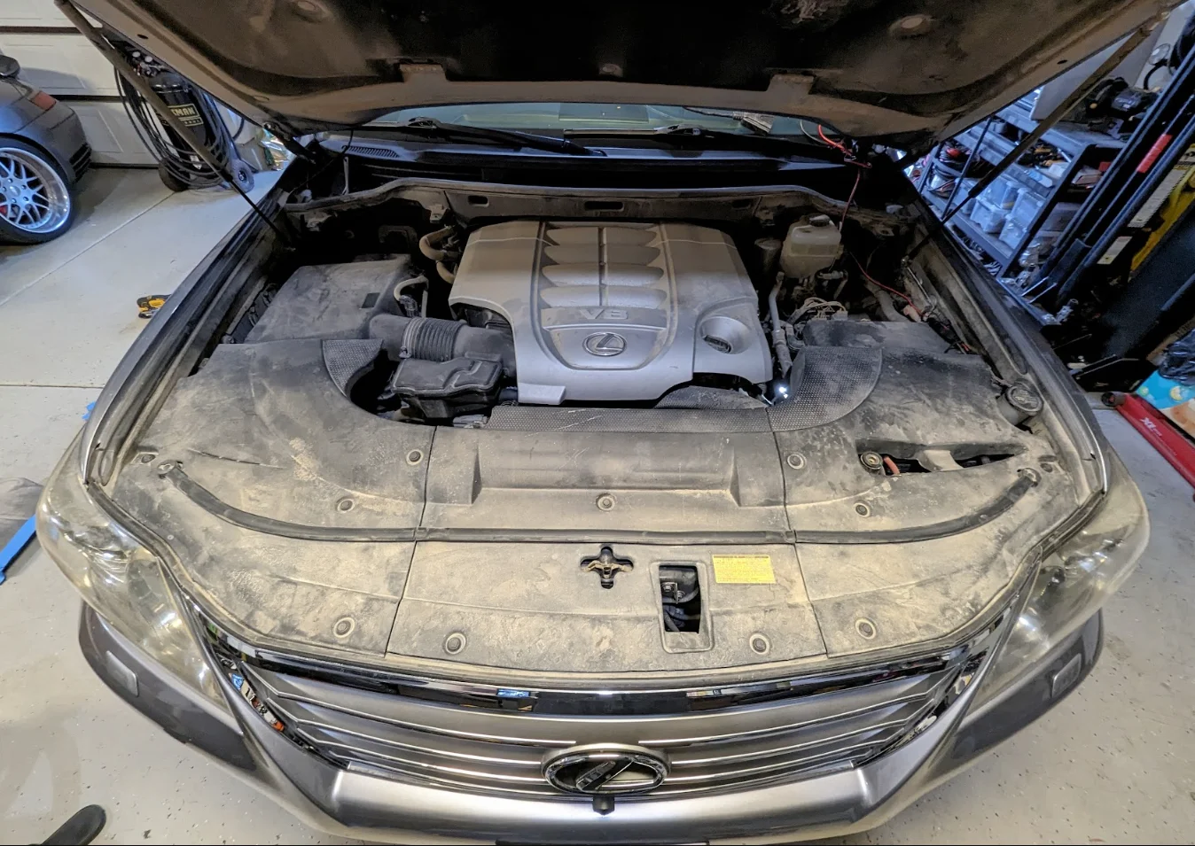

I've been hesitant to cut the LX engine covers but I'm often changing or exchanging the air filters. Wanted to pull together a thread to see how people might be cutting them for best function vs aesthetics.
For those that may not know, it's pretty important to keep the section of the covers ahead of the radiator to manage airflow. For when at a stop or low speeds, the radiator fan is not circulating hot air from the engine bay and is pulling in cool air from ahead of the grill. At speed, to force cool air through the radiator rather than over it. Sure, people may say it's not a problem but some margin of cooling is surely lost, and it's not a problem, until it is.
I'm in the desert southwest and the amount of dirt and silt in the filter after a trip is absurd so I'm looking for better access to it. I usually keep a "street" and "offroad" filter, exchanging the offroad one prior to trips. I'll then pull it after a run to tap and blow out all the dirt, and exchange it back for my clean street filter. I'll use the offroad filter for a few trips before buying a new one.

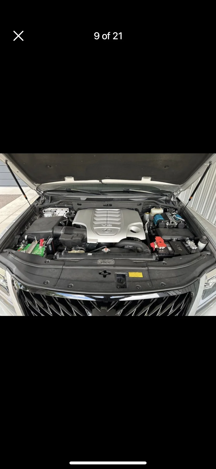

Example cut that got me to do mine.

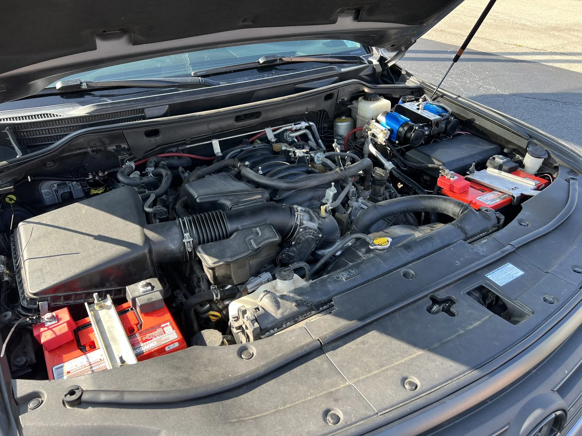

Here's mine and I can reach the filter now. I'm thinking to cut a bit more but okay with it for now.

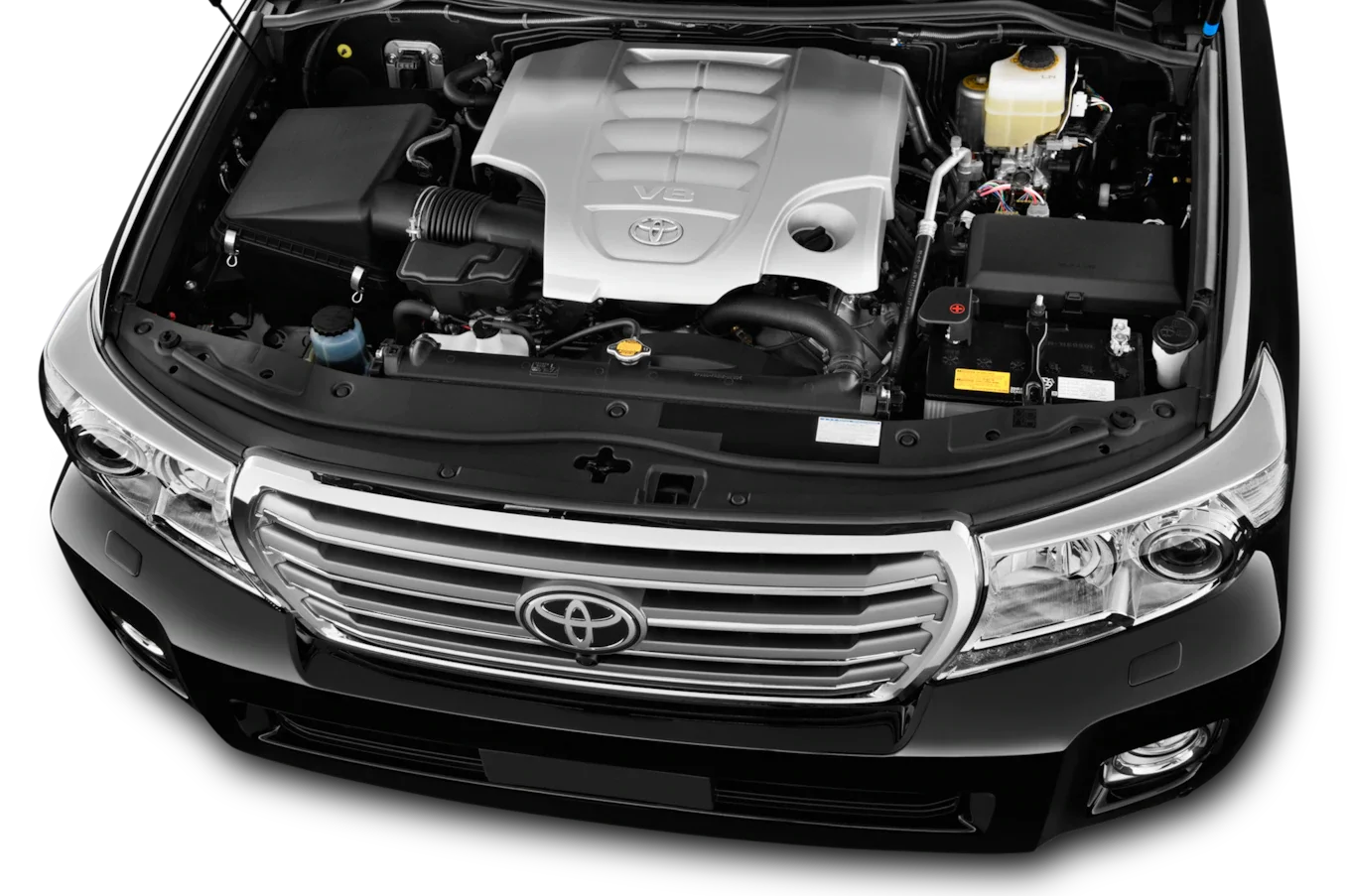

Just remove them and/or cut them down to the LC version (or just swap out the LC versions). I really do not think the LX versions do anything more functional than the LC ones. If they had any meaningful impact on air flow Toyota would have put them on the LC too.
I agree in principle but the design of the LX covers with some vent holes and aesthetic creases means it's hard to copy the LC covers exactly. We tried with my friend's 13 LX and got decent results, but not great. Still perfectly functional though.. which was the priority.
The LX has larger covers for some added noise attenuation, but probably minor.
The LC and LX have different nose profiles so the LC covers won't swap over.
Cut mine purely for function. About 5 mins with a dremel. Didn't even bother to smooth out the cuts. I don't really care about how it looks or potential hit on resale value for a potential next owner. My reasons: easier access to air filter, easier access to battery terminals for my air compressor, and easier to visually inspect things when I pop the hood for any reason.
I also didn't notice any sound increase and my ears tend to be more sensitive than most.
I broke or lost all the clips that secure the covers so can quickly pull them aside when I pop the hood. Have never had any issues with the covers shifting while the hood is closed/driving.

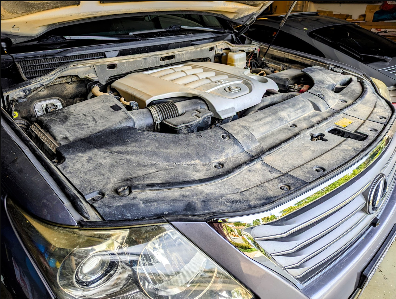

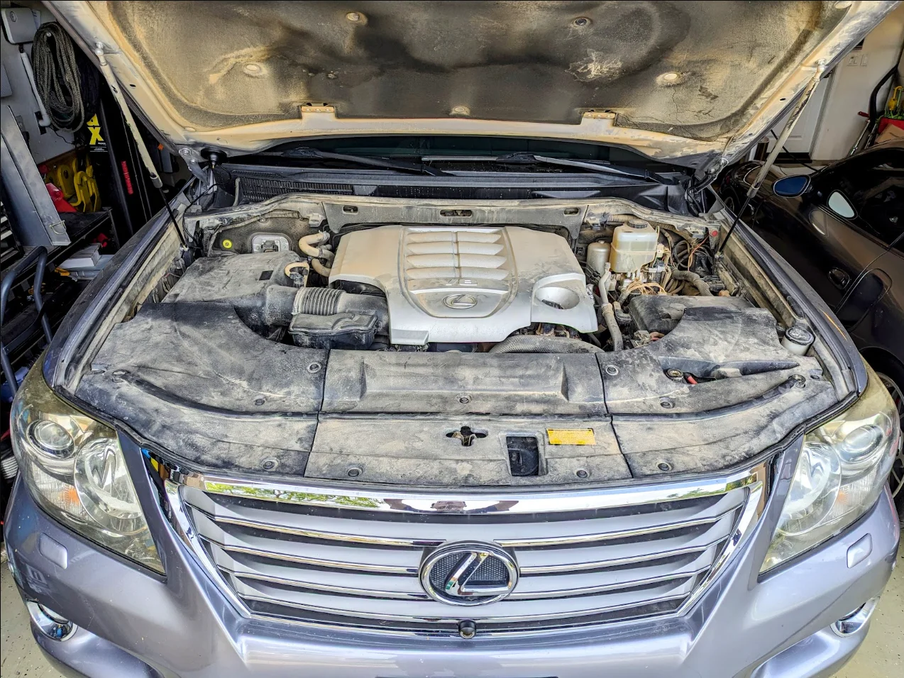

Okay, tidied things up and I'm satisfied with this cut. I prefer things to look somewhat OEM where I can achieve that. Cut out the inner extensions closest to the engine cover. It leaves a tidy lip. Small taper cut nearest the airbox and battery. A multi-tool with a half-moon blade makes quick work of the rounded cuts. Happy.
