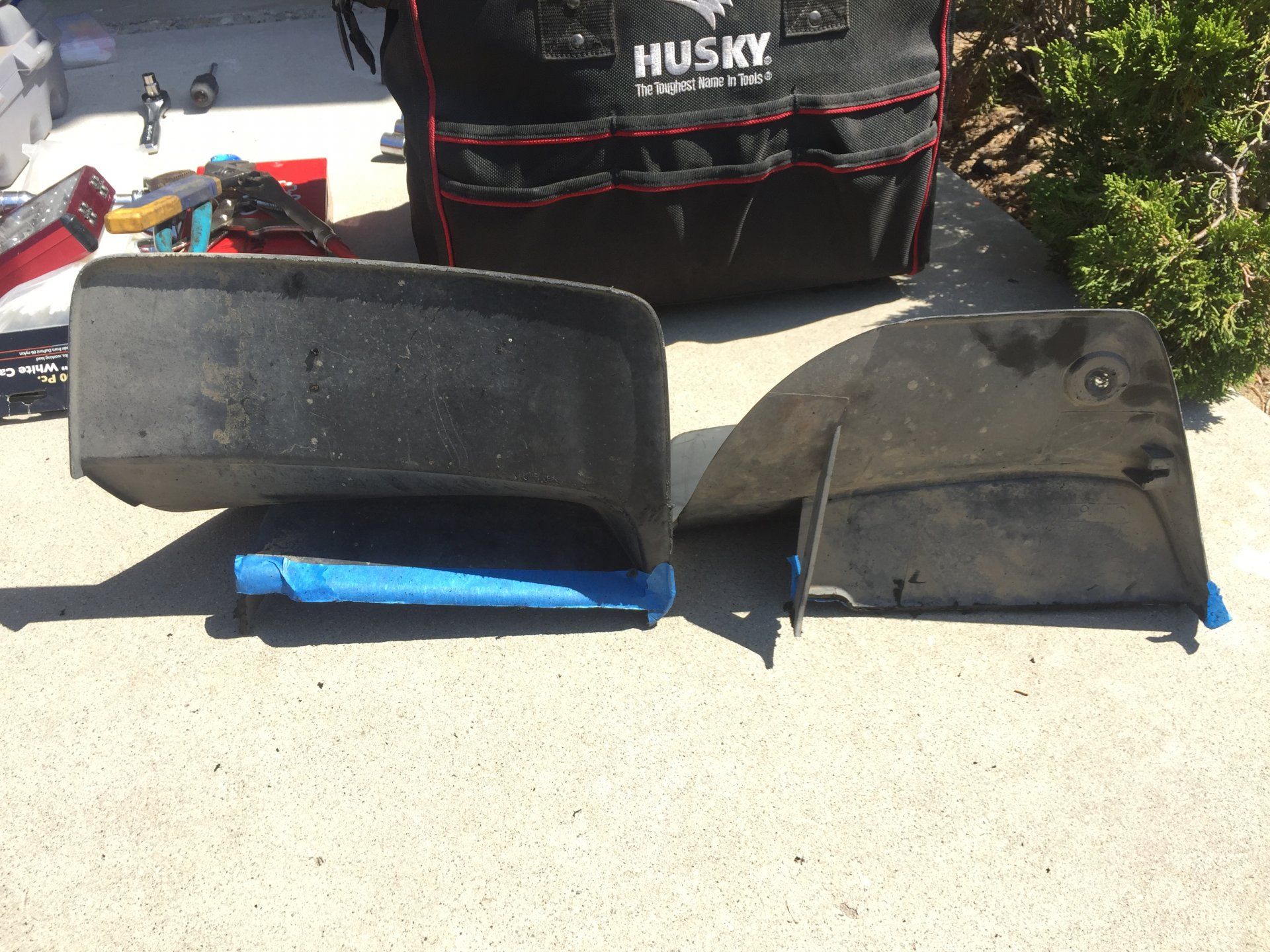

Alternatively, just trim the OE flaps. Follow the line of the transition and they'll look like they came that way - netting a clean OE look that doesn't drag and snag. Quick and Free.
How To:
Step one: Remove flares, cut off flappy part and reinstall
Step two: Find another project 'cause that only took a few minutes
Note: the only cut is the one showing the separation. The upper part looks different... just the angle of the pics

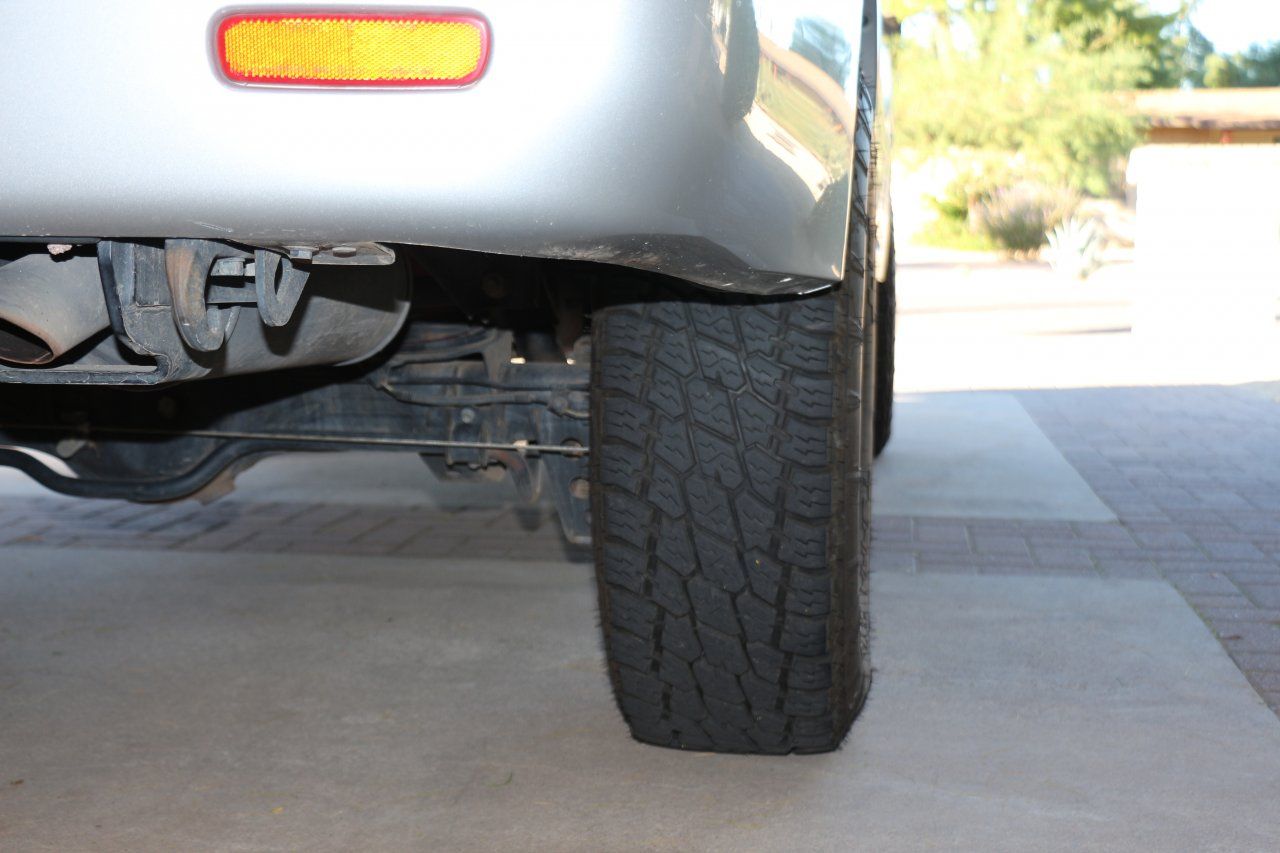

After:
Love your Hundy, Manhattan. This thread inspired me to do a little nip/tuck on mine. I just took a utility knife to the flap and cut it flush with the bottom of the bumper. Similar to how Phil's Phlaps look. It took 5 mins per side and it looks way better!

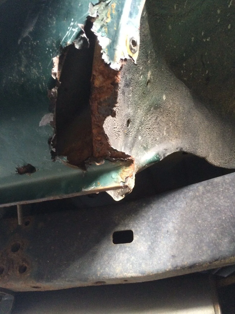

I went in to remove my 00's mud flaps last night, came right off, and a bunch of leaves/dirt and crud fell out from behind the mud flap. Always gotta love plastic pieces that trap crap, allowing rust to form. The socket wrench I used to remove the mud flaps happily went through the body in a few areas...lots of cancer back there.
Even if you have no plan to remove flaps, I'd suggest removing them and checking around for rust... I found plenty.
Plan is to cut our all the rusted metal, sand/clean, and spray with some bedliner or something. Luckily none of this is visible so it doesn't need metal welded back in. Any thoughts or criticisms on this one banana fix?

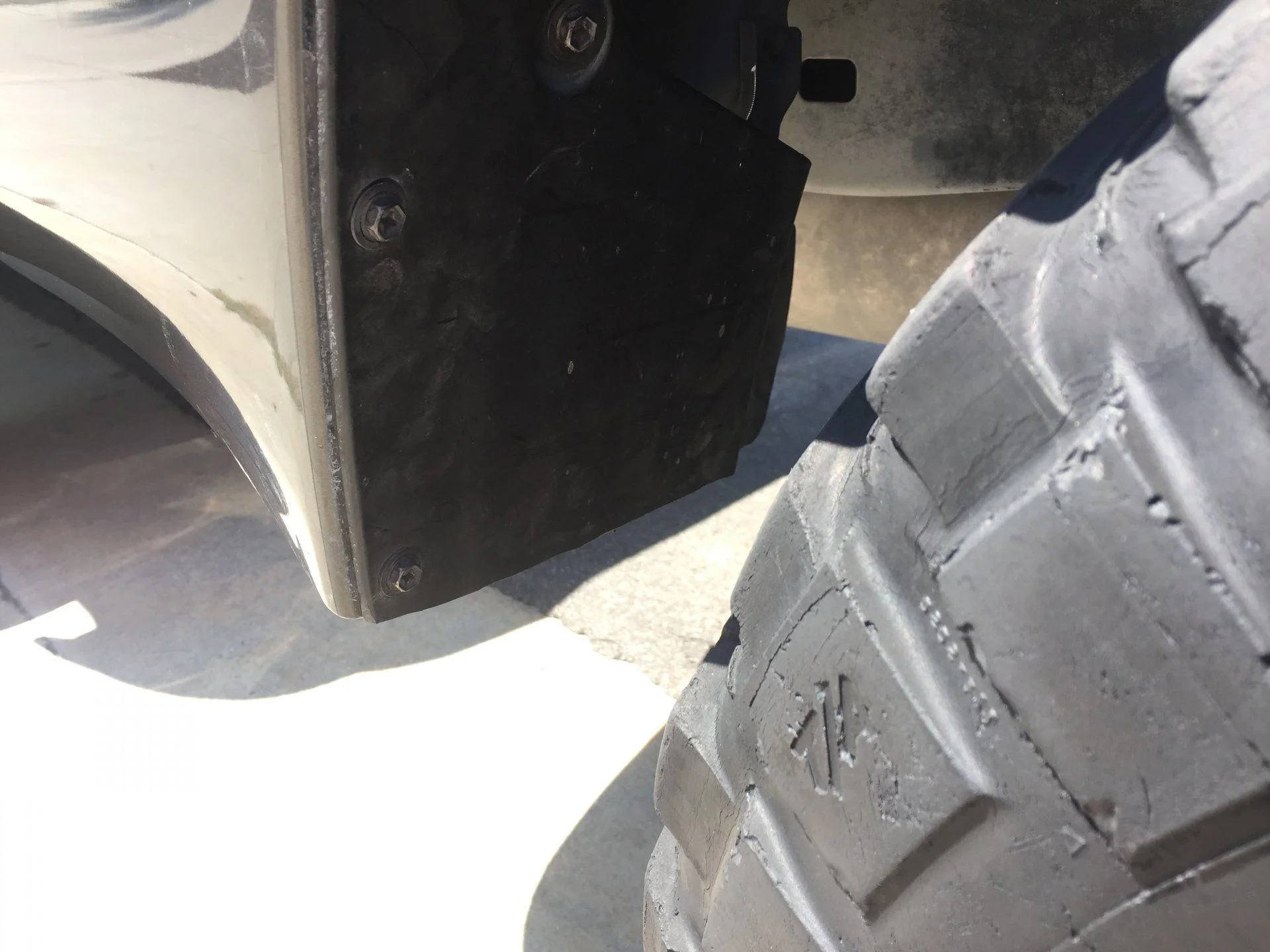

Thanks for the idea. I used 1/8" ABS plastic from Taps Plastic locally. I also push the bumper in and rotated the bottom of the bumper inward. For reference I have 275 70 18 KO2s with 18" Tundra wheels. BTW - waiting for a buyer for the running boards before I take them off so I'm not tripping over them.

I'm going to be doing the exact same thing on my rig this weekend...did you end up cutting it out? How'd it turn out?

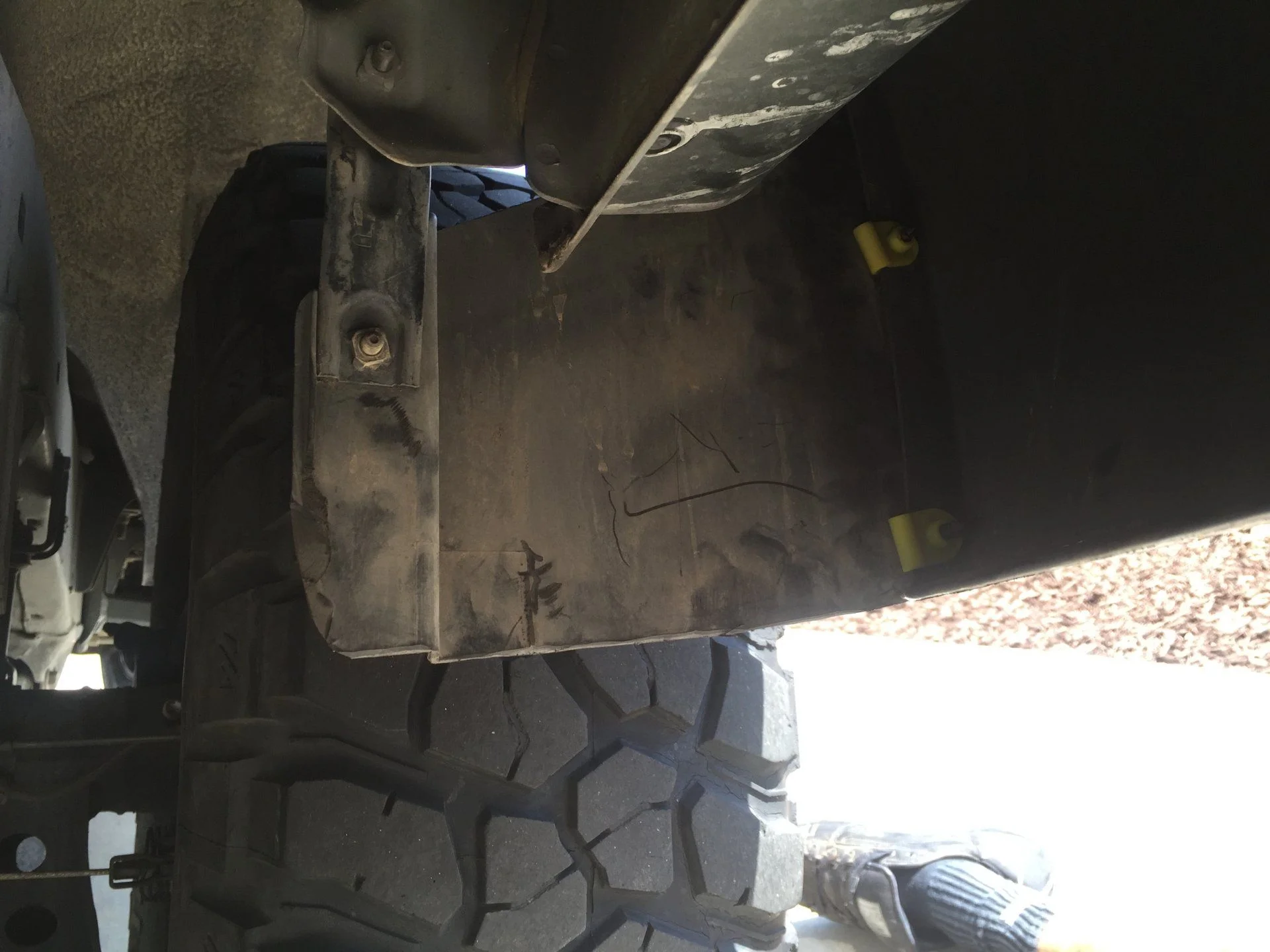

Here's mine. Cut the stock flap off with my dremel and cleaned it up with a razor blade and put it back on.
