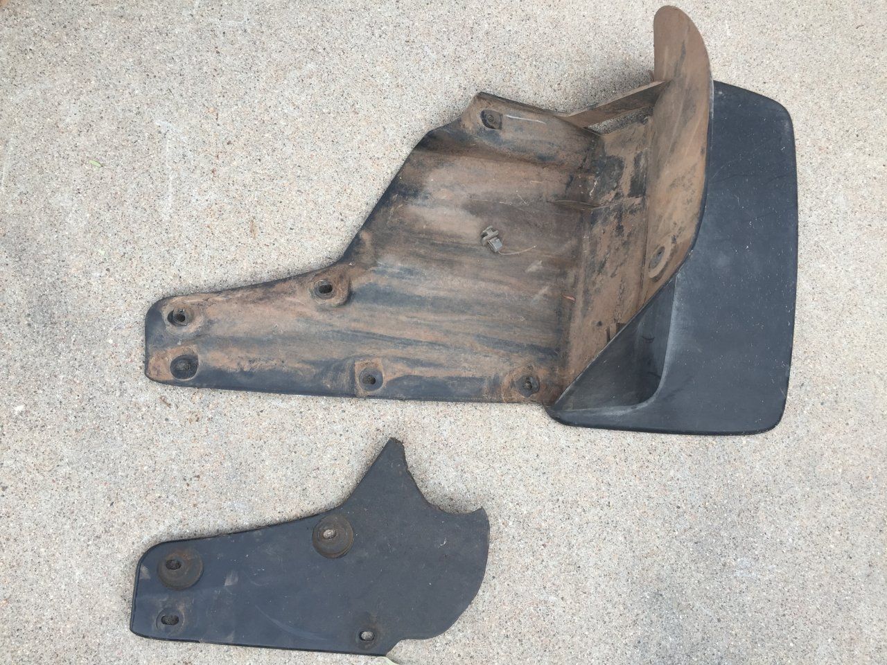

Removed mud flaps on a stock bumper
Very neat idea. One of the first things I did to my cruiser was to pull off the bent and twisted mud flaps. I cut the bumper support out of the original flap with a sharp utility knife since they were garbage. No problems going this route yet. Cost was about 20 minutes :)

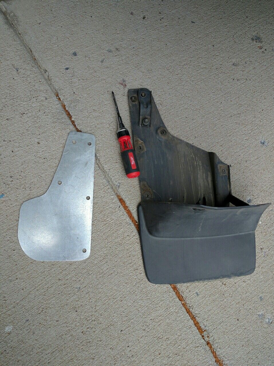

Will get a CAD drawing and make a run on the CNC in the future. Group buy list started PM me
Installation tip - Plates are shipped flat and need a little curve for a perfect fit. Use a basketball or soccer ball and hold on the edges and push the plates onto the ball for a smooth curve, worked great for me.

Just replaced broken mud flap on passenger rear and perfectly good flap on drivers rear.
Showed wife and she is happy.
1/2:banana:. Took less than 20 minutes both sides. Very strong...dare I say better than factory.

Phil I have some industrial rubber that I can provide for R&D. I'd be happy to be guinea piglet for my UZJ. I have enough stock to help you or others if desired. What are the base dimensions of LxW you need for each side? Thanks Phil.
19ga is a good thickness in my opinion. Not too heavy but they withstood lots of rocks getting thrown at them with no noticeable impact craters. I actually don't know that they would even need rubber on them, I only heard rocks ping them once.
