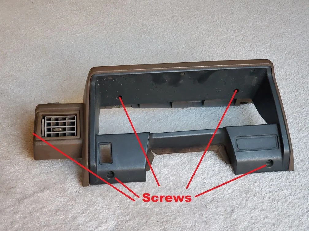

I am attempting to remove the bezel and spedo and am not getting very far. The right hand side will not release and I don't see how to get it out. Any body have any tips on how to do this? I have ck YouTube and don't find anything. Thanks, Gary
There are only 5 screws that hold the dash on. The cluster comes out with 4 screws.
