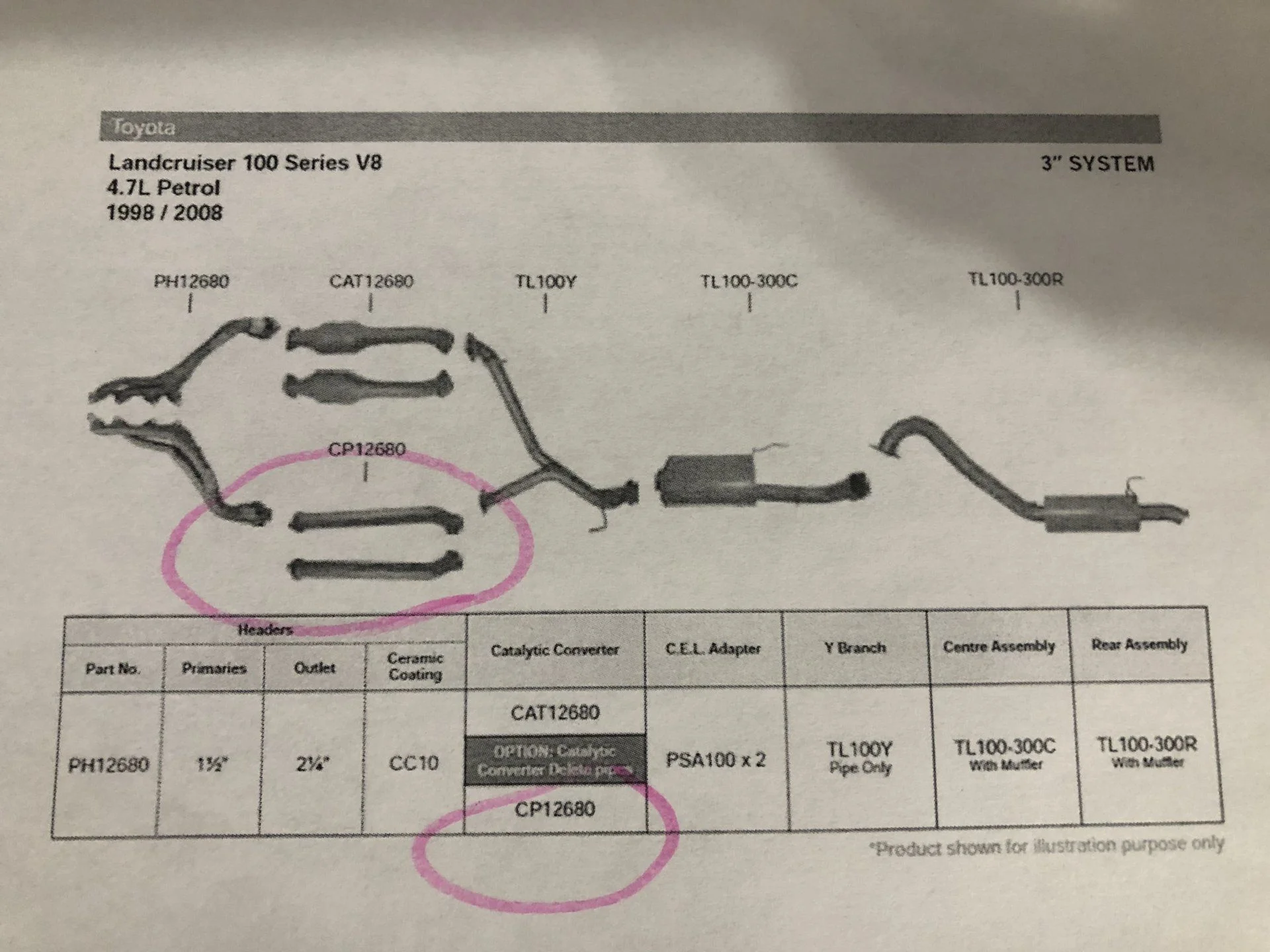

Mine is a 98, does that mean I can just get the straight pipes from partsouq and use them in place of my cats?
Did you use any spacers to trick the downstream o2 sensors?
If you're doing other power mods, maybe worth it. If you're leaving the rest of the exhaust alone, I wouldn't bother. Cat-less engines stink and, IMO, sound terrible in most cases (unless we're talking straight-piped performance engines).
No spacers, I'm using the urd calibrator.
I can't say which pipes fit the early 100. I'm sure they exist though.
