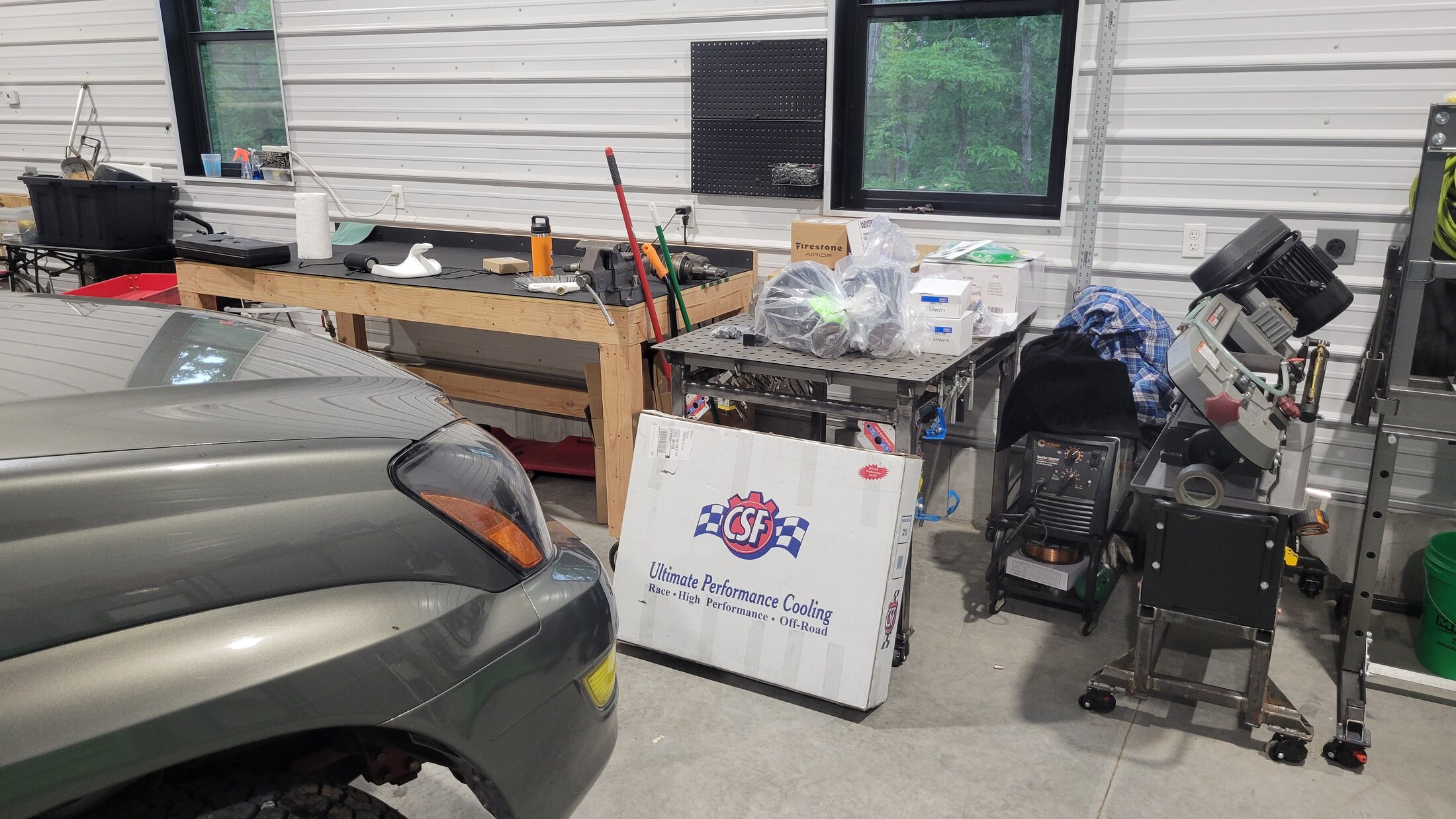

2. CSF alluminum radiator - I could have put in a Denso but figured "why not". My rig has gotten warm-ish on big climbs out west, so I'd like a little more cooling capacity.

Overall today went pretty good! The new shop is 100x nicer to work in than my tiny old one.

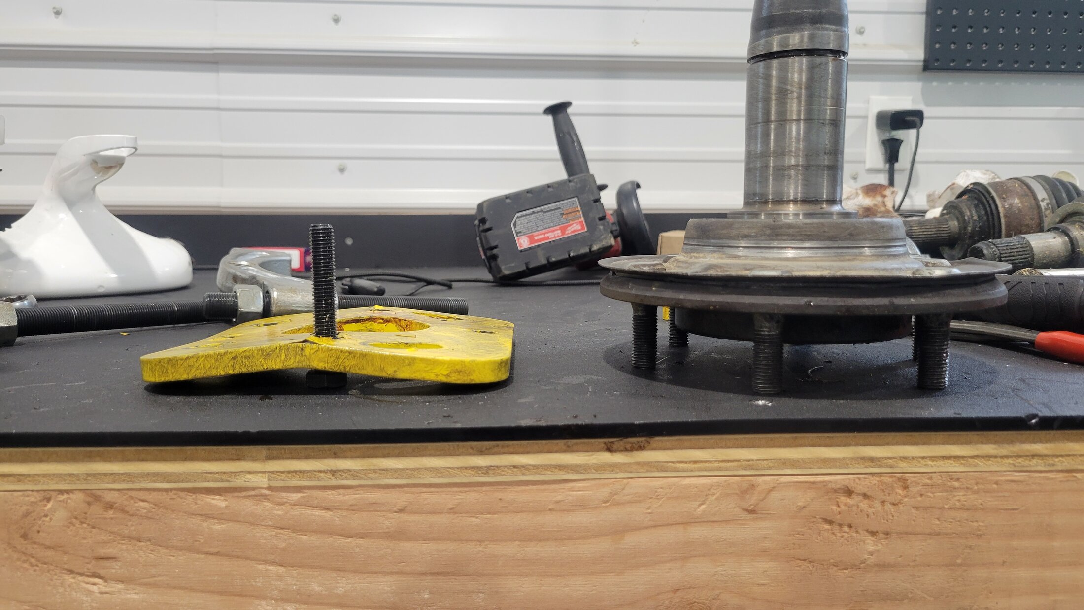

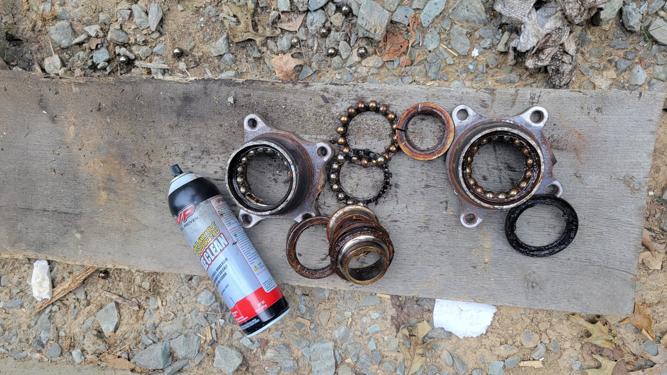

^The OEM rear wheel bearings were pretty nasty at 190K. They showed signs of some water getting in them. While the bearings were still smooth, I doubt these would have lasted much longer.

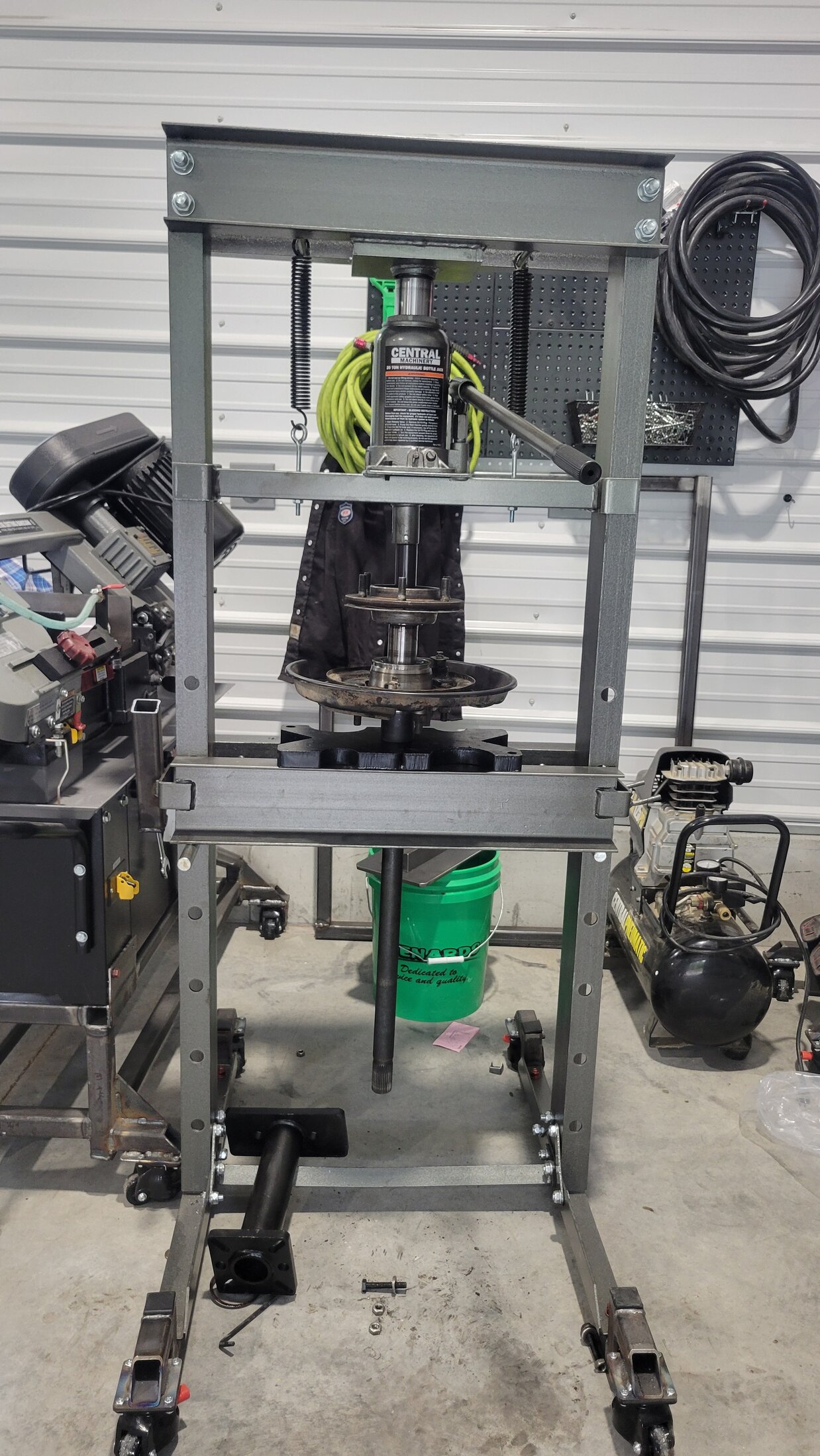

^They cheapie Amazon wheel bearing tool just barely got me through both bearings. It's 3/8 steel, but must be made out of recycled tin cans of something. Total junk, hopefully I'll get a refund for this. I also had to use a rental bearing splitter from Autozone to get outer race off the axleshaft. Overall, this wasn't too bad.
^Pressing the new SKF bearings onto the axle. I used a spacer from a ball joint service kit and it worked really well.

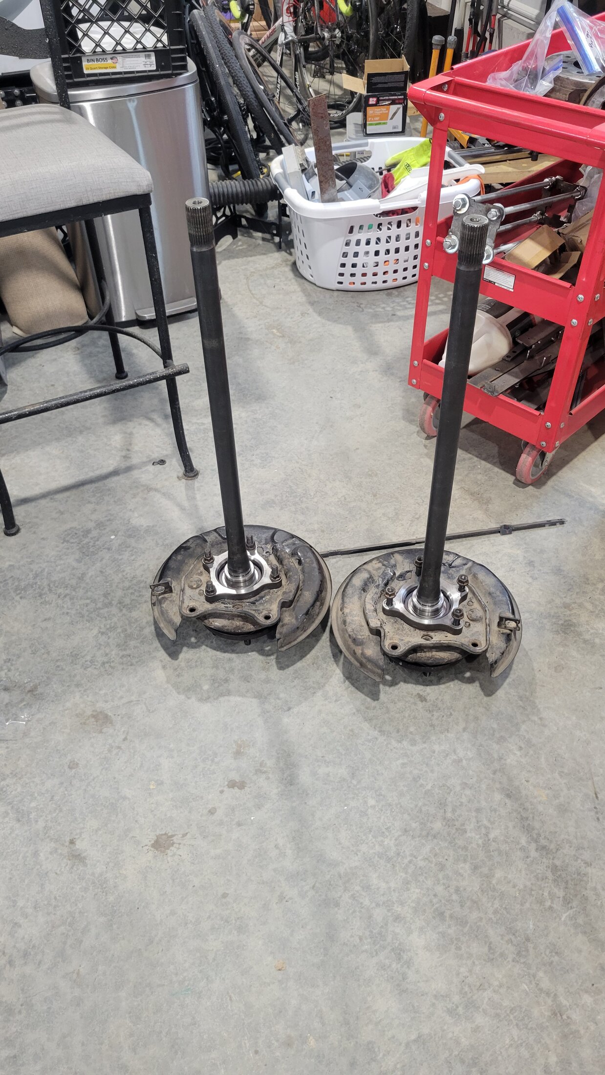

^Both axles with near bearings. I didn't get new snap rings and mangled the old ones, so Mrs. Rednexus is going to run to the dealer tomorrow and grab a couple for me. I can also verify that my 2007 GX470 axles slide right into the 8.2 Harrop elocker and the 8.2 Australian trussed housing.
