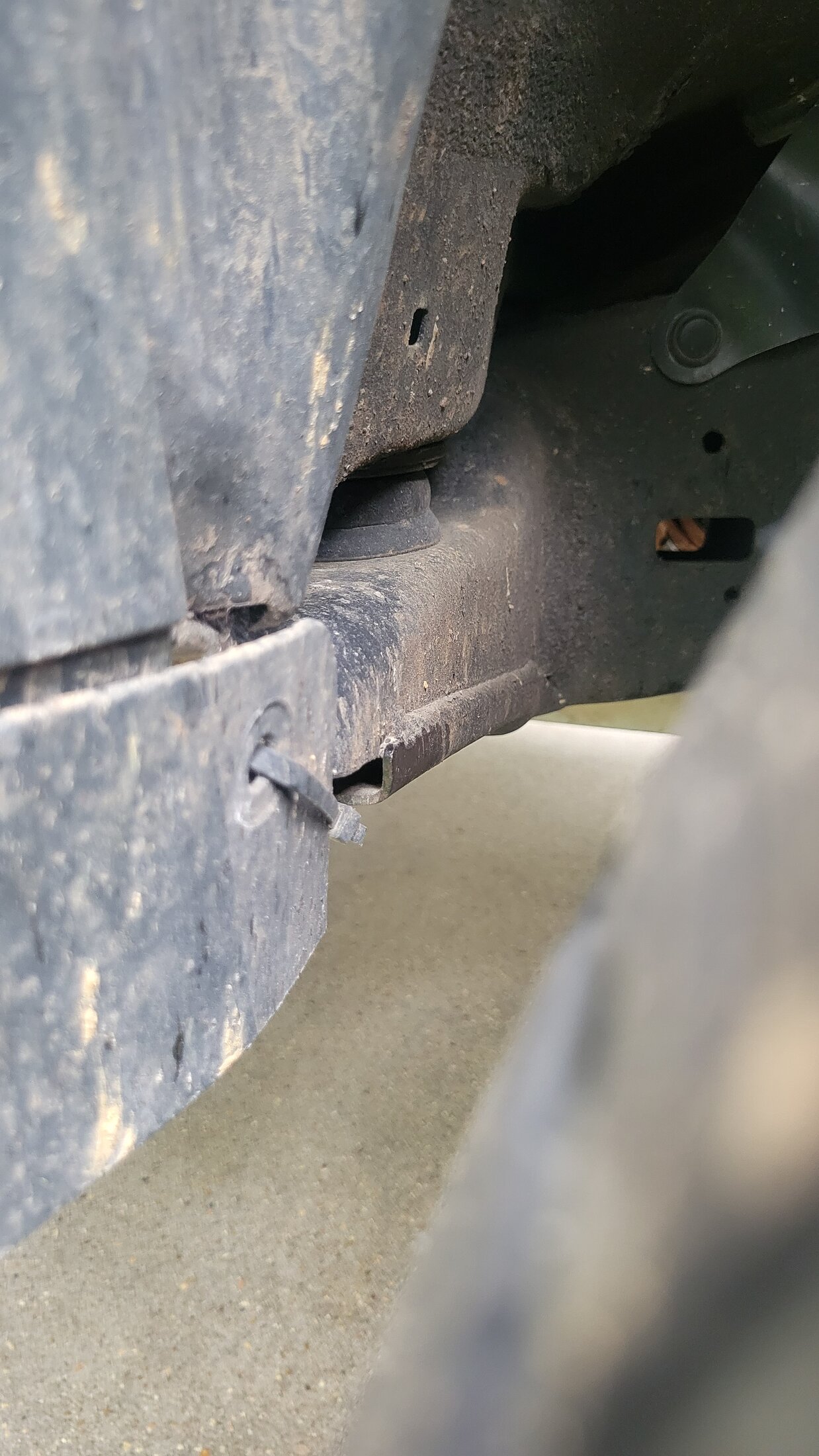

While I was doing to brakes my buddy made a little metal bracket to hold the lower trim/former step piece in. I had this zip tied to the old body mount, which had been sliced off. It's not way more strudy and looks quite a bit better.
