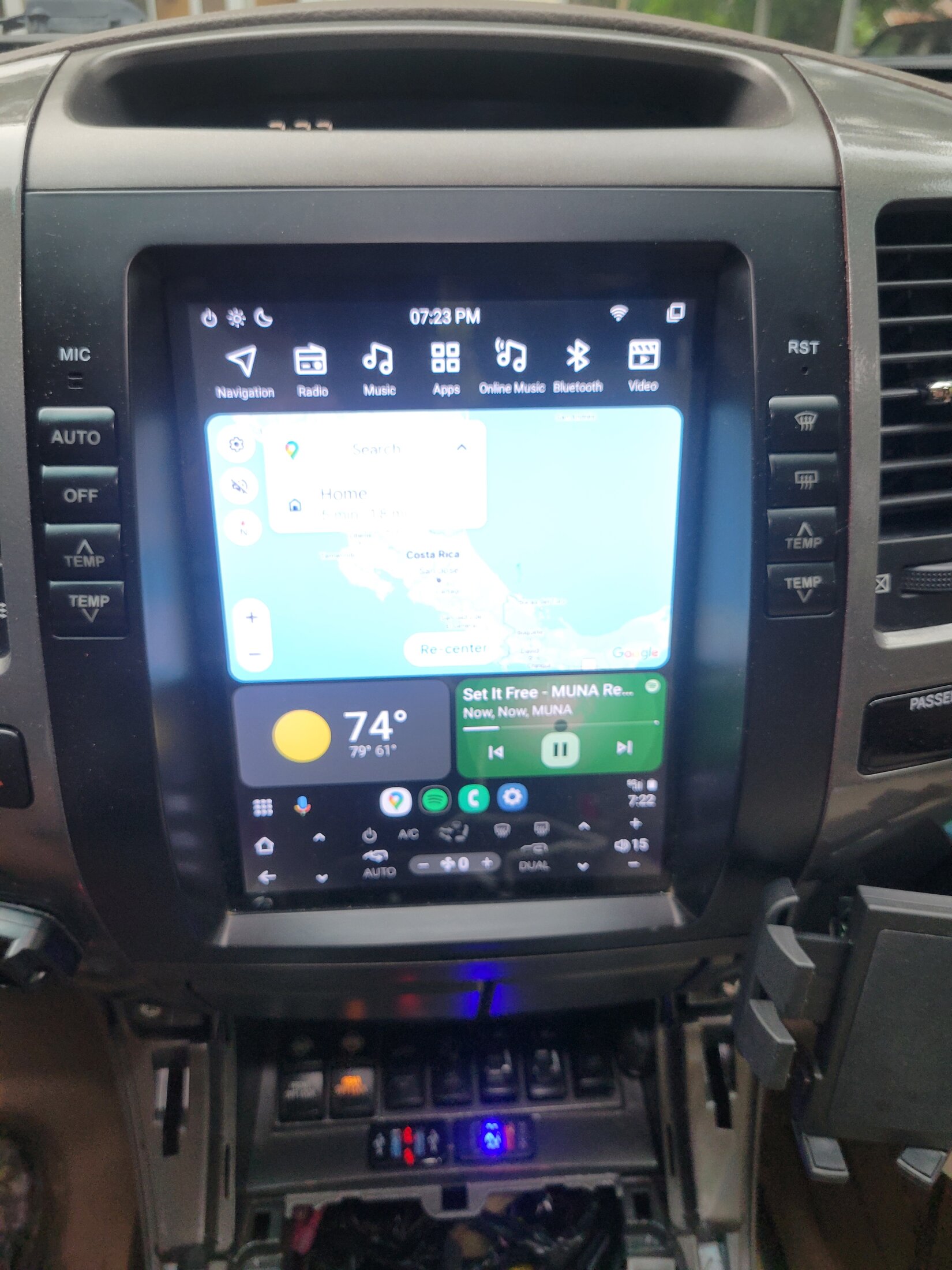

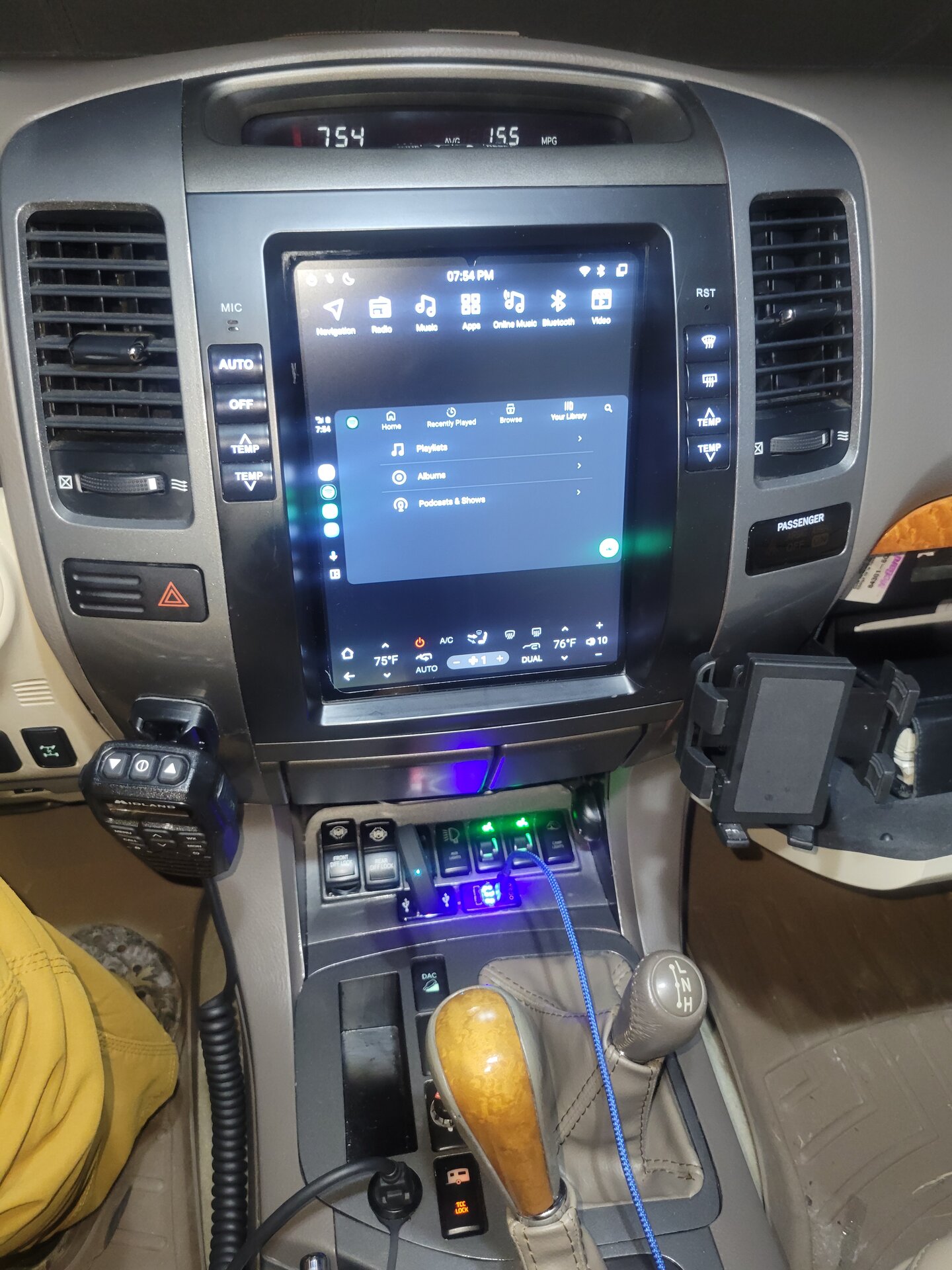

Did some more interior work last night, including adding a new Android Auto/Car Play adapter for the PX6 and hiding the wireless Android Auto adapter. The old adapter had problems sometimes with wired connectivity, which I attributed to wear/dirt in the USB plug. This had the added and unexpected benefit of upgrading Android Auto to full-screen! Pretty nice to have this in a 2007. The wireless connection now boots up much faster too. I'll probably never run it wired and just retain wireless with my phone plugged into the QC port.

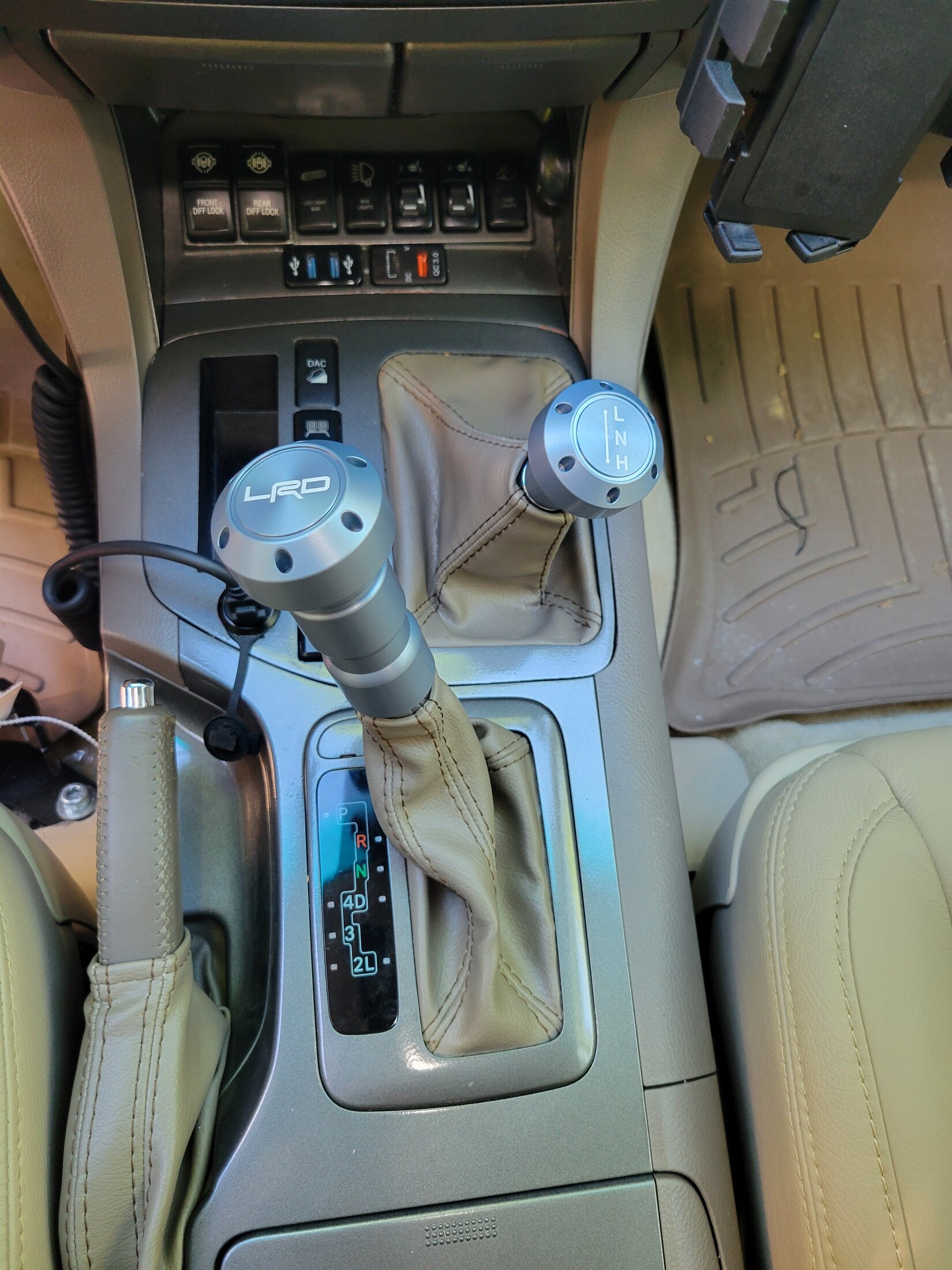

Also installed the Ellis Precision shift knobs I've had sitting around for months. They feel awesome and the extra weight makes shifting easy. I also replaced the shift detent pin (per the suggestion of @stupidchicken03 ), which was super easy. I checked the shift cable bushing while I was in there and found it to be perfect. Everything in the shifter mechanism also got a coat of Dumonde bicycle chain lube, which IMO works great in these kind of applications.

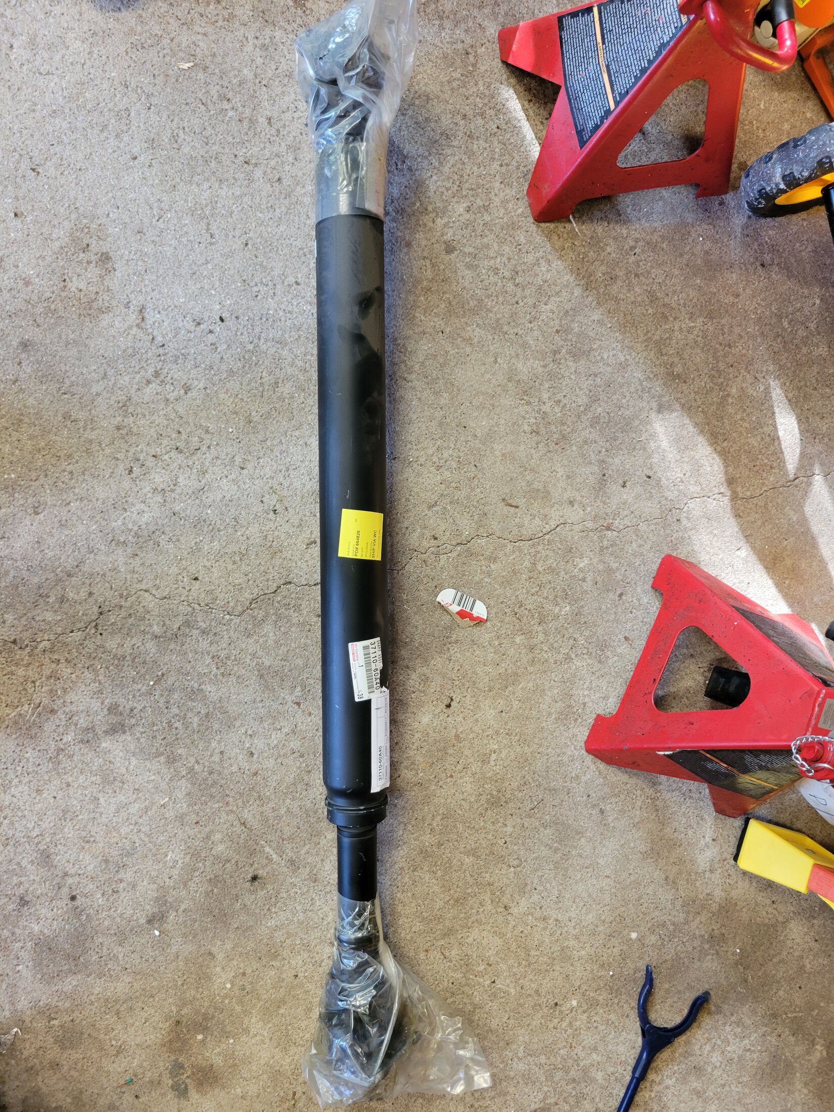

And now we're up to today. Installing a new driveshaft to hopefully get rid of the awful clunk.

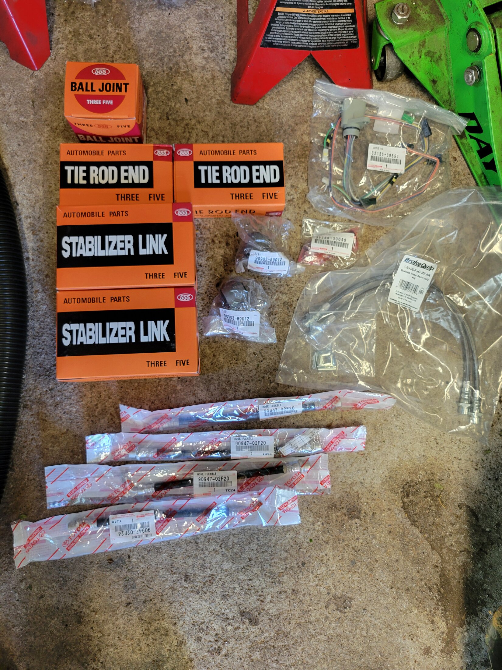

And these parts. All of the 555 parts are replacing poor-quality aftermarket parts from a few years ago - including the recalled UBJs in my Ironman UCAs and Moog tie rod ends and sway bar end links, all of which have really crappy boots that ripped. The brake lines are to replace my SS PowerStop lines from 3 years ago, per my debacle with them, and the trans pieces are to try and get rid of the P2759 code that I think is a fault in the trans harness or the TCC solenoid.

The 555 stuff was quite a bit nicer than the Moog junk and whatever UBJs Ironman had in their UCAs. It was actually pretty easy to swap the UBJs with a HF ball joint press. The problem with 555 stuff is that it isn't painted (other than the end links), so I gave everything a quick coat of gloss black paint and then Fluid Film'd the hardware.
No photos for the driveshaft. The clunking seems to be much better than it was before, so I'm hopeful it stays that way. I'll always have some clunks with the Nomad valve body, but they aren't unsettling like they were before. Also, whatever grease Toyota used smells like cow pies.....a lot like cow pies (being from the Ozarks, I know what they smell like :)).

Also still loving the new driveshaft. All the clunks are gone! It's an updated version and was $316 from my local dealer (same price as Partsouq but no shipping costs).
