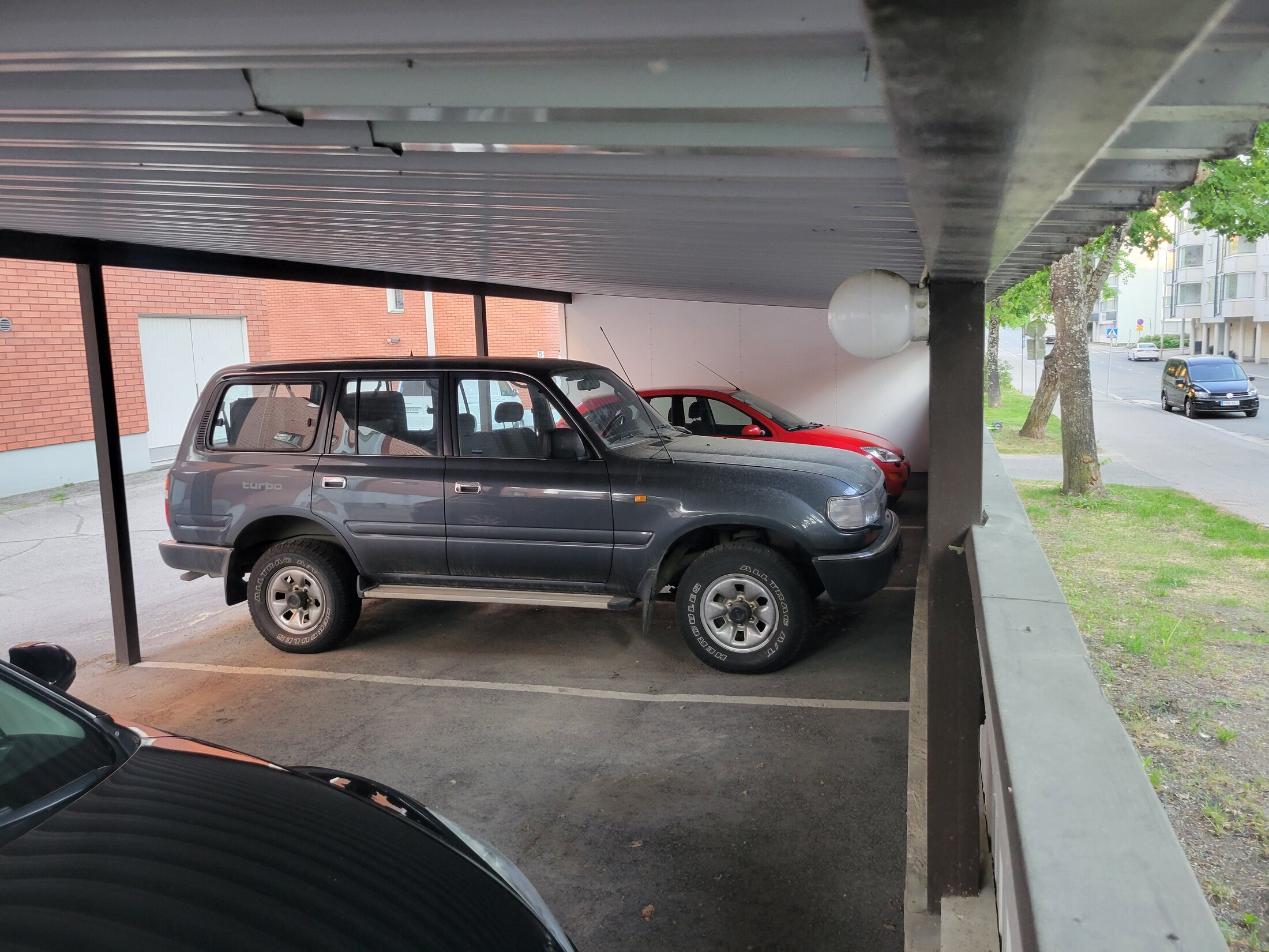

Turbo diesel 80 spotted yesterday. Amazingly nothing is rusty here. They avoid salt via mandatory studded tires and lots of plowing.

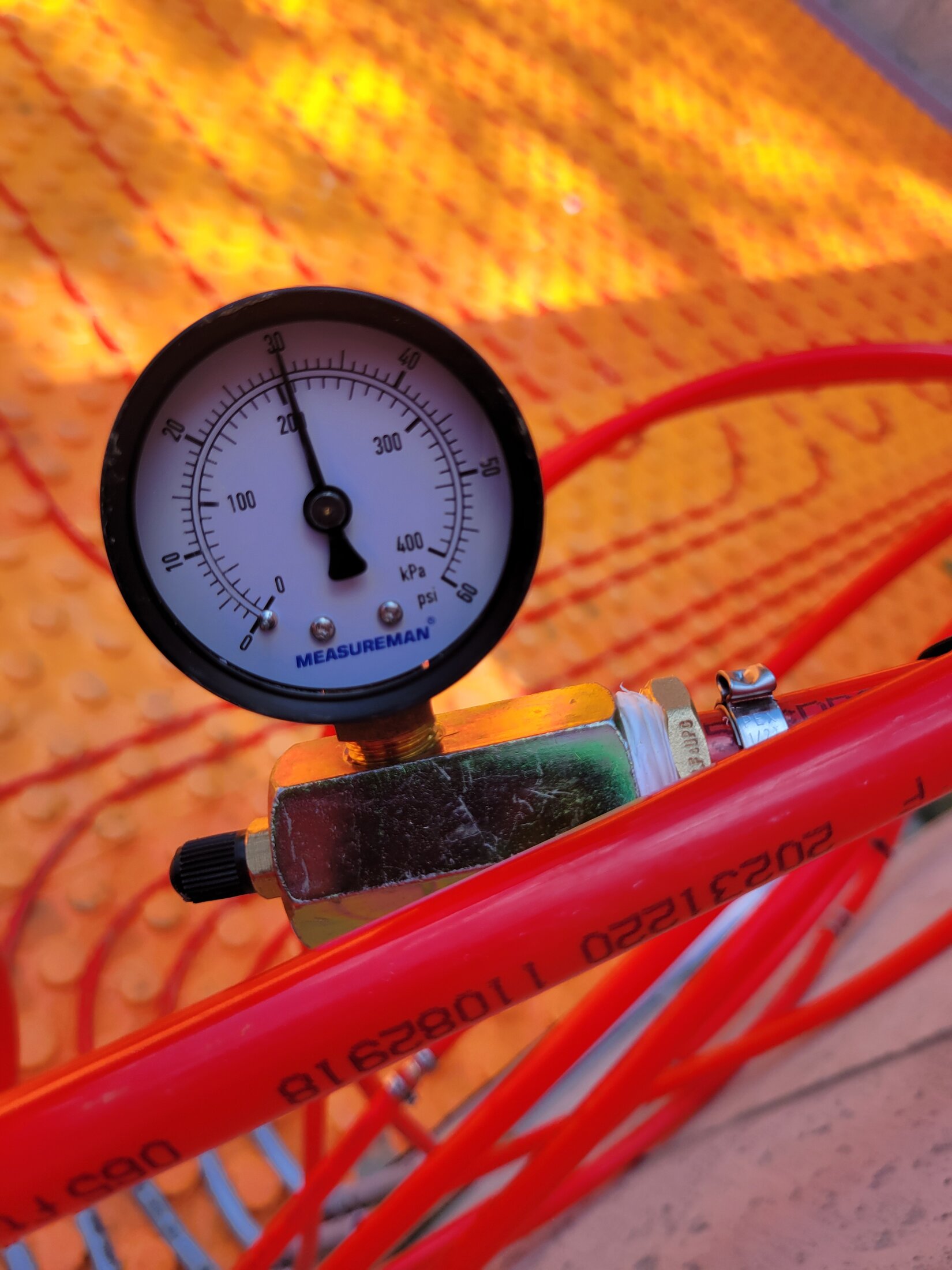

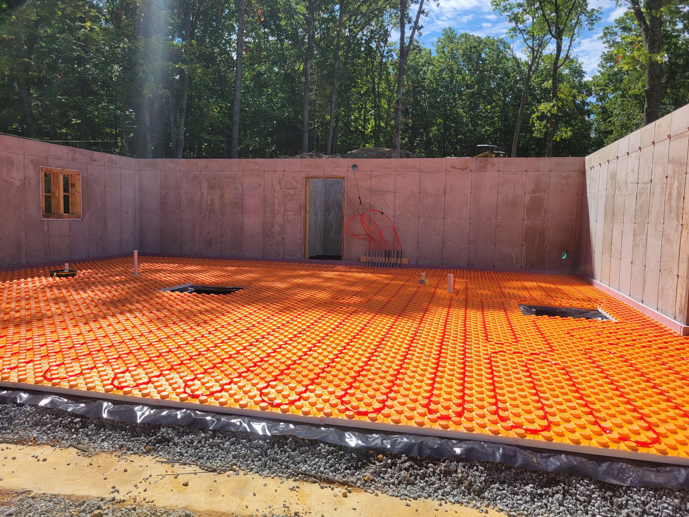

Caught a cool pic on our trail cam after a very hot day of DIY radiant floor installation.
You building that entire structure?
I'm GCing it (which I don't recommend as it's basically a 2nd job :) ) but have various contractors doing 95% of the actual work. It was hard to find anyone to do the radiant so we DIY'd it.
Don't crush my dreams before I get started :D
Lol. It's saving us money for sure and I know where every dollar is going. It would be much tougher if my day job wasn't so flexible. I'll be glad when it's done though and we move in.

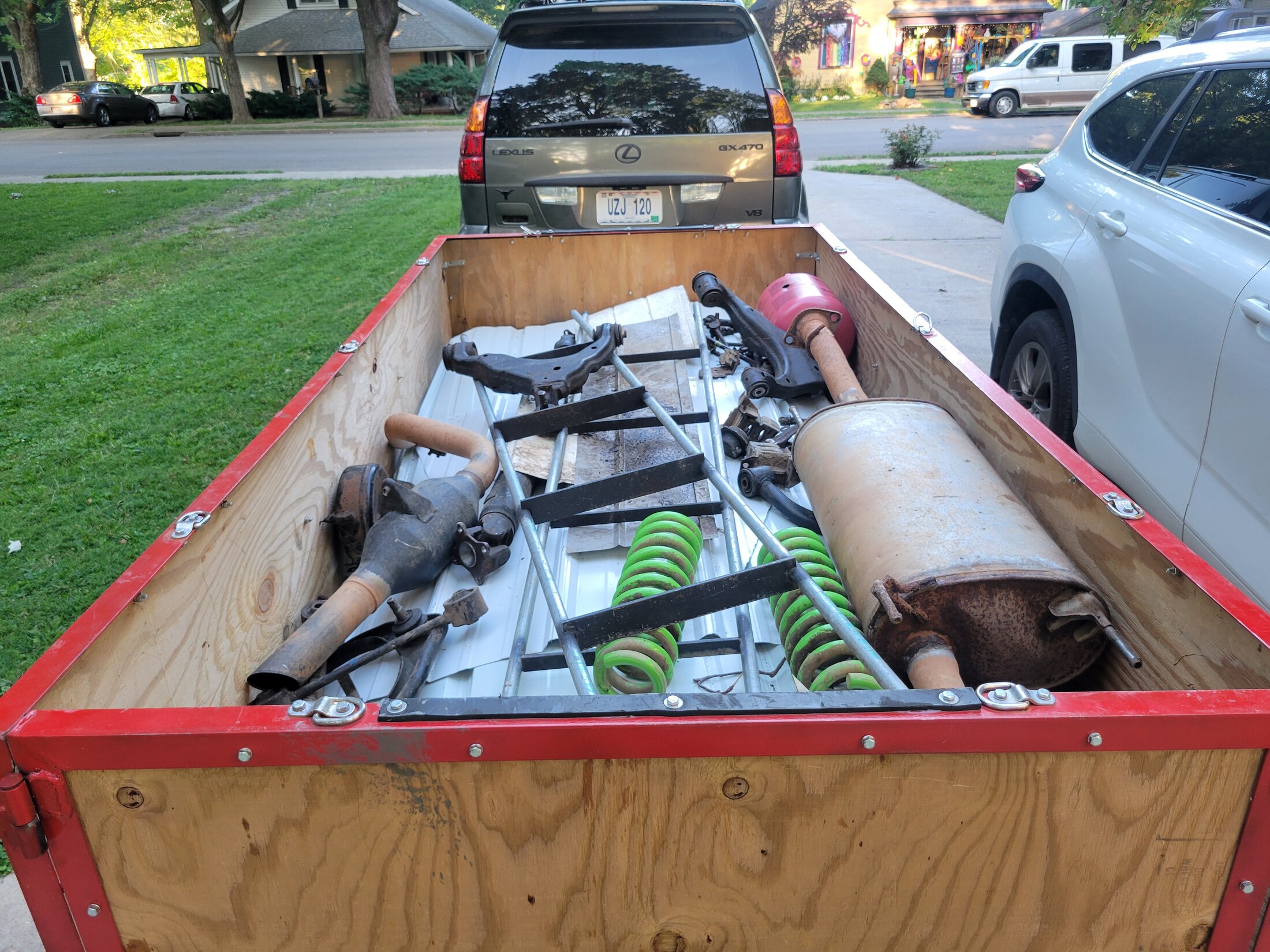

Made $31.25 in beer money today. Always feels weird when I roll up to the dump....or now the scrapyard....in a Lexus. 500# total of ferrous metals. The GX with the empty trailer and me is 6050#.....kind of a heavy girl!

Warranty return in 2022. The original coils sagged/bent and started rubbing the shock body. Ironman sent me brand new complete coilovers after I filed a claim. I pulled off the coils and scrapped them, but have the old shocks on eBay right now :)

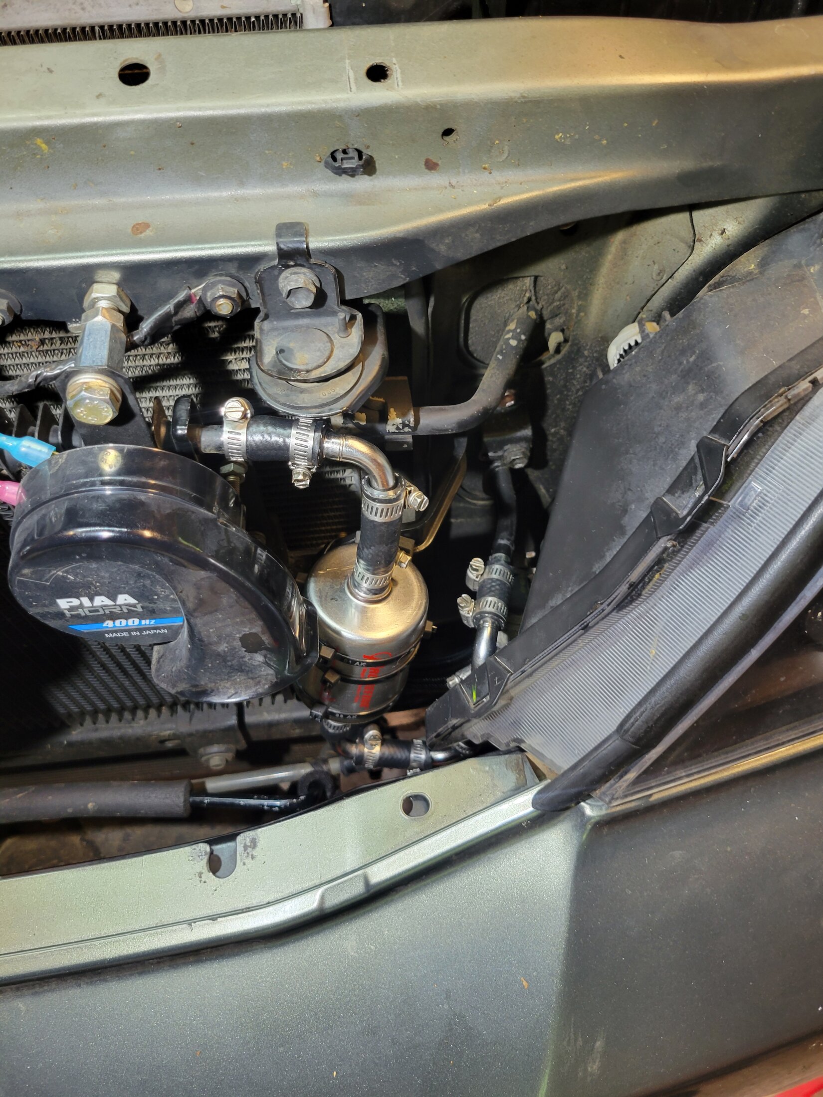

I also cleaned up a Magnefine filter that I had added behind the transmission cooler. The stock trans basically has no filtration, just a screen and some magnets in the pan. I'm hoping this will catch anything that goes through the kind of crummy stock system. However, it was tough to put it near the cooler without kinking the trans lines. I could have put it elsewhere, but wanted to put it somewhere highly visible (so as to remember to replace it at each trans fluid exchange, or to quickly bypass it if needed). I ended up using some 304 SS barbed 3/8" elbow fittings, which were pretty hard to find, but allowed the filter to be installed without any hose kinks. I'll probably buy some more of these fittings and re-do my Magnefine filter for the power steering system, as they are way cleaner than looping hose around.
