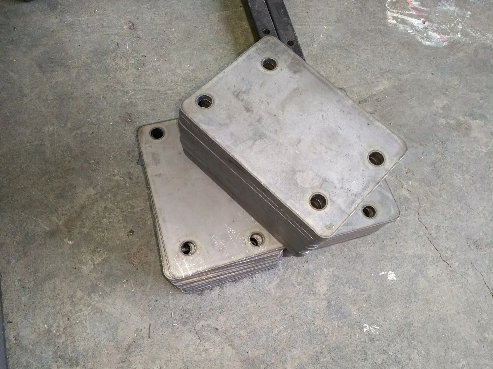

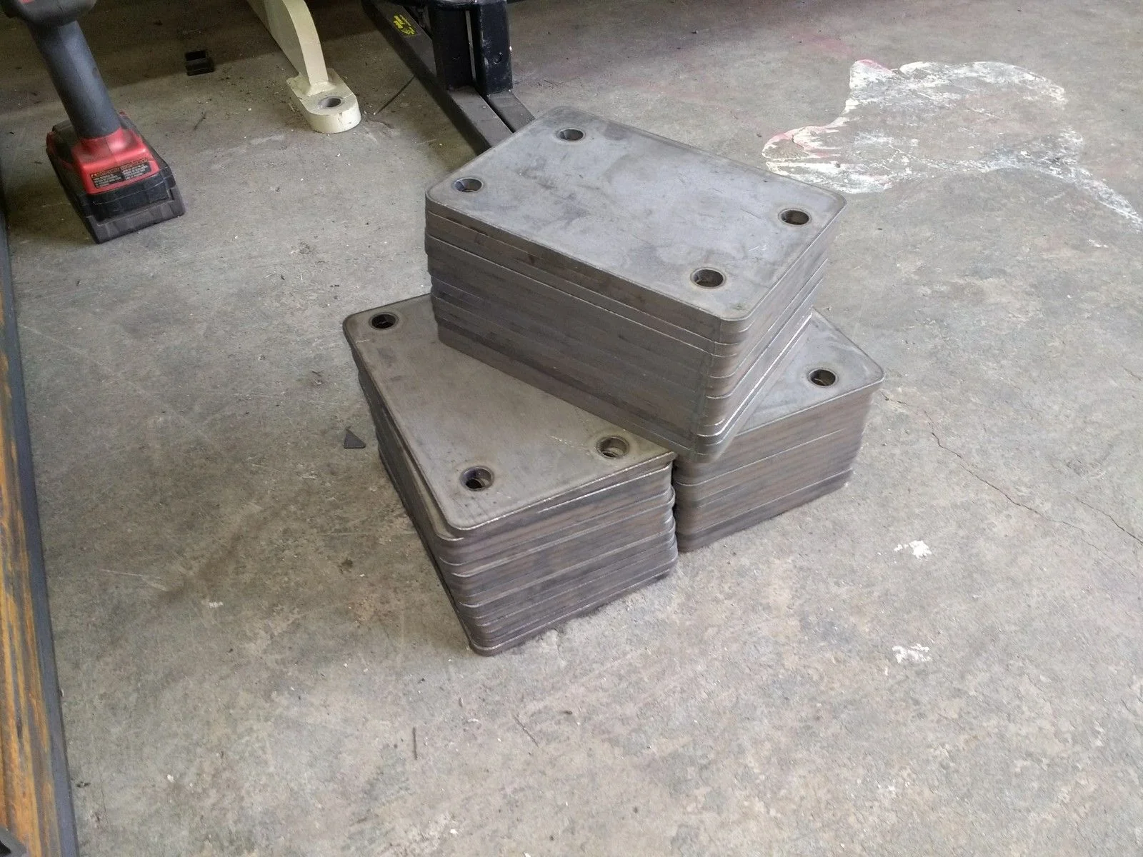

Some updates..
I got 10 main rails cut/mitered today and after 3 CAD revisions I have the frame plates dialed in to where I'm happy and fit nicely on a 92 and a 97 model. As time allows I'll work on the plates and gussets this week.
I should have pricing by Sunday.
Powder coating is an additional 50$ in semi-gloss black.
I've ordered custom boxes for shipping.
I plan to have 10 of these ready to ship in two weeks +/- a couple of days for the powder coated ones.
Jason would this work with a h151 equipped 80? The frame mount is a little foreword
Took 20 crossmembers over to the machinist to be drilled and mill bored.
I section cut the top out of a crossmember this morning and it twisted and pulled upward... so that idea is FILE 13'd. So the dual plate set-up is still in play. All plates (skid and frame) will be 1/4" grade 50 plate.
