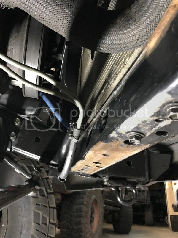

Transmission hard lines were are just hanging on their own weight, after getting the exhaust re-done the passenger bank curved under the transmission lines. Since the lines weren’t attached anywhere they just wanted to lay on the exhaust. In an attempt to stem the pain I zip tied the lines out of the way, this however isn’t a long term solution. I ordered up a transmission thermostat (Thermostasis 165*), inline cooler with -6 fittings (AFCO 37600), and 20’ of -6 Aeroquip push lock hose.
Picked the rocks out of the condenser and factory transmission cooler, then straightened the fins as best I could with a dental pick…
Removed the old transmission cooler lines and cooler, spent an hour cleaning up the inner fender and front cross member. Had a nasty power steering and transmission fluid leaks…

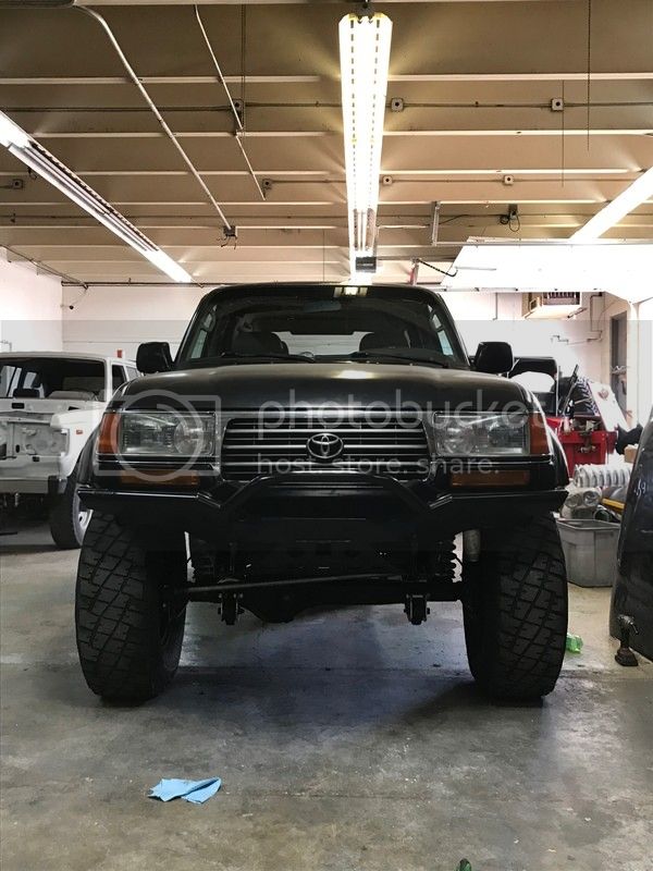

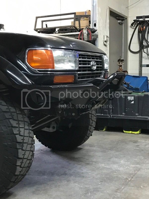

While waiting on transmission parts to show up my bumpers arrived from Luke (4x4 Labs), I admire the die they have to throw that beautiful roll bend in 3/16”. After seeing his bumpers I knew that I wouldn’t be able to build anything as cool in a fraction of the time so I ordered a set.
Front passenger frame horn was a little tweaked on my truck so we cut the weld at the crush zone, wedged in a porta-power and got it within 1/16” of the drivers frame horn. Bolted the bumper down tight and then tacked the frame rail into place, removed the bumper and fully welded it. The bumper looks like it sits a little lower than most but I have a 1” body lift (to help clear 37s).
I like the way the bumper radius flow around the lower valence… Currently have the nose of the truck stripped back down to trim the core support. I am going to trim the core support back enough that even in the ¾ shot it will not be visible.
