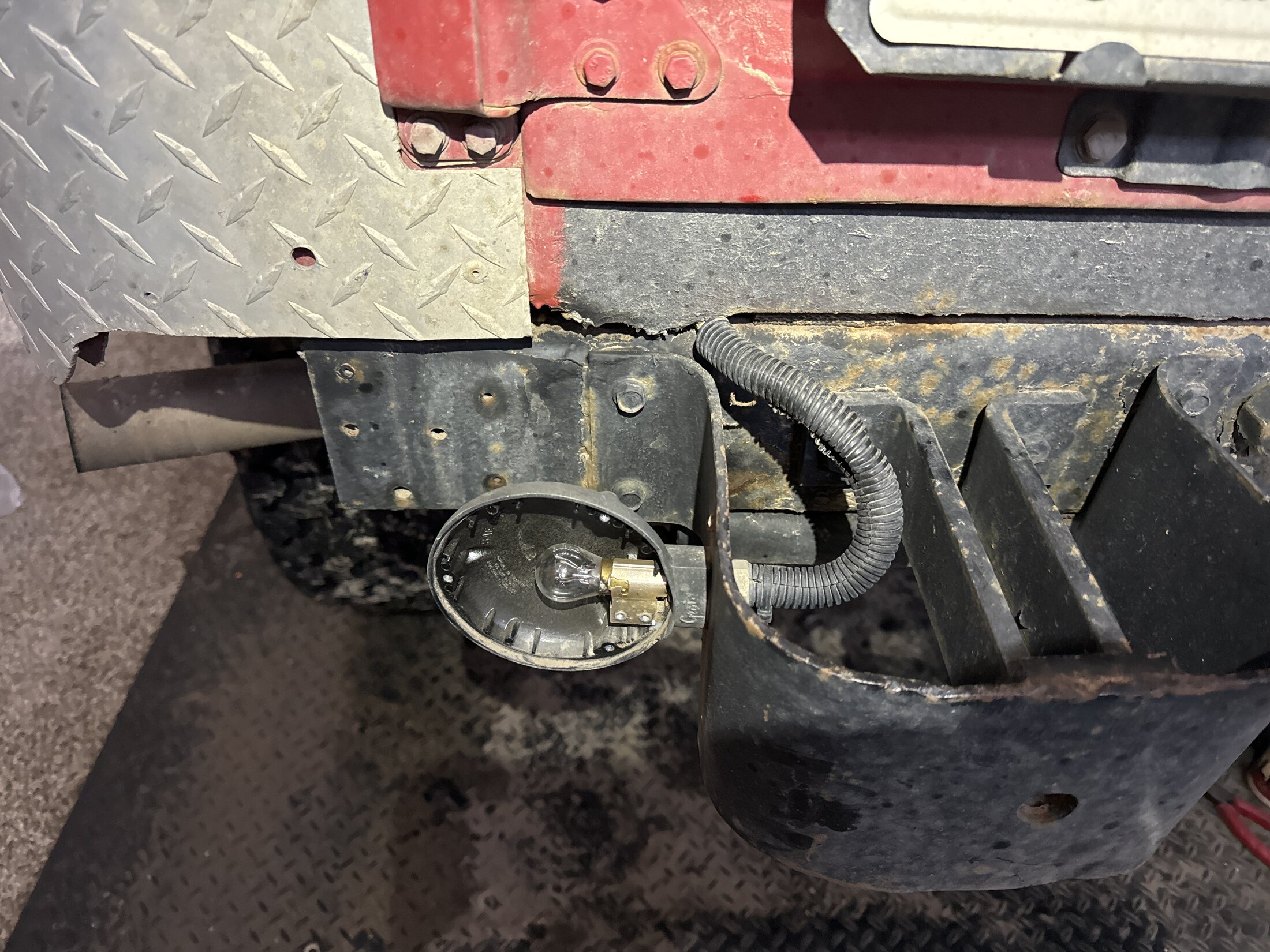

so i’ve lost my rear signal lights. the front work properly and the dash indicators work. my driving and brake lights work i’ve chased the wires and they all seem to work. there are two connectors on the firewall that have these wires in them. i’ve taken them apart and cleaned all the corrosion out. any other places that are common for this issue to occur i should be looking? i can’t find the break in the circuit. i’ve also just noticed my rear left signal works only when the brake is on. the right brake light doesn’t work nor does the signal. i wonder if they were wired wrong 🤷‍♂️
by the way i don’t have oem rear lights. i have these
there’s two wires to these lights. i assumed one was for running and the other was for signal/brake.
When weird things happen it's usually a ground. Your probably correct on the 2 wires. The light needs a good ground. Do the wires have voltage?
they work fine for running lights so i assume they have a good ground
i played with the harness under the dash that connected the steering column to the main harness. with wiggling it a bit i had people left side brake and signal function though intermittent. i also had proper right side brake at one point. never got the right signal to work though. (swapped bulbs and the bulbs are fine). but at least i think i’ve found the place to start checking wires and cleaning the connectors! maybe ill get this sorted tonight afterall!!
Have you tried separating and re-seating all the connectors?
If wiggling it about gets it working then it's usually either corrosion at a connector joint, or where the wires are crimped into the contacts.
Have a closer look at the steering wheel connectors
The turn signal switch is pretty primitive with its contacts and operation. I use a test light to find where there is power or not throughout the circuits.

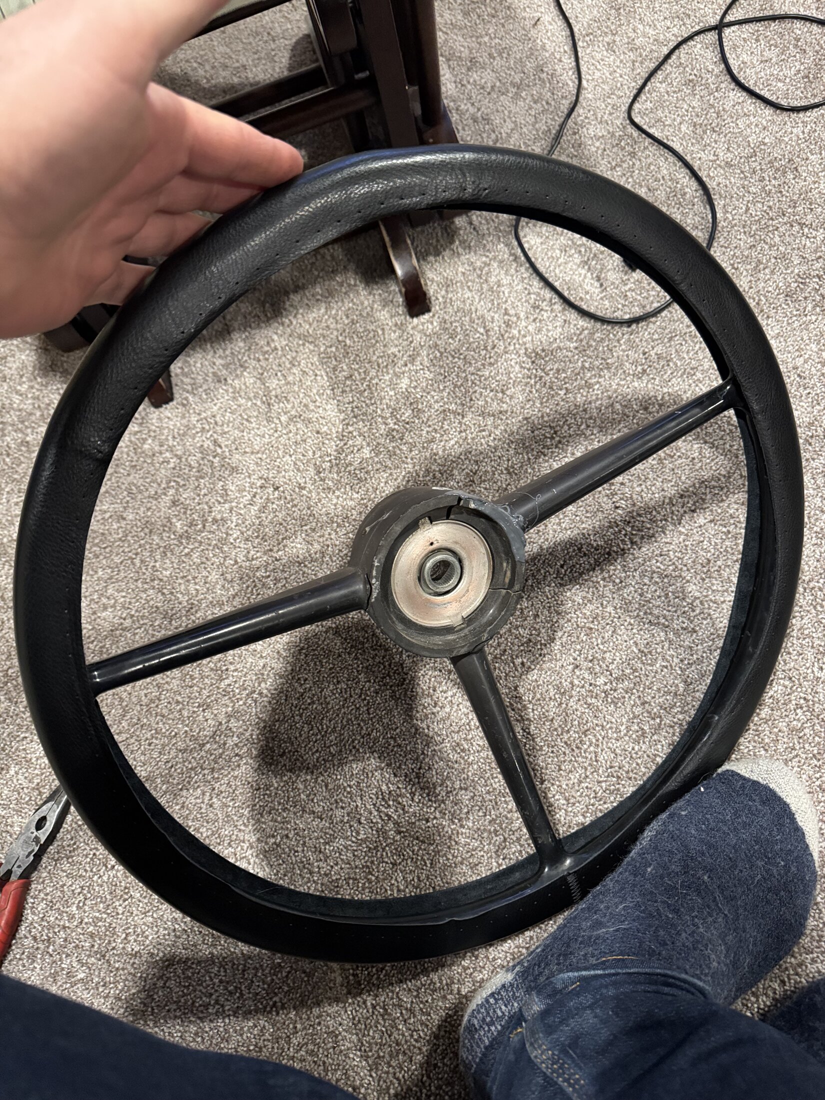

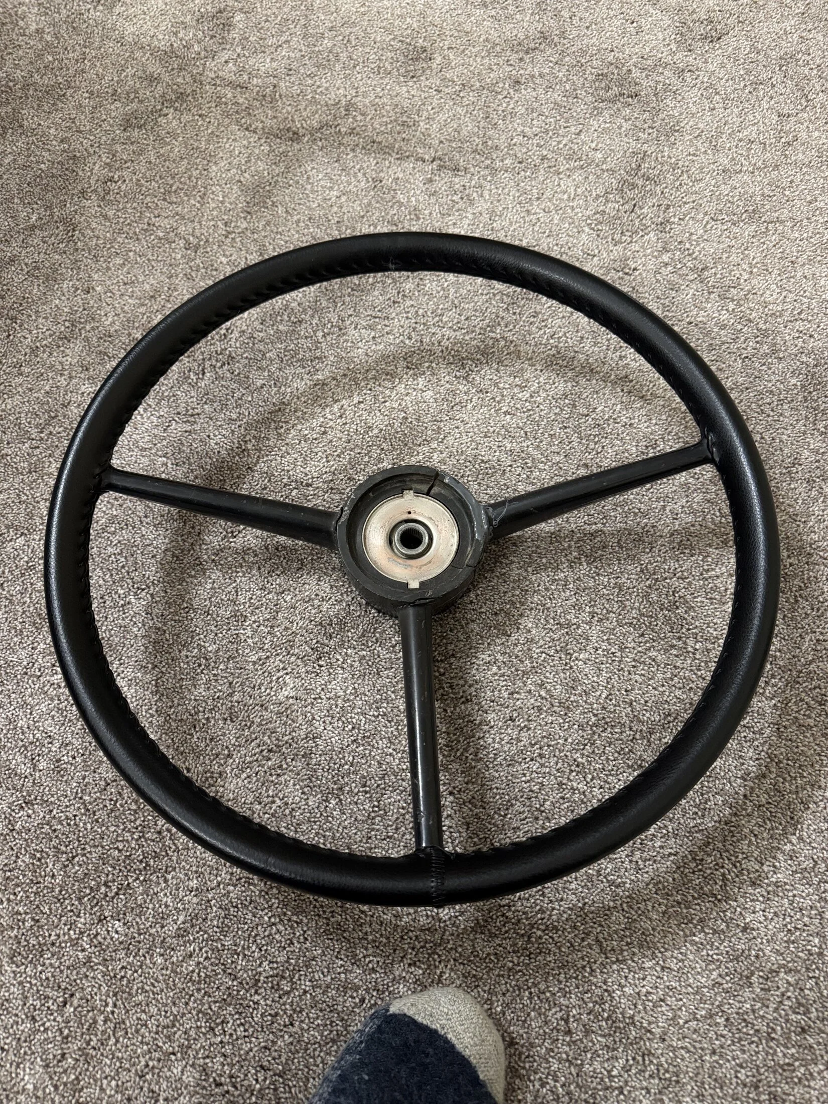

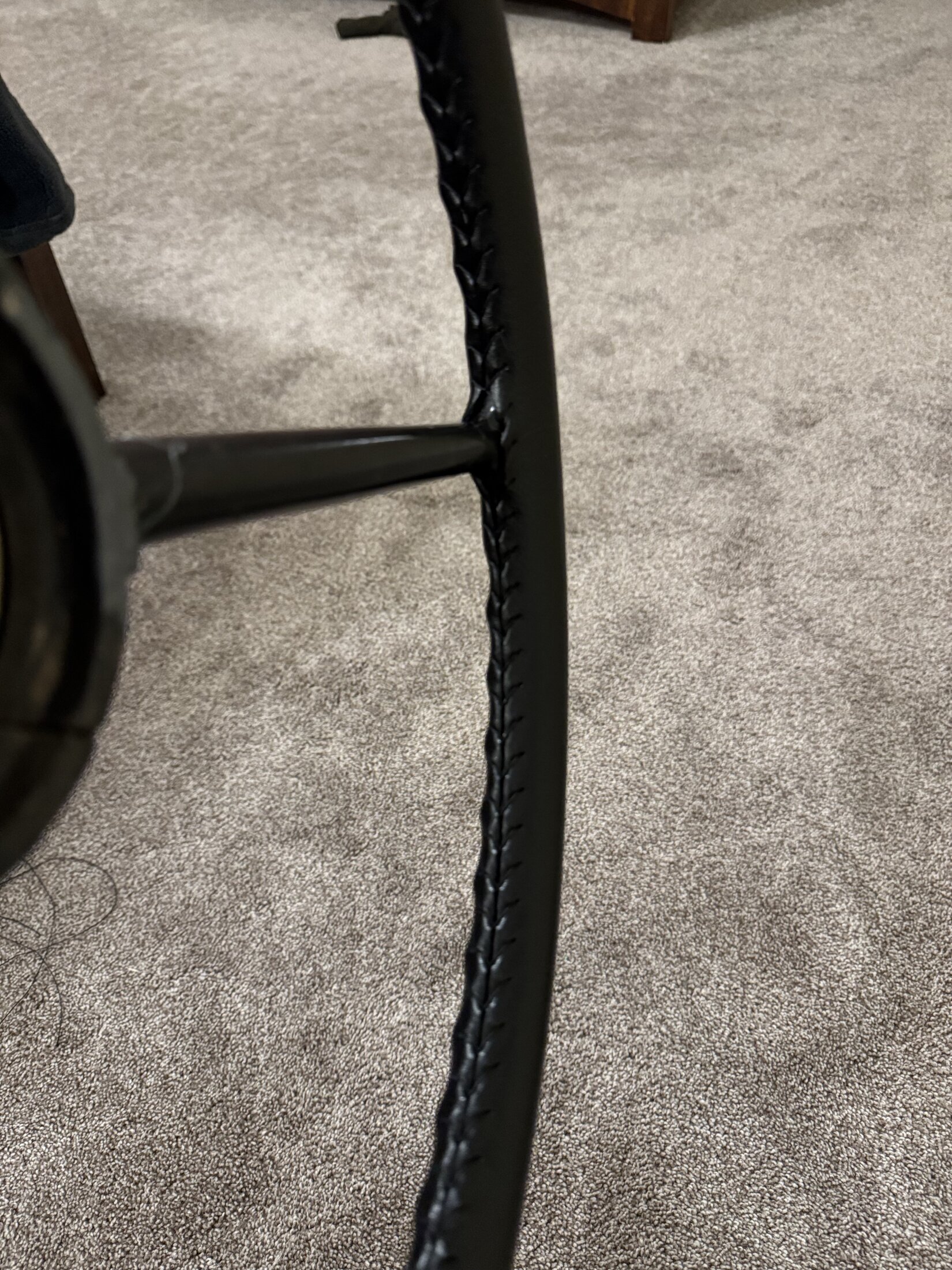

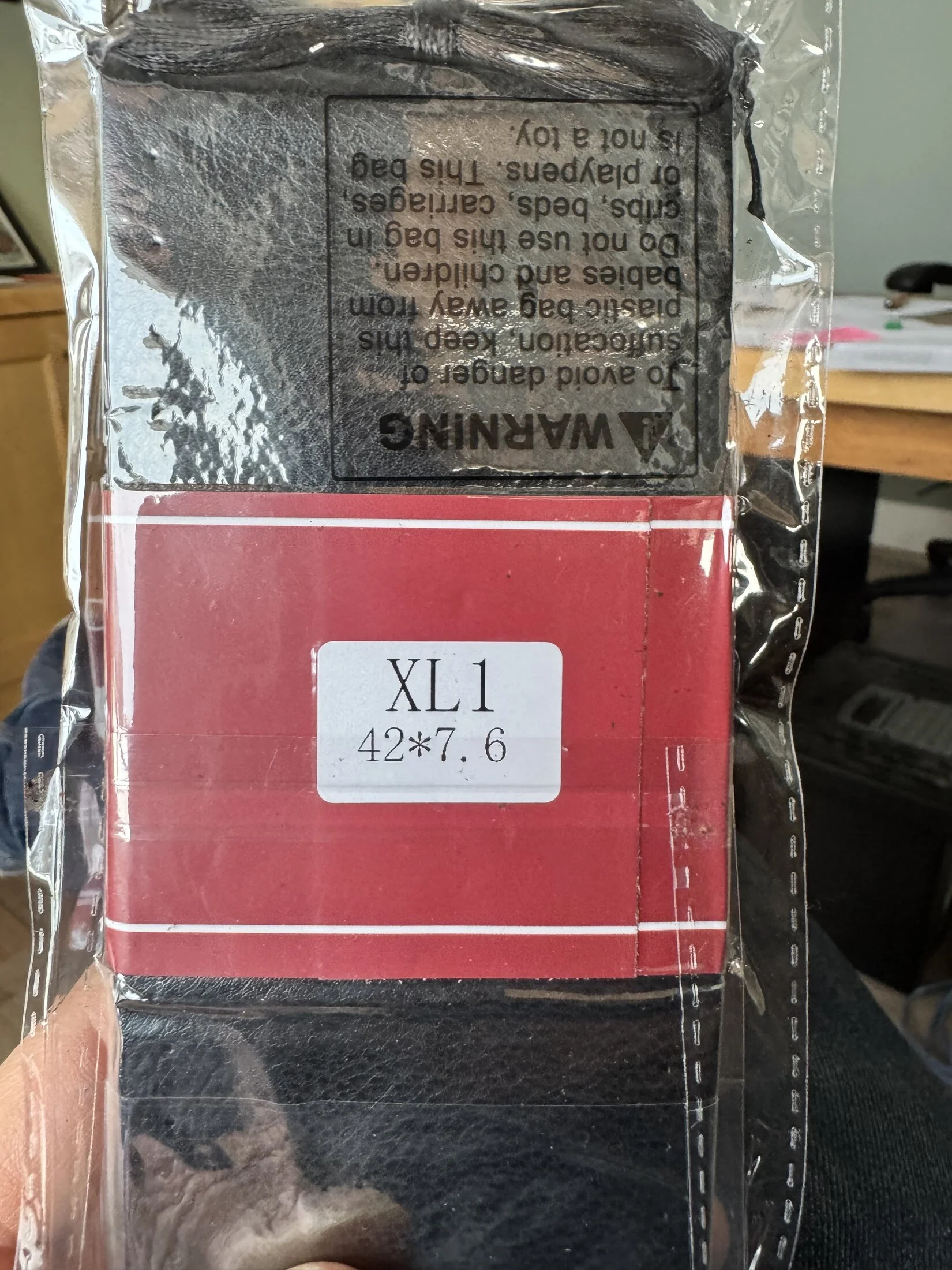

working on my steering wheel while watching hockey! good saturday afternoon!! this was a cheap wrap and i was very worried it was the wrong size as it felt too small but it’s actually fairly stretchy and is a perfect fit.

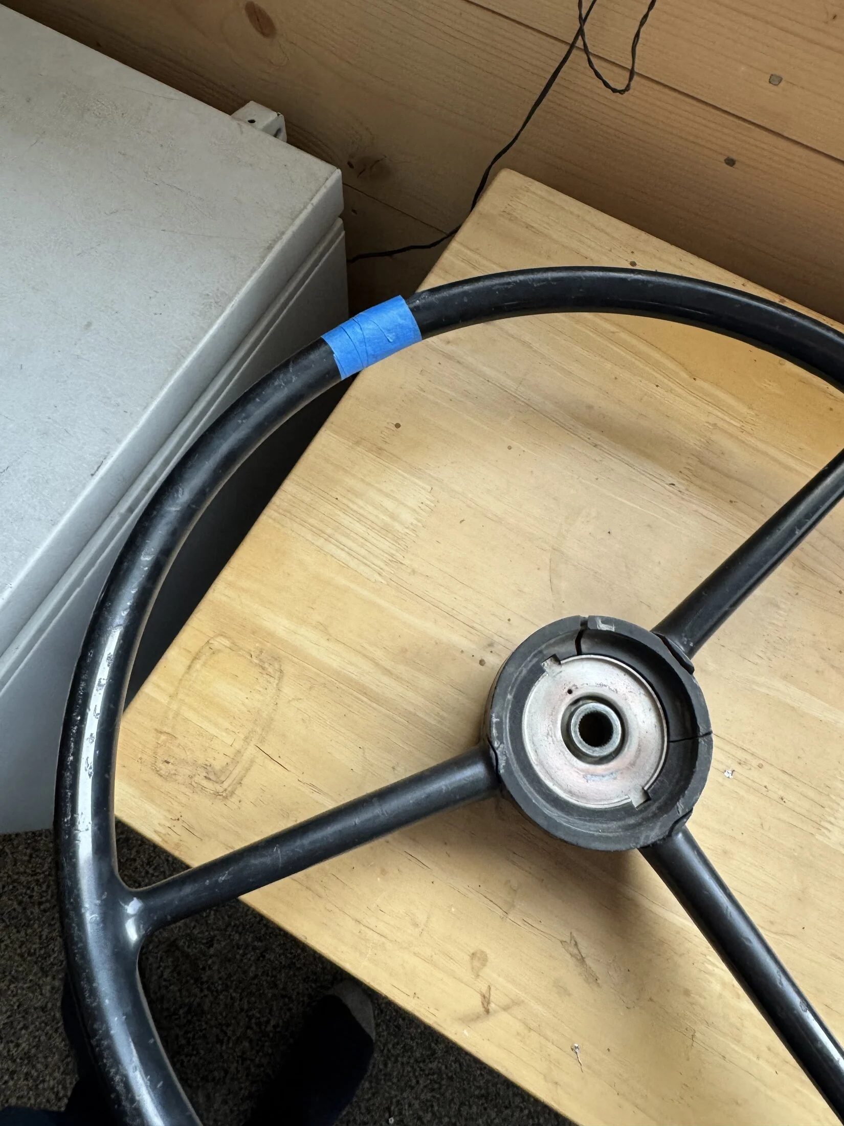

did a little epoxy fix. more to come on the hub.

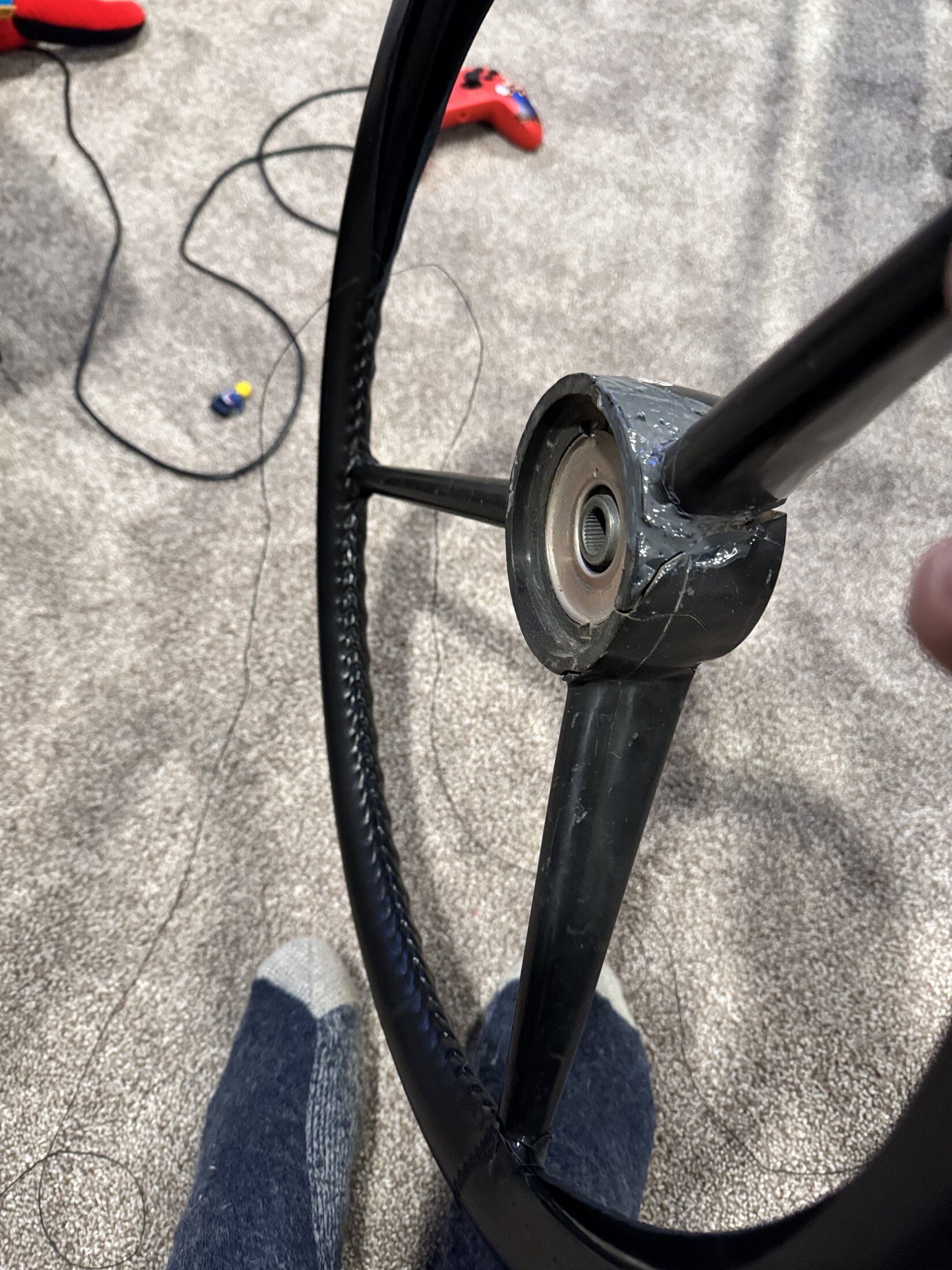

well that took about 2.5 hours and a couple small thread cuts but i’m really happy. i was so tired of the rough cracked wheel that the plastic is breaking down on. it’d leave black on my hands in the hot weather. this will be way more comfortable. it’s a bit of lipstick💄 on a pig🐷 as red isn’t a fancy vehicle but what ever. it’ll make it that much more pleasurable to drive!!
i’ll finish filling and sanding the cracks another time. i need to drive again tomorrow!
@franklin40 That is the correct fitting steering wheel cover…. @Aloha Jen sent me the size and it fits very well. The initial order I place with Amazon was 15” sent that one back
View attachment 3793216View attachment 3793217View attachment 3793218
wrap looks great!
yes i can confirm that it’s indeed the correct one! it just feels really snug when first stretching it on.
