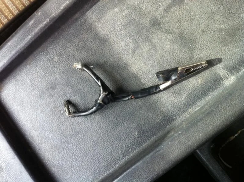

The doors were all unlocked so I opened the door and everything seemed fine. Then I looked at the steering wheel. There was the tell-tale sign of how they started it. Hot-wired for sure. My hunch was confirmed when I found their little home made tool.
YouTube - Recovery of my stolen FJ60
Here is what they used:

• How they got into the truck without breaking a window, prying the door or slide hammering the tumbler had me wondering. Then I came to a realization. I locked the driver's side door when I went to my kids soccer game. When I went to open it I just used my key instead of walking over to the passenger's side like I normally do. I just wasn't thinking anything of it. Well if you notice I have a different beige door on the driver's side. I don't have the key for it. But my key worked. Not right away but I had to jiggle it a bit but it unlocked. That's when I realized it was the wrong key for that door. I unlocked the passenger door. No problem. Opened up nicely. I looked at the key and noticed that all the bumps on the key were well worn. So I confirmed this by grabbing the keys from my 84 FJ60. Low and behold!!!! It took awhile but son of a bitch, I could open the door with that key too! This worries me!!! So how am I going to remedy it? Well I can replace all the locks with a fresh set with a new key. That is really the only way around it. I won't do it on the 86 but I will on the 84.

• Finally how to prevent even the hotwire. Well whoever stole my truck wasn't a complete a****** because they didn't just strong arm the steering column with a prey bar. They carefully removed the screws and the two plastic surrounds. So there are two options here: 1) Make a plate that covers the back of the ignition switch so that they can't get access to the solder points to use as a jumper. 2) make a metal enclosure that replaces the steering column surrounds. This could actually be relatively easy to manufacture and to top it off I would cover the ignition switch bezel so that they could not use a slide hammer to remove the ignition tumbler.

I am sure the little roach clip had prints all over it. Fxxxing jackwads deserve to have a boyfriend in Jail. I have dealt with Brufy's in the past as well that is why I call them apes!
