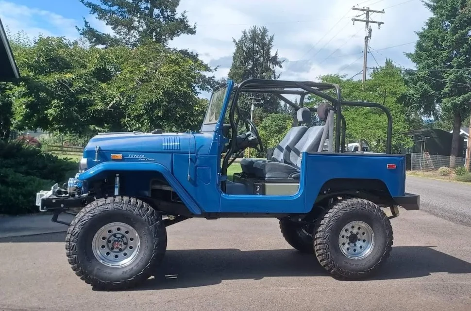

Hello All,
I have a 71 FJ40 with a 2UZ and an H55f on 35's. The truck drives fantastic but 5th gear is almost unusable, nobody needs to go 100mph in a spring over 40! The current ring and pinions are 4.10. What would you recommend? And since everyone likes a picture...
4.88s is what I'd do.
