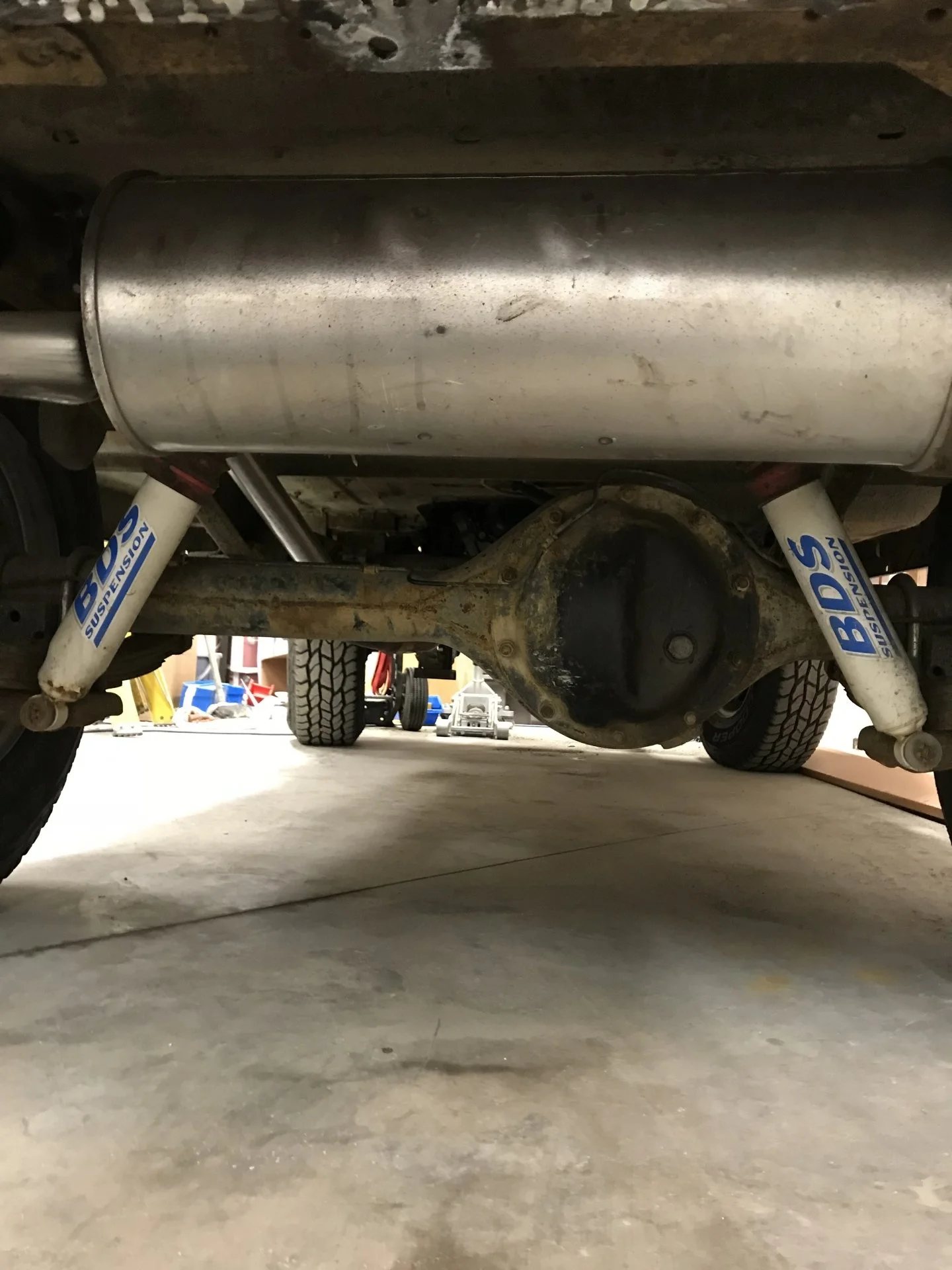

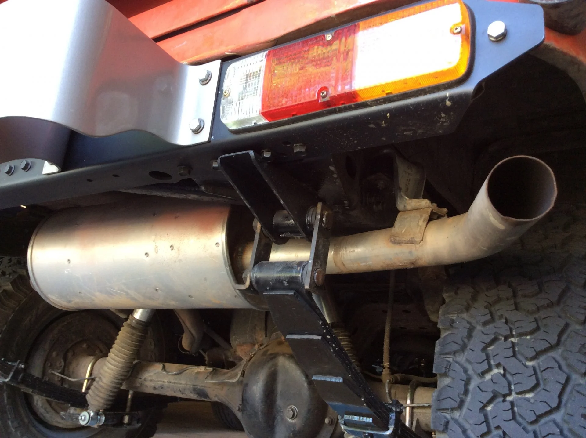

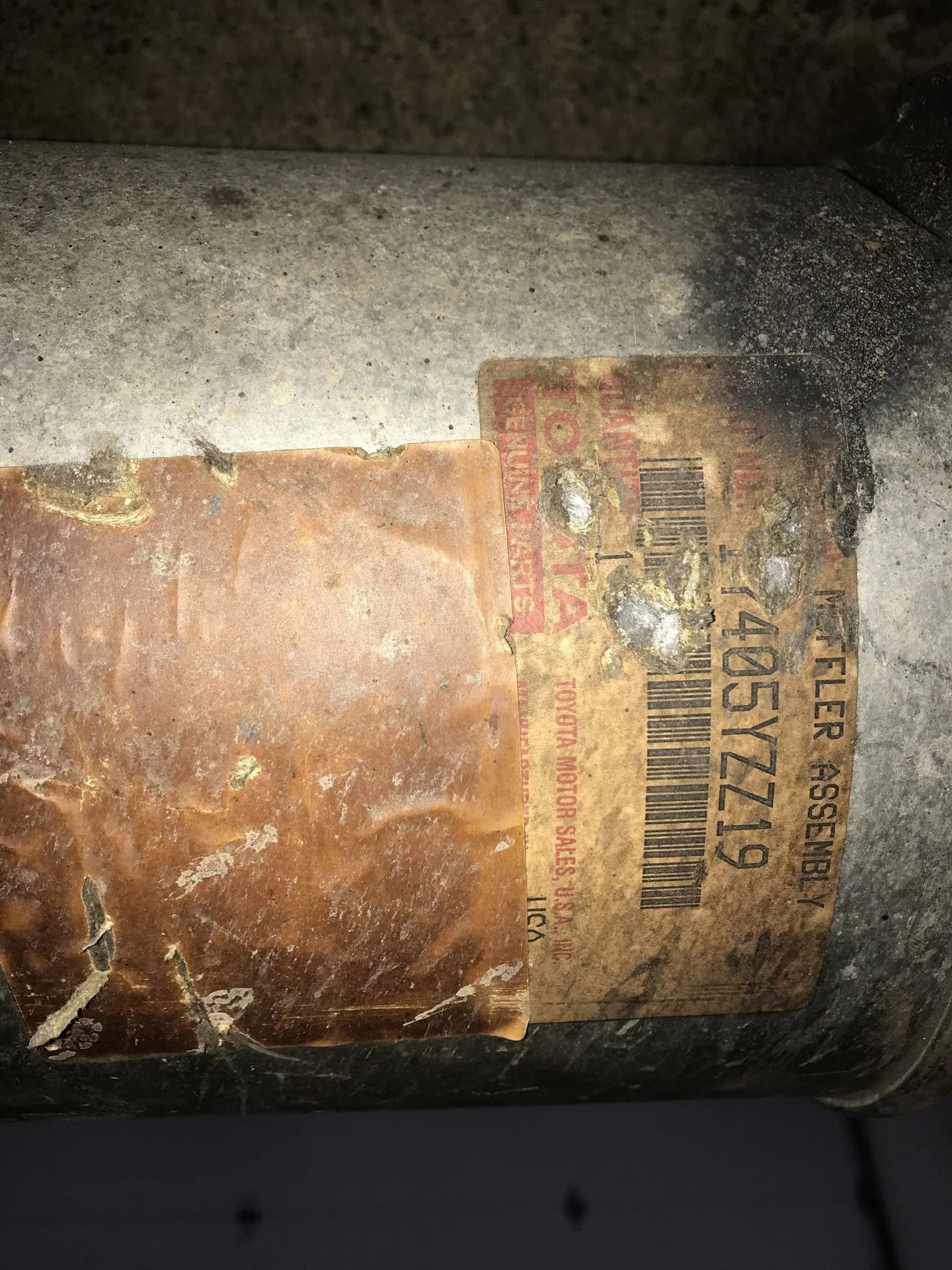

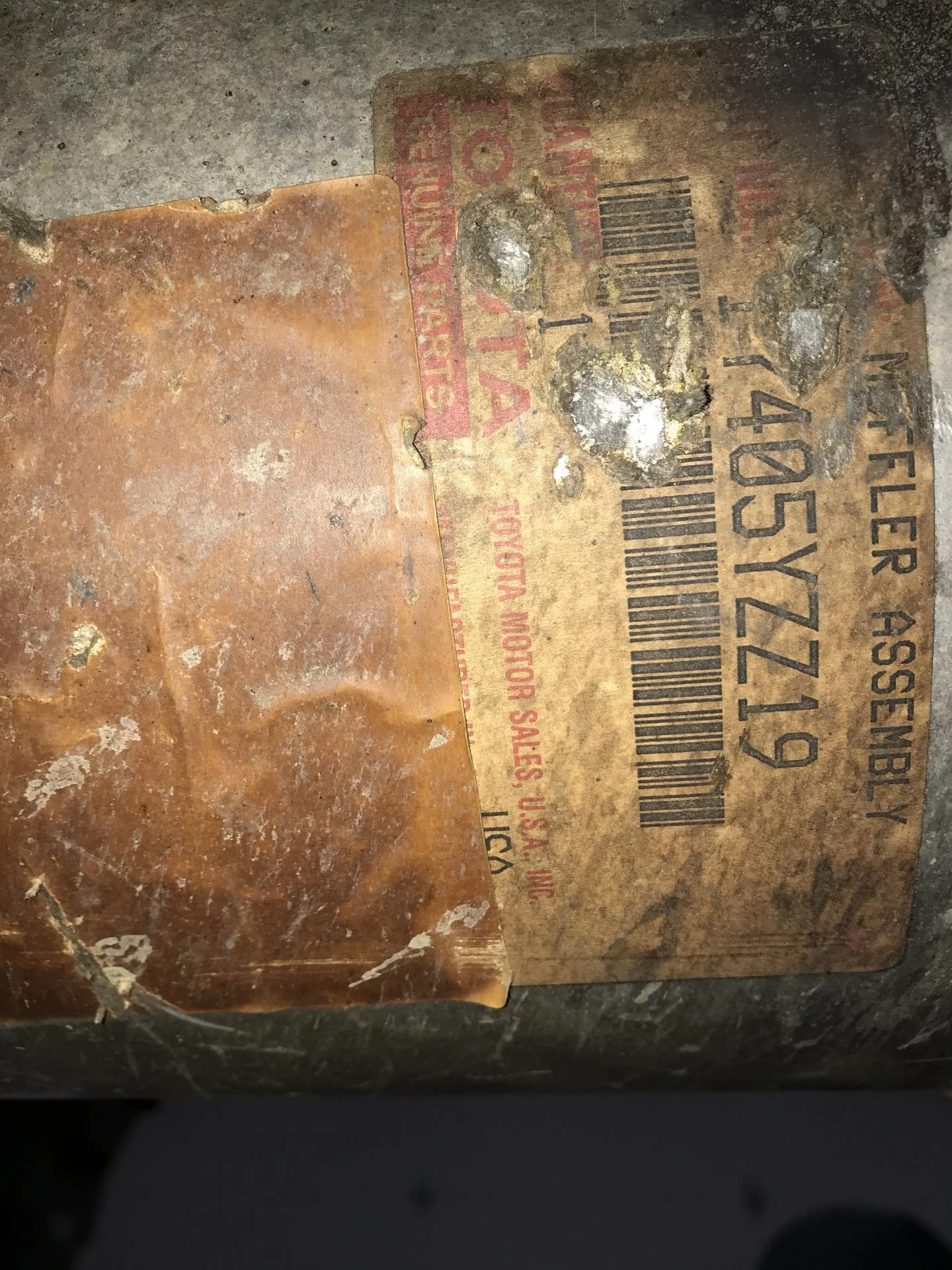

Your muffler is not in the stock location for a 78. 74 was the last time that location was used. While the stock muffler is NLA for a 78. The 79+ was still available last time I looked. Not too hard to difficult to get to work in a 78. The stock location is behind the rear axle and muffler is parallel to the axle and exhausted out the right side. While still round muffler is much larger.
Any offset muffler will be quieter than that straight through jobber you have now. And yeah, reorient it properly for a 78.

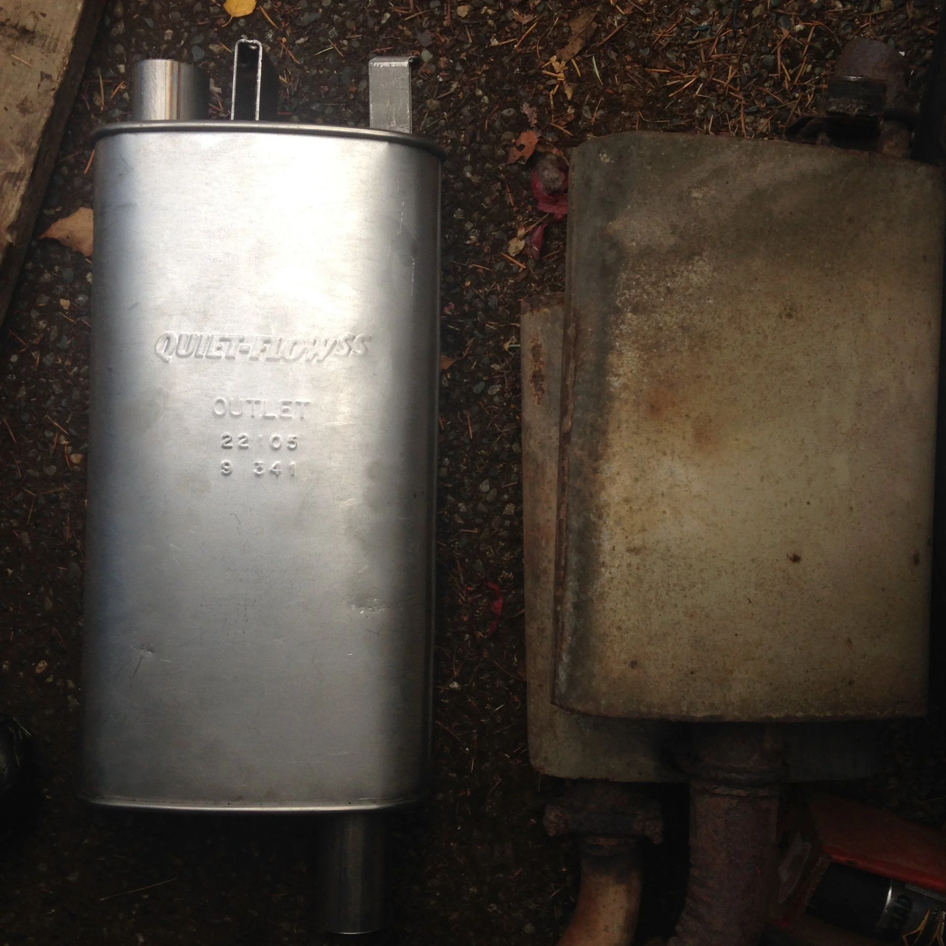

I’ve got a SS Walker Quiet Flow Muffler. Although I’ve got a V8, I’ve had modern cars beside me on the road that are louder. The transmission is much louder that the muffler. Even at WOT, there’s hardly any exhaust noise.
The same can’t be said about intake noise. It was quiet with a stock air filter housing… but somewhat anemic. With the open element air filter it’s way louder than the exhaust.
There are sound clips and PNs in my build thread below. It was a stock replacement muffler for a V6 or V8 Chevelle.
