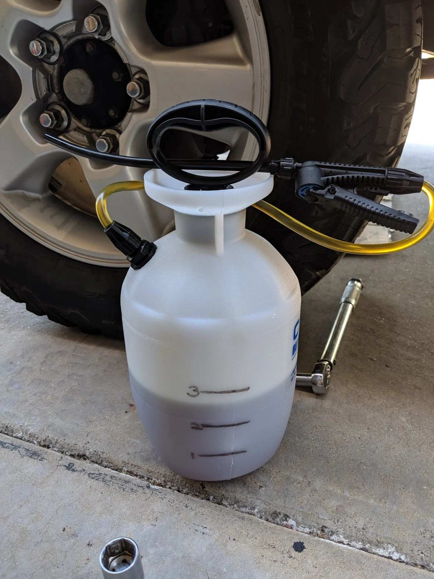

I wanted to know if anyone had a recommendations for gear oil Transfer Pump that will make the job any easier? And other tips?
+1
Exactly what I did.
Genius. And surprisingly simple. Can't wait to try this on my next gear oil change....I knew 10 minutes of morning 'MUD would be more beneficial than the morning news.
It definitely makes filling super easy. I hated struggling with those 1 quart bottles.

I am about to attempt to change my Transfer Case and Differential Oils. And I have already purchased 7 Liters bottles of Mobile 1 synthetic 75w 90 GL5 gear oil. My new plugs and crush washers from Wit's End are supposed to be here today.
I use this.
Amazon product ASIN B000BQW5LK
^^ the pump above fails often. I am on my 3rd, sometimes it wont pump. I think the best is the 1 gallon pressure pump sprayer as stated above. I can see the cleanliness of using it even without using it. Does HF gallon pump do the job? I bought a gallon for my dad and he said the O-ring failed within 2 months of use.
