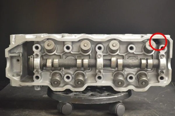

Hi , this is exactly my problem also, do you have any pictures , photo or diagram to show that screw or nut and his position ? , Thanks in advance for your help !
Best photo I could find:
There is a large "hole" here (circled), that is a return galley for all the oil that gets pumped up to the head. This is on the passenger side. This is one of the 2 places where oil runs back down into the pan by gravity (the other is the large hole for the timing chain). There is not supposed to be anything in that hole, you could easily run a long skinny rod down that hole and it would reach the pan. I've never had it happen, but I can easily see how someone could accidentally drop a nut or bolt down there and not see it. If that hole is blocked, then when you go up a steep hill you would have a big puddle of oil collect there which would get sucked through that #4 intake valve stem seal.

Perfect and clear !! I will do the job ! Thanks again
