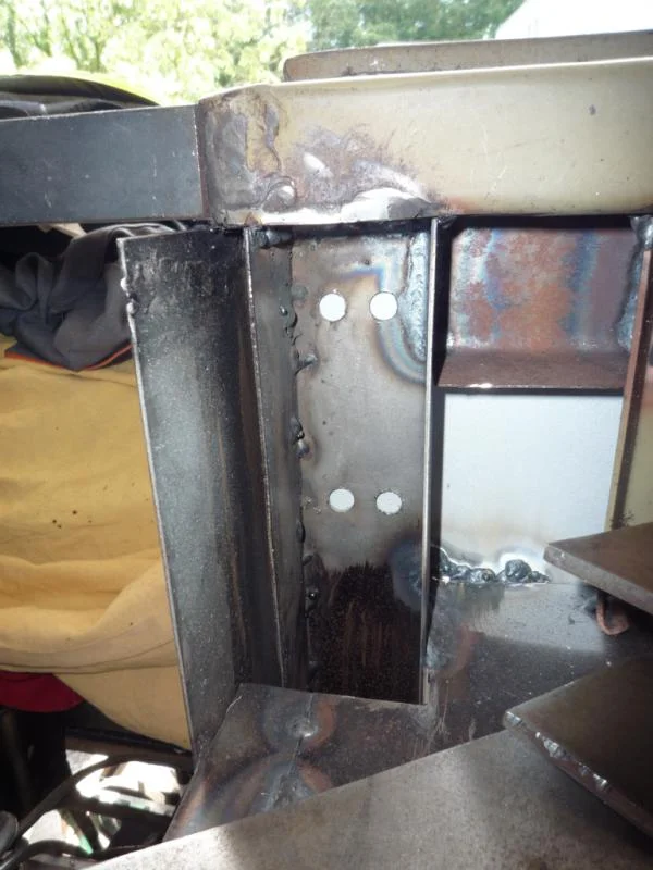

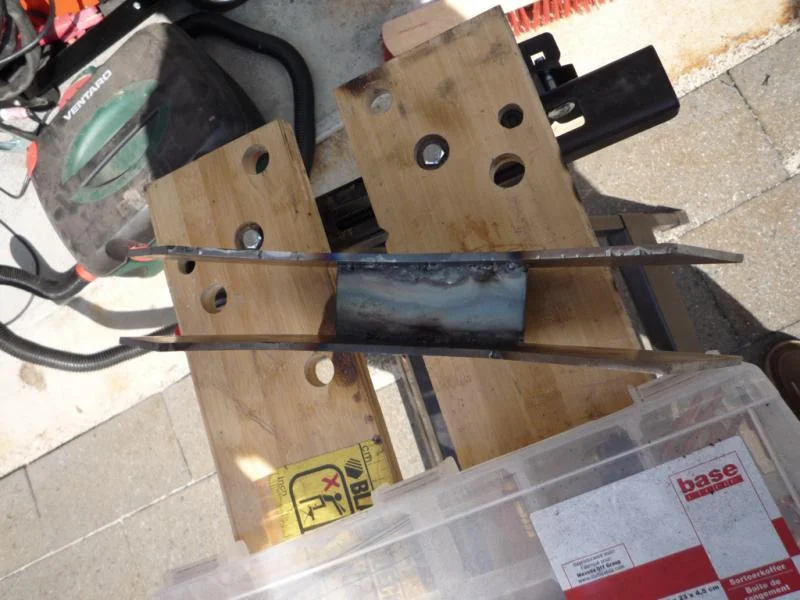

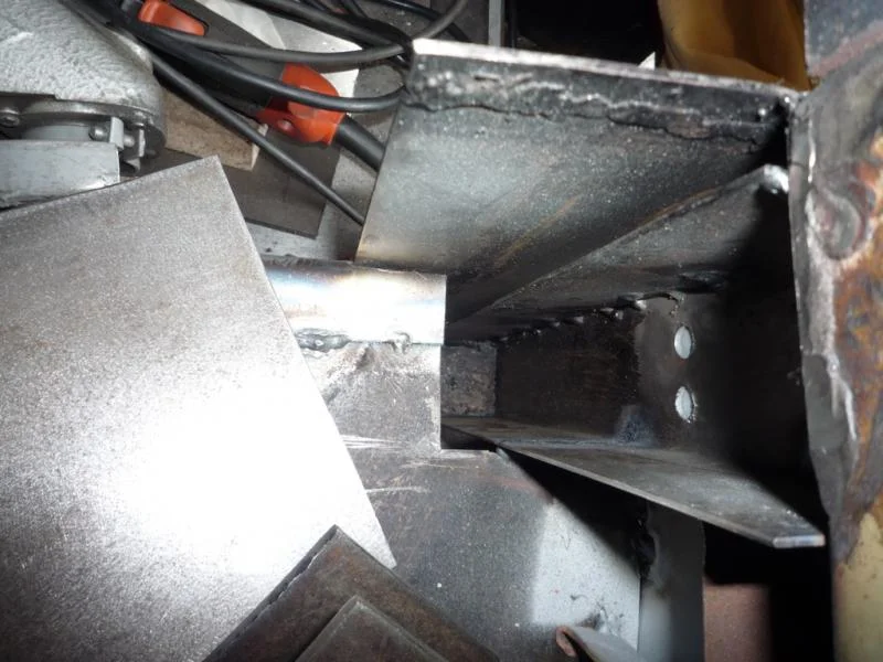

Worked on the support for the cage and the hinge treads.
Sent from my iPad using IH8MUD
And to finish the inside of the C pillar.

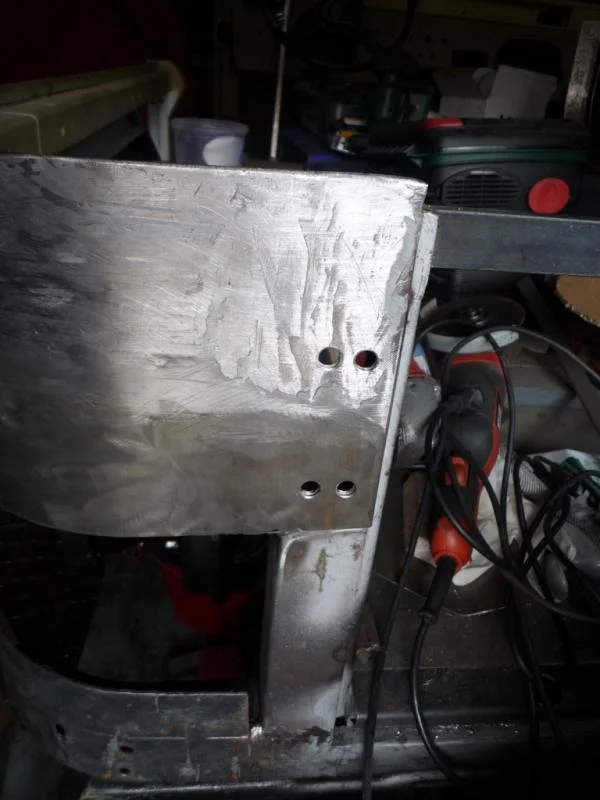

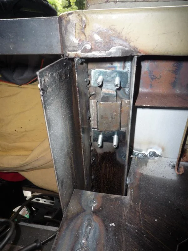

I plan to weld some nuts on the inside of the door opening so I can mount a frame to use barn doors for when the top is is off.
your welding skills and PATIENCE blow my mind...looking good
I'd try to make the door hinge nuts captive instead of welding them. Having removed and installed my old Hard top many time I appreciate why Toyota made them that way from the factory, that little bit of play helps a lot when you are lining things up.
I know but this needs to be in there very solid and will pull in the direction the play will be.:confused: this sounds strange when I see it.
I plan on fabbing brackets that fit tight in the door frame of the tub and are attached to the original hinghe point and the welded nuts. So the hinges will be attached to these brackets, so the weight of the doors is going to pull from these nuts.

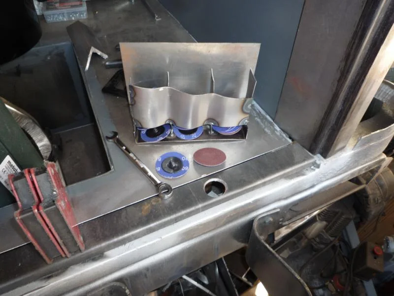

So I decided to do some cleaning in the garage and made a dispenser for the pads that go on my new 2" grinder (thanks for the tip Kevin aka Awl-teq)
Found a spot on the wall to mount it.

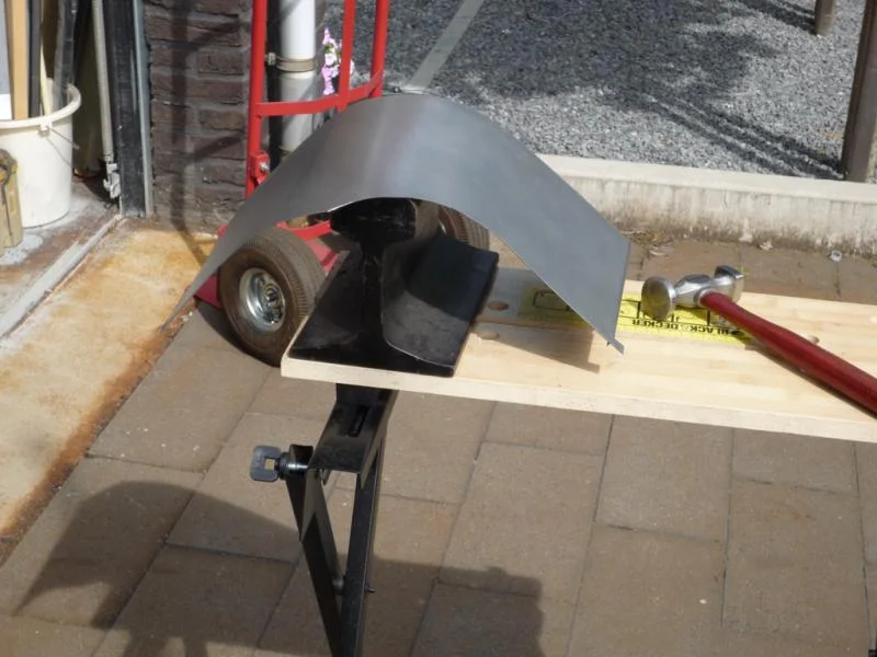

Sorry if you covered this earlier in the thread but how are you forming the radius on the flat corner pieces?
I have a peace of "trainrail" Anvil and in this case the curve of my big silent hammer.
I just bend peace by peace until the radius is correct.
For the rear corners I use a peace of cardboard I traced from the upper rail.

How high is that piece of rail? I'm going to have to try to get a piece myself. That is just what I need to finish off my rear tub.
I'm sure you've stated previously... But how thick (gauge) is the steel you're using for those corners?

Now that's a nice tip on bending the rear corners. I've been thinking that I could probably figure out how to hammer a decent lower lip on the rear quarters, but I've been wondering how to get a clean radius. I've got a 12" section of that RR so I'll give it a try with some scrap tonight. Hmmmm, now I can't focus on work. :rolleyes:

Its about 25 to 30 cm high.
I use 1 mm steel plate and bend by hand using the anvil as base.

The lower lip is a straith strip bended 90 degree and then schrunk and stretched in to shape. I then welded it to the bend corner.
