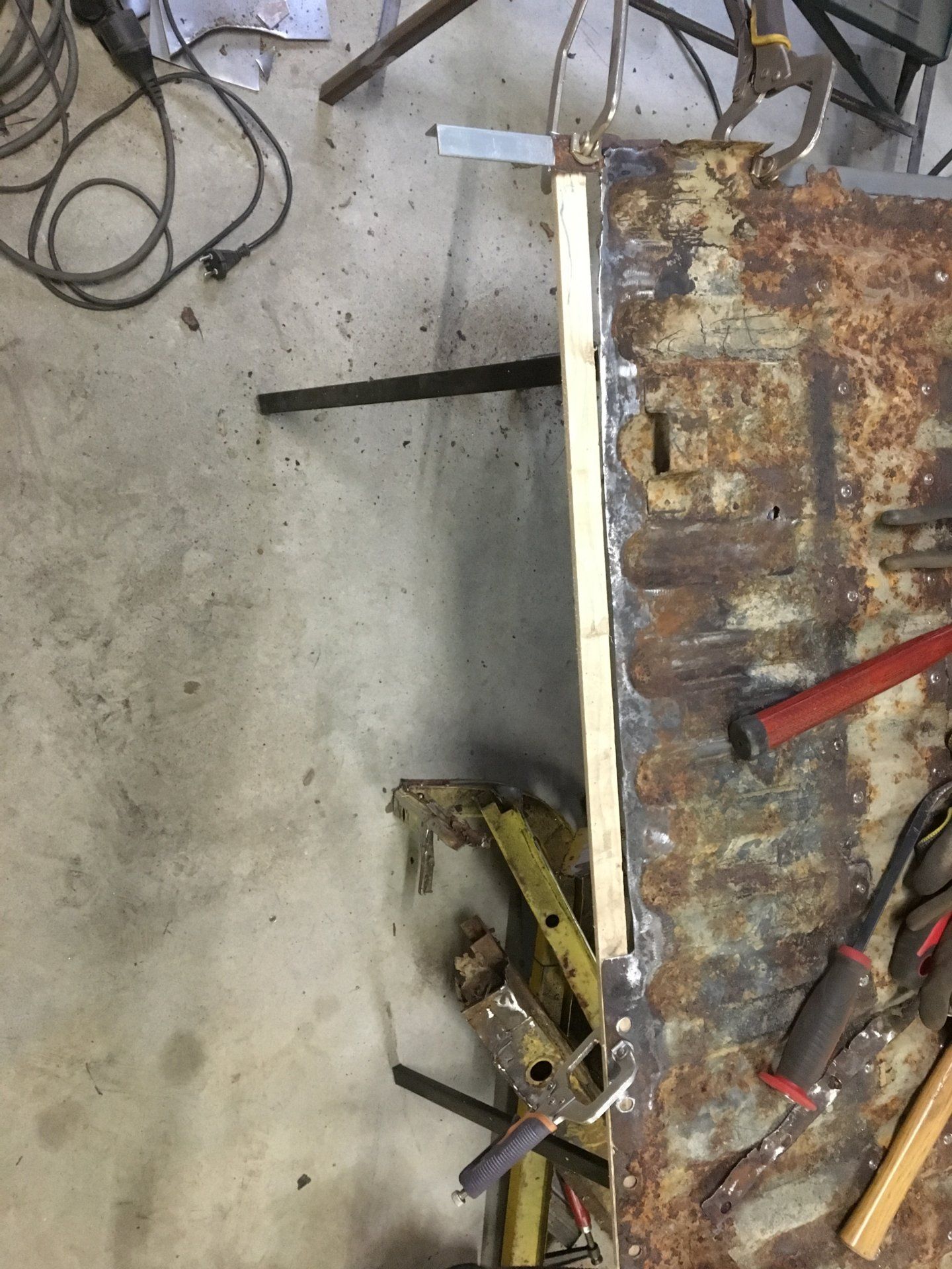

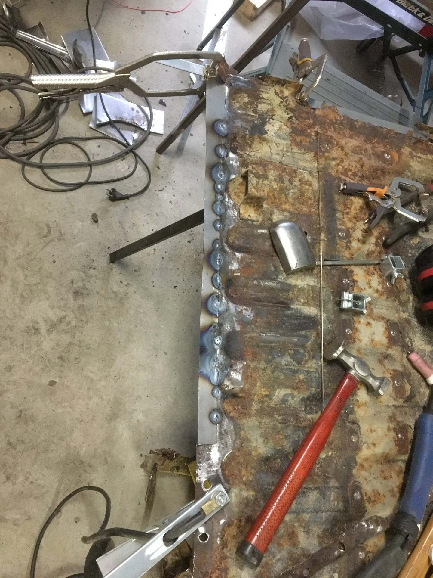

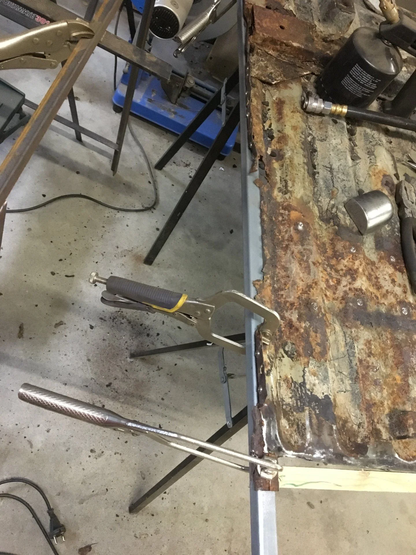

Dismanteling the floor

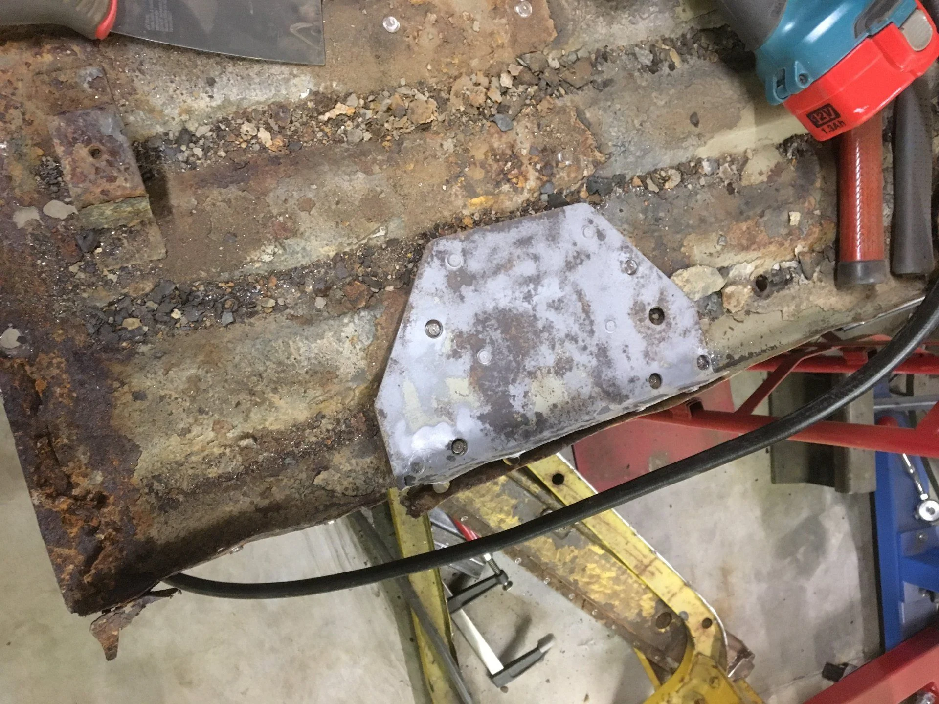

Set out the lines for the patches
Side of the floor needs a bit more forming of the patches
A bit of rough welding.

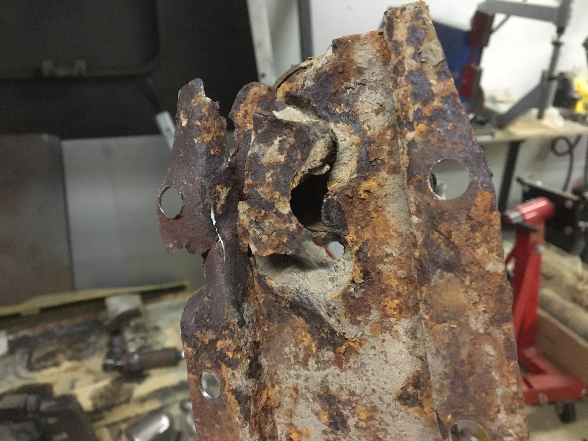

Something like that, or I’m to cheap to buy new parts.
It’s not as bad as it looks. Just some pieces are rottrn away but nice clean steen next to it.

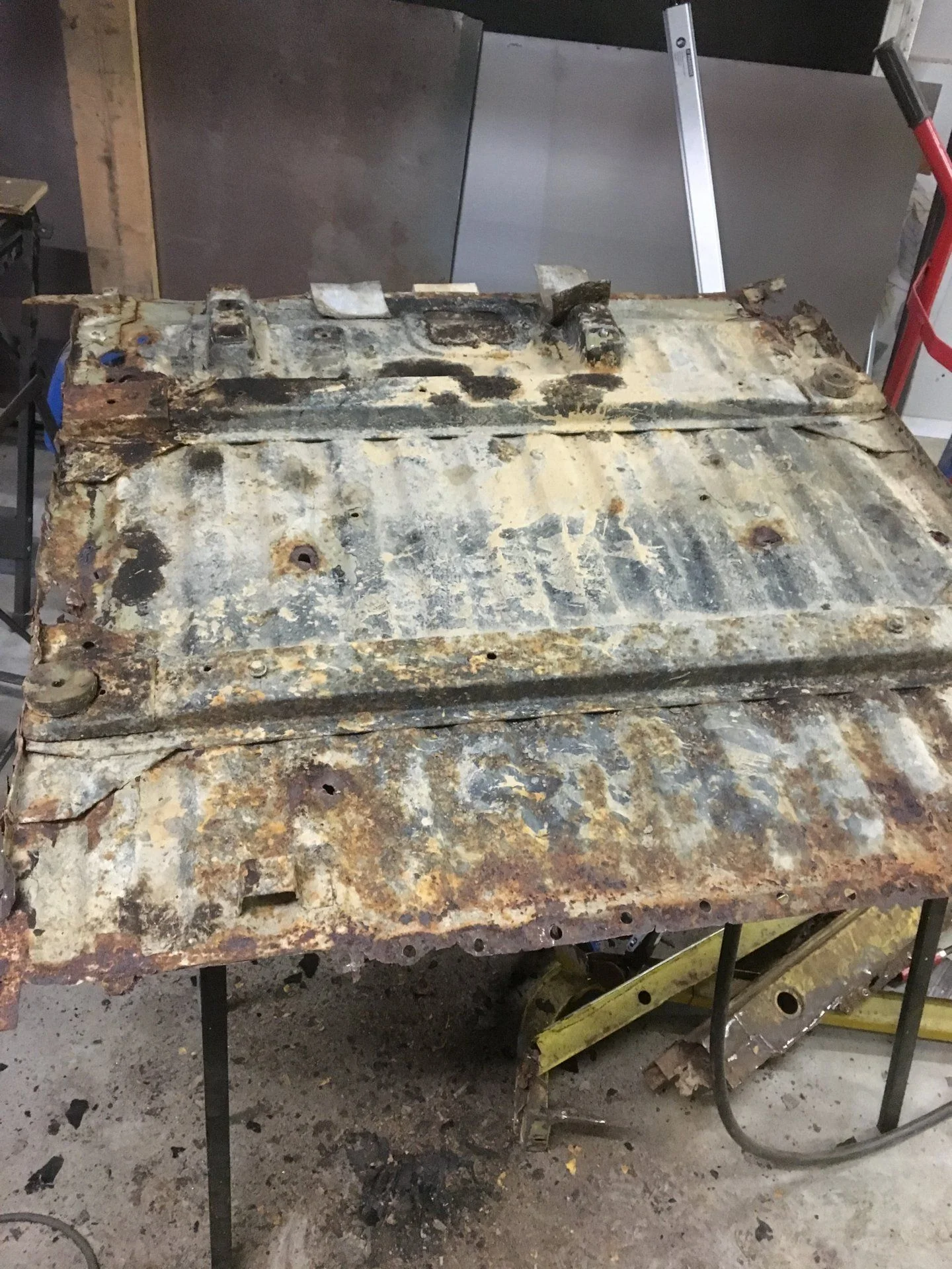

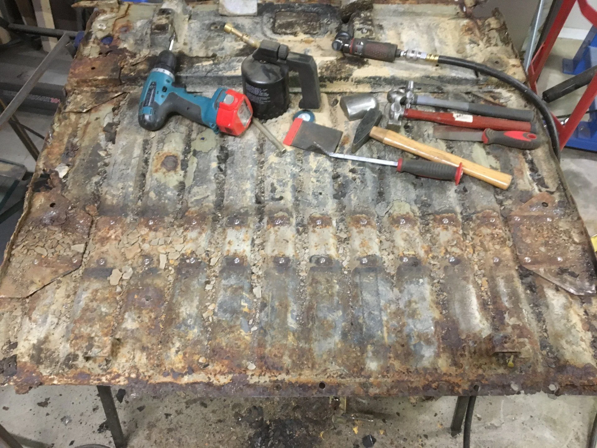

Still working on dismanteling it, not sure if I can get it back together again.
I was just thinking that it's a good thing it's you and not me... I would have the fenders inside the cab and the hood and roof swapped...
I am curious to see if you can get it all back together... I don't believe I've ever seen a "complete tear down" restoration.

Thanks Danny, I hope I didn’t bite more than I can chew.
It kinda spiraled into a full tear down, but on the other hand what is the fun in buying a new tub when you want to learn new things.

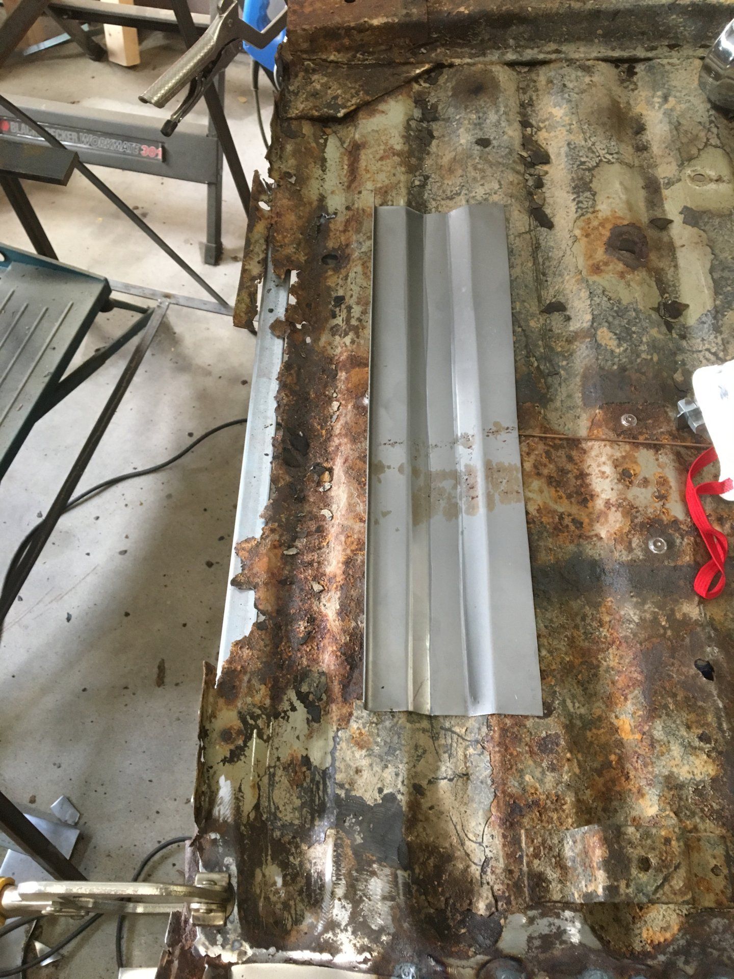

I just finished reading this whole thread and it's one of the best restoration write-ups I've ever seen. Looking forward to more, and I'm kind of hoping you'll make a video showing how you got that perfect curve on the fender patch!
Thanks for the props.
The bend was made using the English wheel for the first curve and then manual bending untill fit.
