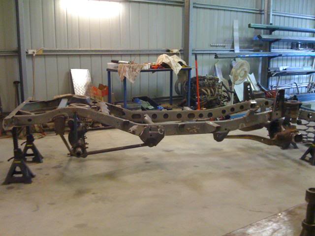

The following photo's & explaination have been taken & written by Brooksky.
Basically the customer is currently using his 40 but wants a chassis that is running coils so when the time comes that the current leaf configuration gets a bit much he can then drop his parts onto this chassis.
Now a couple difficulties that are a bit out of the ordinary but it is what the customer would like so I am happy to accomidate
We are sticking with 40 diffs & the wheelbase is being restricted in certain areas so the custom fibreglass body won't need much modifying to make the swap easier. I did have 1 issue & that is the chassis that the customer bought was already galvanised which made for some headaches with cleaning up, bolts being fused in & galvanising being built-up in every nook. It took a lot more time dressing down especially where parts needed to be welded on as you need to make sure you grind down below ALL the galvanising to guarrantee a good quality weld.
So here are a couple pics for you all just to show how things have progressed.
I forgot to get pics of the 80 series chassis that was the donor for a lot of parts to make the job a little less expensive. Also the diffs in there strip down stage & completely cut & ground clean ready for coil brackets & mounts.
Chassis in it's bare state with most old unwanted brackets & mounts cut off.
A lot of tapered cutting was required to get true fitment of coil mounts as some of you will know the 40 chassis tapers out in width basically from the firewall all the way to the very rear crossmember/bumper.
Lower trailing arms chassis mounts. Ignore the writing as normally under an 80 series these mounts are flipped but due to the width of the 40 chassis & still being able to maintain the diff mounts on the 40 diffs without being too wide I mounted the brackets like this to maximise suspension control. The chassis tapering out plus the mounts allowed the trailing arms to have some triangulation, not much but some which certainly isn't a negative.
On to the front & this is where it gets a bit tricky due to the 40 housings. Trying to have enough room on the drivers side for panhard bracket on chassis, idler arm clearance & mounting a steering box (either 75 or 60 series). Also having clearance on hub steering arms & idler shaft from radius arms & on passenger side panhard bracket indiff housing. The other issue is the diffs aren't wide enough to match the coil perches on the chassis so the diff coil hats are 10mm inboard on each side. I am going to have to modify internal bumpstop as I think it will fowl on the coils but I think I have a fix for that. Getting the right caster is also important so I could set-up coil & shock mounts & more importantly radius arms. I solid mount the diff housing into position. I have used some RHS box as my datumn for all measurements on the front of the chassis once I was happy with it being true.
Anyway here are the last couple pics
