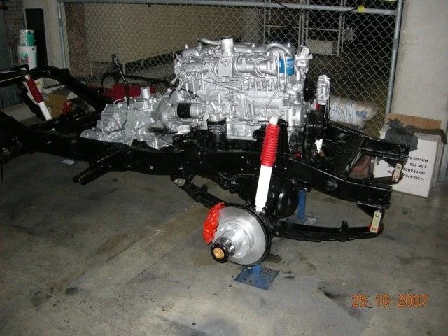

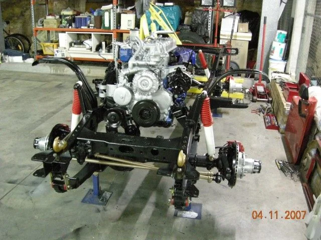

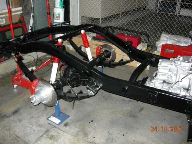

Well its been just over 2 months and I have striped down my FJ40 1974 to the chassis, sandblasted, hot dipped in gal, etched primed and painted black.

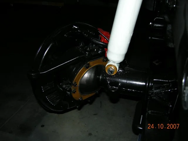

I got hold of a FJ40 1984 front axle and completely rebuilt the front hubs, diff, new rotors, seals, bearings etc, the CV's have been upgraded to a harder steel with 60 thou oversizes ball bearings. The caliphers I have also completely rebuilt as well as the Asin's.

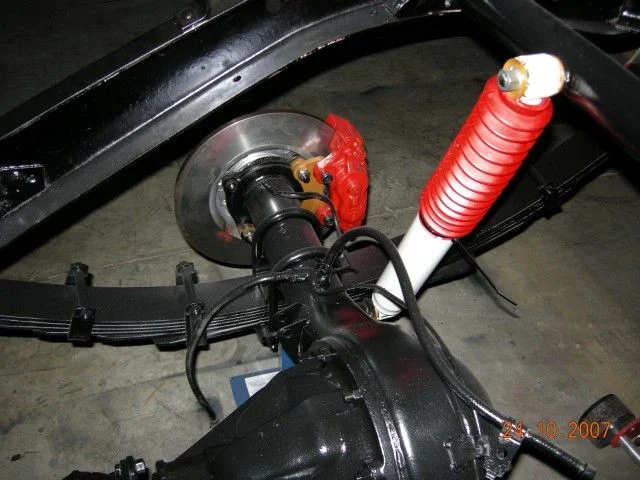

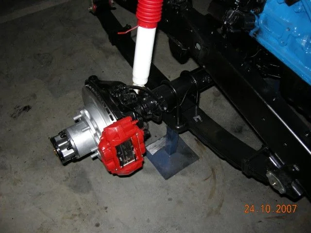

I also got a FJ40 FF rear from a 1984 and rebults it also. Took off the drum brakes and intalled disc brakes, again a full rebuild. The caliphers are from a HiLux 1984, they are the same as on the front (which are standard) except these only accept a solid rotor.
The springs are OME Dakar all round with Rancho 5000 shocks.

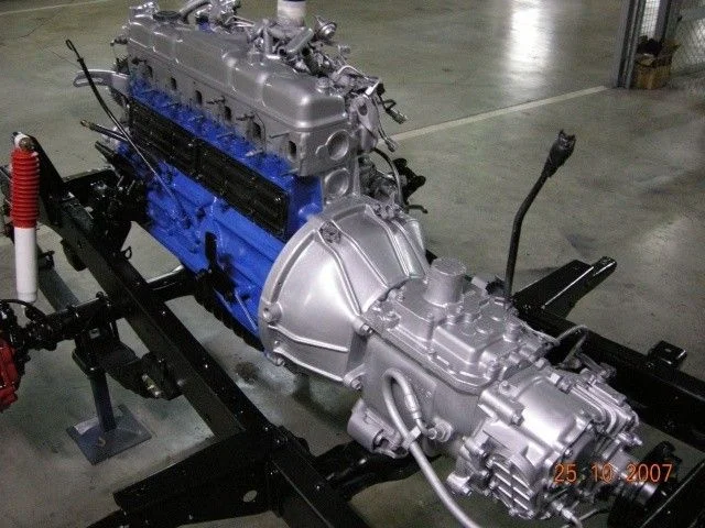

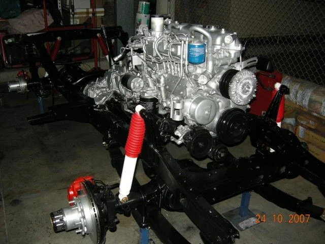

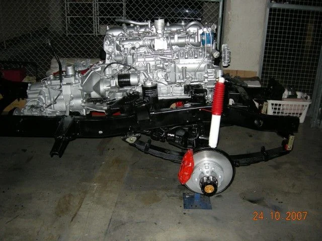

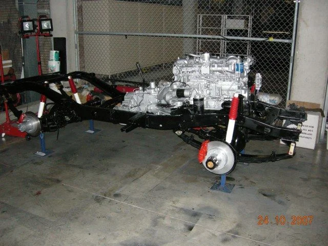

I then got hold of a 2H diesel from a HJ75 1987 model as they came with a PS pump & triple harmonic balancer. The 1984 troopies came out with this motor also but no PS pump ( and only with double harmonic balancer).

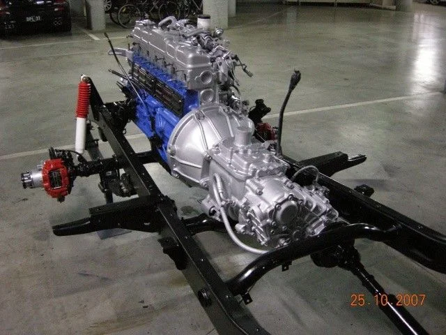

Now the engine mounts on the chassis in a Troopie are in the same place, that is right up the front of the chassis the same as a FJ40 1974 model, all I needed to do was track down some engine brackets that bolted onto the engine block from a troopie. If you use the engine brakets from the HJ60 or HJ75 it drops the engine down to low. I also used the 2H bellhousing and a 4 speed to match.

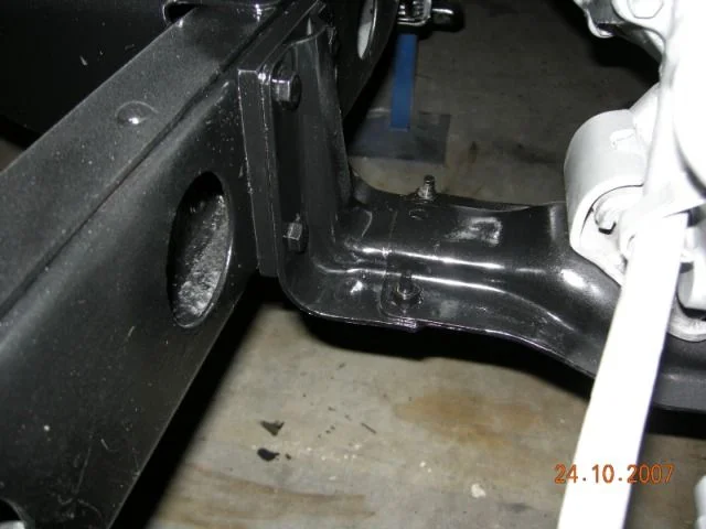

The last thing I also need was the cross member to bolt onto the chassis to mount the 4 speed and again I got this from a troopie

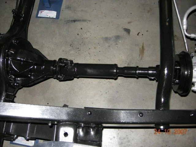

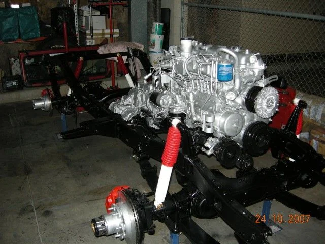

Last photo. The propeller shaft's have been rebuilt with longer yokes from a 60 series as the OME Dakar springs give me a lift of about 2". The front leaf springs are rated as medium's as the 2H Diesel with a 4 speed is a fairly heavy motor and the rear springs are rated as light's.

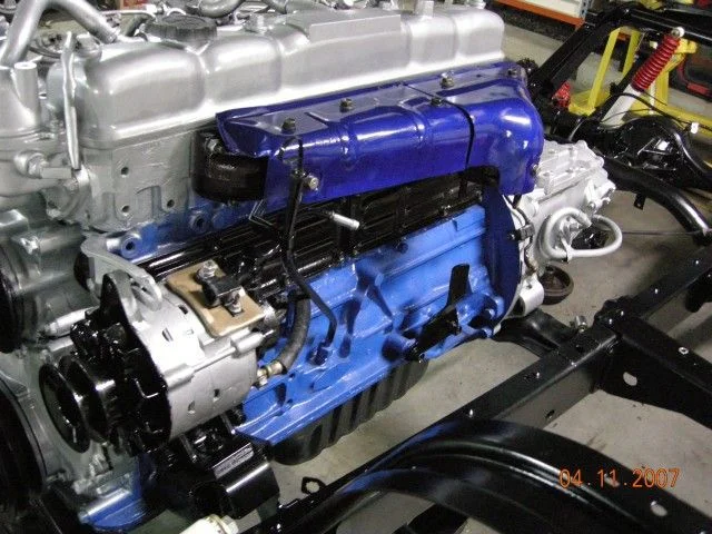

Well I did a couple more hours on the FJ40 or should I say HJ40. Got the exhaust manifold and cover on as well as the alternator with vac pump. Also managed to get the guard brackets on as well.
