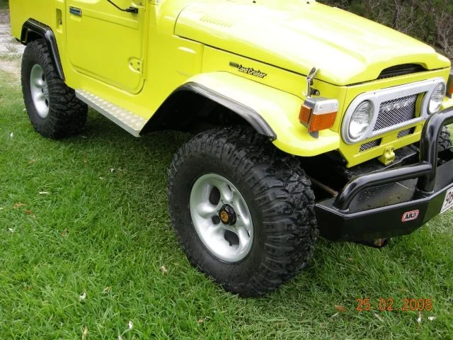

Hey Brisveg,

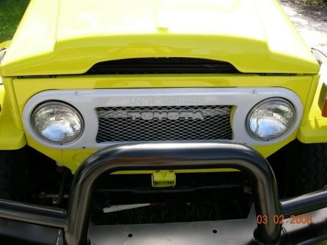

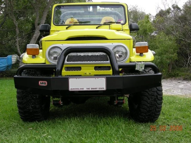

Do you think those Hella 4000's would fit in the middle of my ARB Bull Bar?
yeh sorry rob missed this one..
is this a pic of your ARB bar? and would you attach them using those holes on the base of the bar not on the hoop?
https://forum.ih8mud.com/attachment.php?attachmentid=207249&stc=1&d=1202044047
If your using those existing holes i reckon you'd be VERY pressed to make them fit.. I can measure mine when i get home if you want?

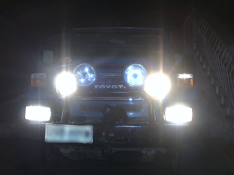

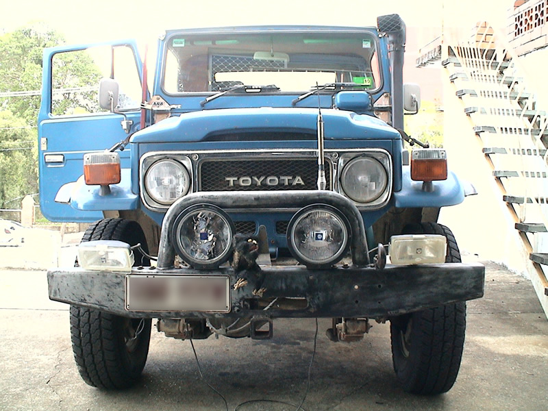

Here are a few pics that might give you an idea on how they sit.. use the headlights as an indication on how far they are spaced apart.
looking closer at the pics you might get away with it. have you bought the 4000's yet? have you considered the compact 4000's?

I read somewhere on the forum that you can get 2 x 8" lights in there, what do you think the diameter of the Hella's are?

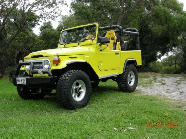

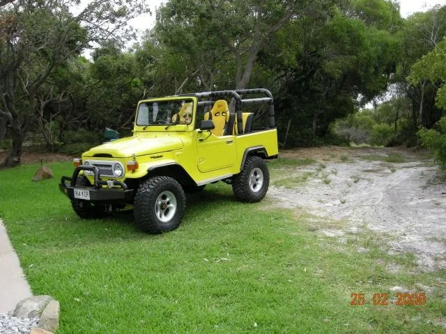

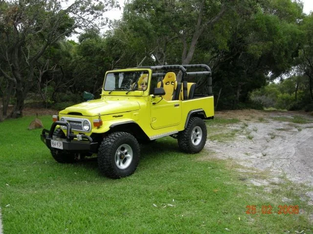

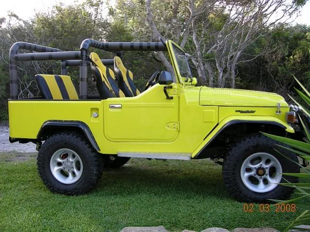

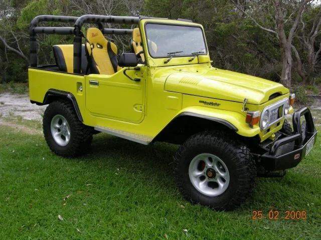

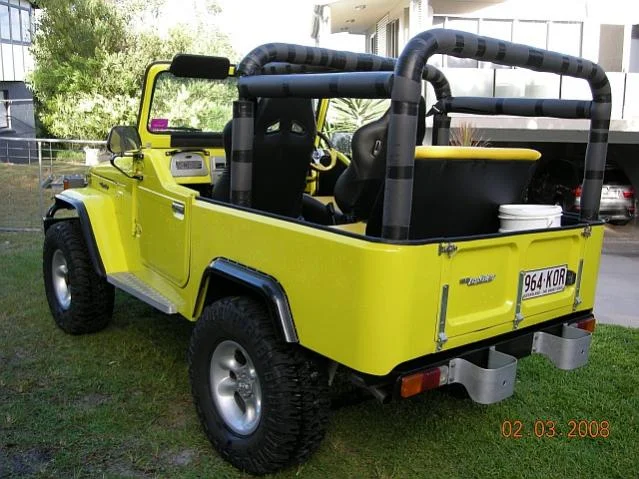

Ok, my rebuild is just about officially finished.
I fiited my 16" alloys & 33" tyres over the weekend. Also fitted one and half inch spacers all round to bring the wheel track into line with most other 4x4.
The reason for the spacers is when the beach gets cut up with all the other 4x4 it is now easier to follow there wheel tracks without getting thrown all over the place.
It also makes the FJ handle better with wider track.
Now I can get the last item and that is driving lights.
The reason for the spacers is when the beach gets cut up with all the other 4x4 it is now easier to followthere wheel tracks without getting thrown all over the place.
Ever considered 60 axles? Apparently they have the wider track, by something like 70mm, which is about what youve done with the spacers.. I want a 60 axle in the back of mine, but I also want RDB, so your disc brake bracket solution seems the way to go, but then I dont get the backing plate like I would if I had the earlier 40's backing plate bolt pattern and used cut knuckles and 60 bits.. There is always a compromise.. Very inspiring build, top job!
I looked at the 60 series but it gives you a little to much width. With the spacers it gives me a total of 3" then with the back spacing on the 16" alloys I used which took back an 1" I did not have to worry about the wheels protruding out passed the guards.
Also its getting a little tricky with Queensland Transport as the 60 series axles is past the their allowed width limit for the FJ.
It seemed the best compromise.
