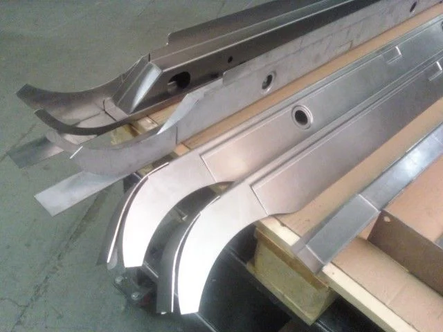

check out the following photos from a Mud buddy of mine awl_TEQ you will see that the late model sills that he sells leave a lip to lap weld over

That would be my Marketing Manager, hedgehog23. Hard at work as usual. :beer:
