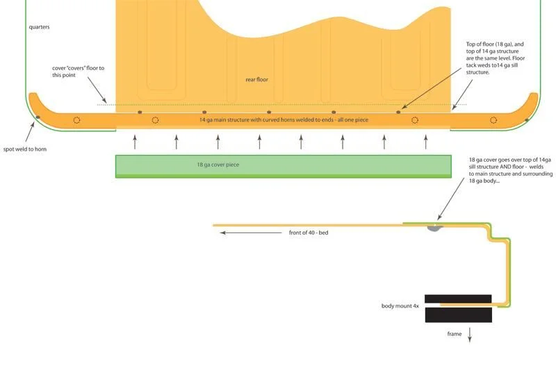

Rear sill vs floor panel
this picture might help depending on year
to be honest its not my picture. but i did save them from a member of Mud. i have a few more but judging by the mounting hole locations this drawing isn't for your year. many things might be the same though

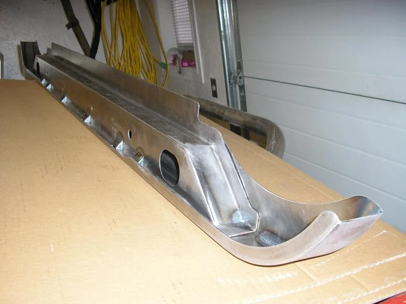

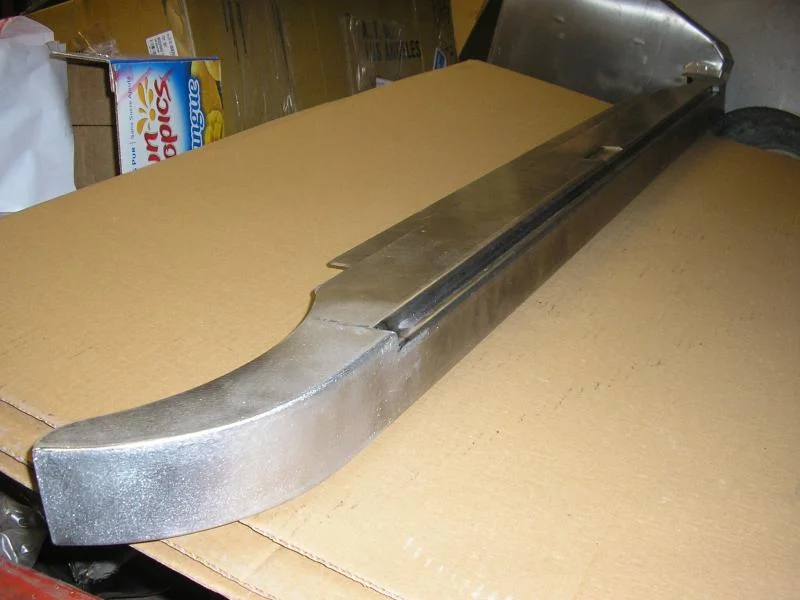

check out the following photos from a Mud buddy of mine awl_TEQ you will see that the late model sills that he sells leave a lip to lap weld over
I've got a set of those. Amazing work.
Sill Installation
Does the floor panel go under or over the sill skin?
Trying to make mine work right now and getting frustrated.
If i weld the sill skin on the vertical part, i get to much gap at the bottom.
If i weld it on top, then i need to squeeze some nuts back there and weld those in.
Any info will help!

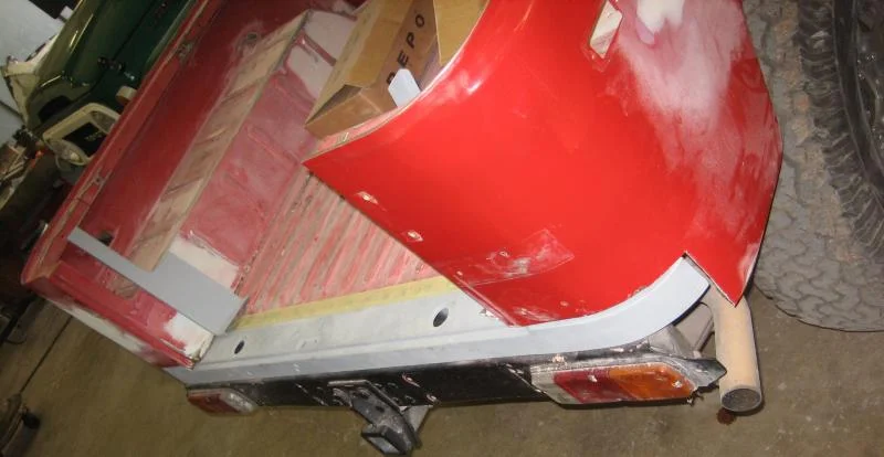

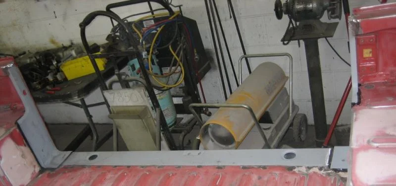

Don't know if these pics will help but worth a try. One piece sill and corner channels from CCOT.

Personally i wouldnt worry about copying the original design- imho it was horrific design anyway- one of toyotas major design blunders on par with the fj55 drain channels on the front quarter panels......
do it your own way and chances are it will be a huge improvement.
I agree. The original design is a mud catcher. Here's what I did--a 2.5 inch 3/16 walled tube with angle iron welded on the side for the floor to sit on:

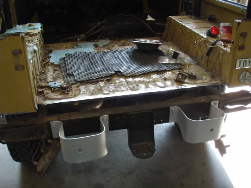

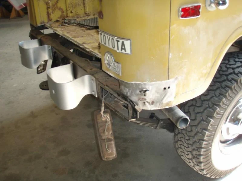

77 sill replacement
Here is my 77 with the old sill removed. I'm dropping a new CCOT unit similar to Sea Knight.

Wow. had I done my research properly i would have got that awl-teq sill. Mine is a piece of 2x3 steel, beefy enough but i had to weld the bolts in. There is no indent for the door catch either....
I ended up welding the floor over the sill since it made the most sense.
You can also see where i added 1/4 flat bar instead of the captive nuts for the spare carrier. worked out great. The sill cover is made of 16 gauge as well, so pretty solid.
