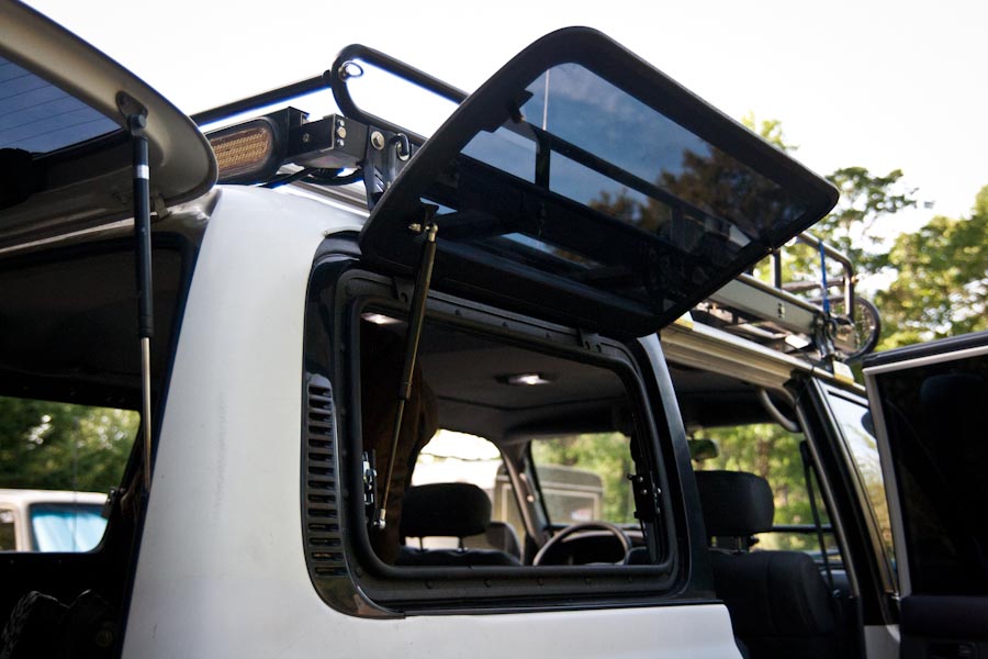

Wagongear designed but expensive .....using factory glass. Couldn't you buy the factory glass for your design?
https://forum.ih8mud.com/threads/80-series-flip-windows-just-to-prove-that-they-do-exist.729292/
I should have read Kevin's post.... Toyota glass $140.00 needs to be tempered glass to drill mounting holes
Wagongears windows are top notch and very well executed but the price point is more then Im willing to spend. The cost goes much higher when you add in glass option. Like others I dont use rear windows when I drive. What I planned behind the panels will keep me from using them so glass is getting less important thanks to your guys input. Given the cost Im leaning more to solid panel.

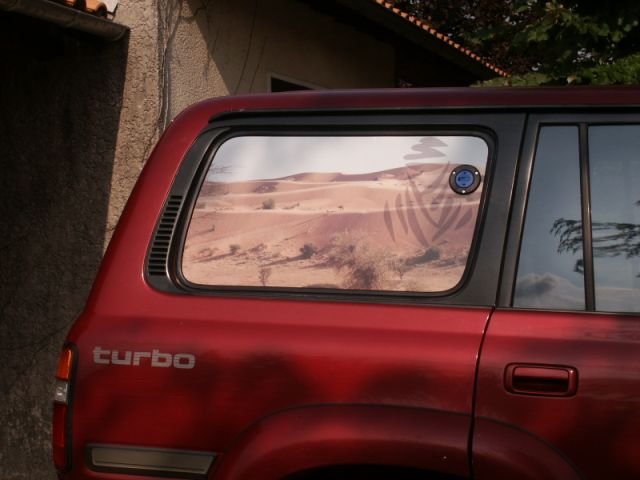

If you're wondering what an 80 looks like with the rear windows deleted, here's an idea. Theft is a big problem where i live, so before painting and body work, we welded in 18ga sheet metal and reinforced it from behind in an "x" pattern. Kept the rear air vents in place so it would look less awkward.
I love the look and like someone said, I can't imagine these windows being gone doing anything to affect visibility. I personally don't notice.
View attachment 944314 View attachment 944315
Doesn't look bad at all. Do you have a profile shot a little further back?

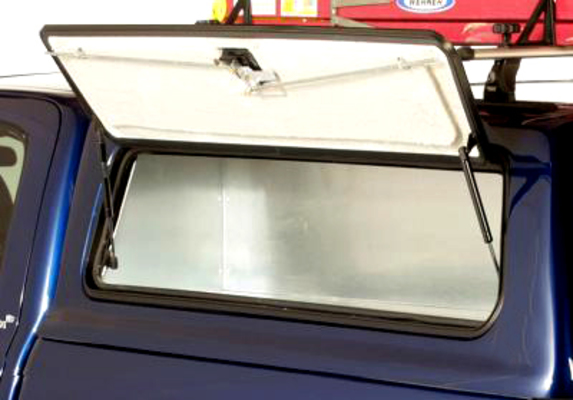

Please post up any hinged windows if they are available on your side of the pond
The bottom picture is from Leer they make Caps for pickups....not that it would fit but could possibly be copied for design....could be where Kevin at Wagongear got his inspiration... Might give them a call..
