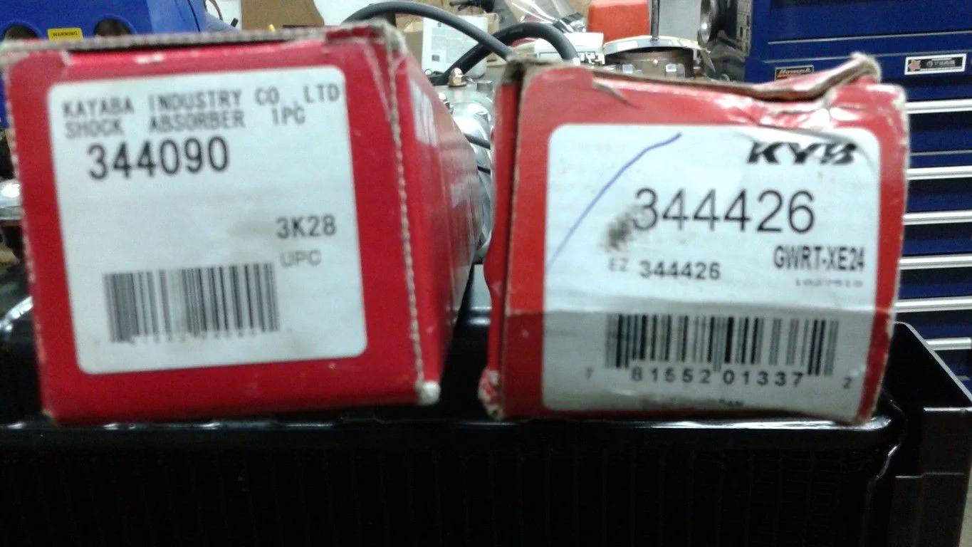

I'm running KYB on my 1980. The 344090 are the rear. The same length compressed, slightly longer extended than the old OEM's I removed. Definitely better than the old shocks as far as ride goes but I don't know how they would compare to the other brands.
