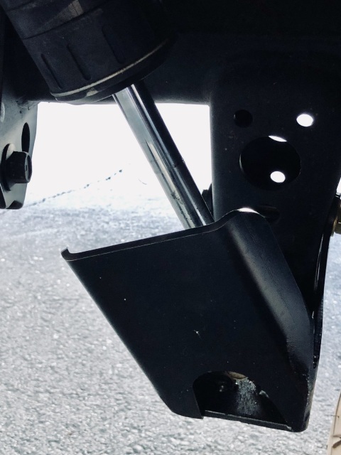

Does anybody know of anything available for the 100 series in terms of rear shock protectors? I saw that Jason @ Trail Tailor has a set available for the 200 (I was bugging him on Instagram about it haha). Also noticed there are a ton of options for 4Runners/FJ's, etc., but nothing for 100's? Why is that?
Would love to throw something on there.
I'm attaching a few pics of what I am talking about. Something like the blue colored protectors (FJ Cruiser) would be ideal since they protect the bolt head and act as a skid.
Trying to stay away from the Icon shock protectors because they only have one attachment point and people have said they can rotate and cause damage when hitting something (not good obviously).

I looked at the 100 shock guard and even posted it up and no takers. The biggest issue with the 100 series is the clearance from the shock to sway bar. It has a little space with a stock shock or most other common shock offerings, but the larger diameter shocks are really tight, especially if the guys don't extend the rear links after a lift. I'll play with it since I have the 45mm big bore adjustables on my 100 now and see what can be done.
I have a bolt on guard/shield idea that takes the sway bar into consideration. Picture my 200 guard with the inside trimmed to clearance the sway bar.

Here is a 100 rear at 100% full free hang. The upper arrow is not so much a concern with the shock interference. The lower arrow is where the relief needs to be cut in for clearance. The good thing is the sway bar actually protects the inner side of the shock in most positions. But the front out outer is vulnerable to rocks, rock debris etc.
I emailed @Kabanstva to give him an idea of what my original design/sketch was, but here it is for all to see. It is very similar to the 200 design. This of course is the right side.
J
