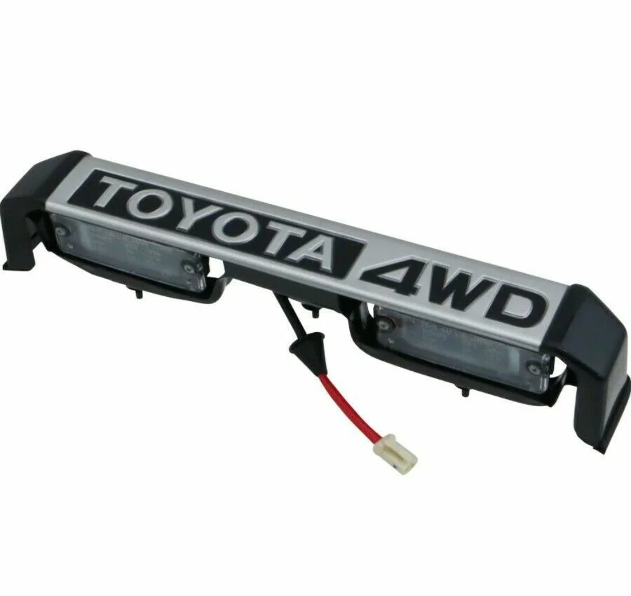

Hello,
Does anyone have a 70 Series with a rear license plate assembly like this that they can measure for me? I believe the version without the light would be the same size.
I am trying to fabricate a rear license plate holder for a swing out bumper on my 80 Series. My options for an 80 Series part are all NLA.
I appreciate any help.
Thank you
edit - i think this is from a HZJ71

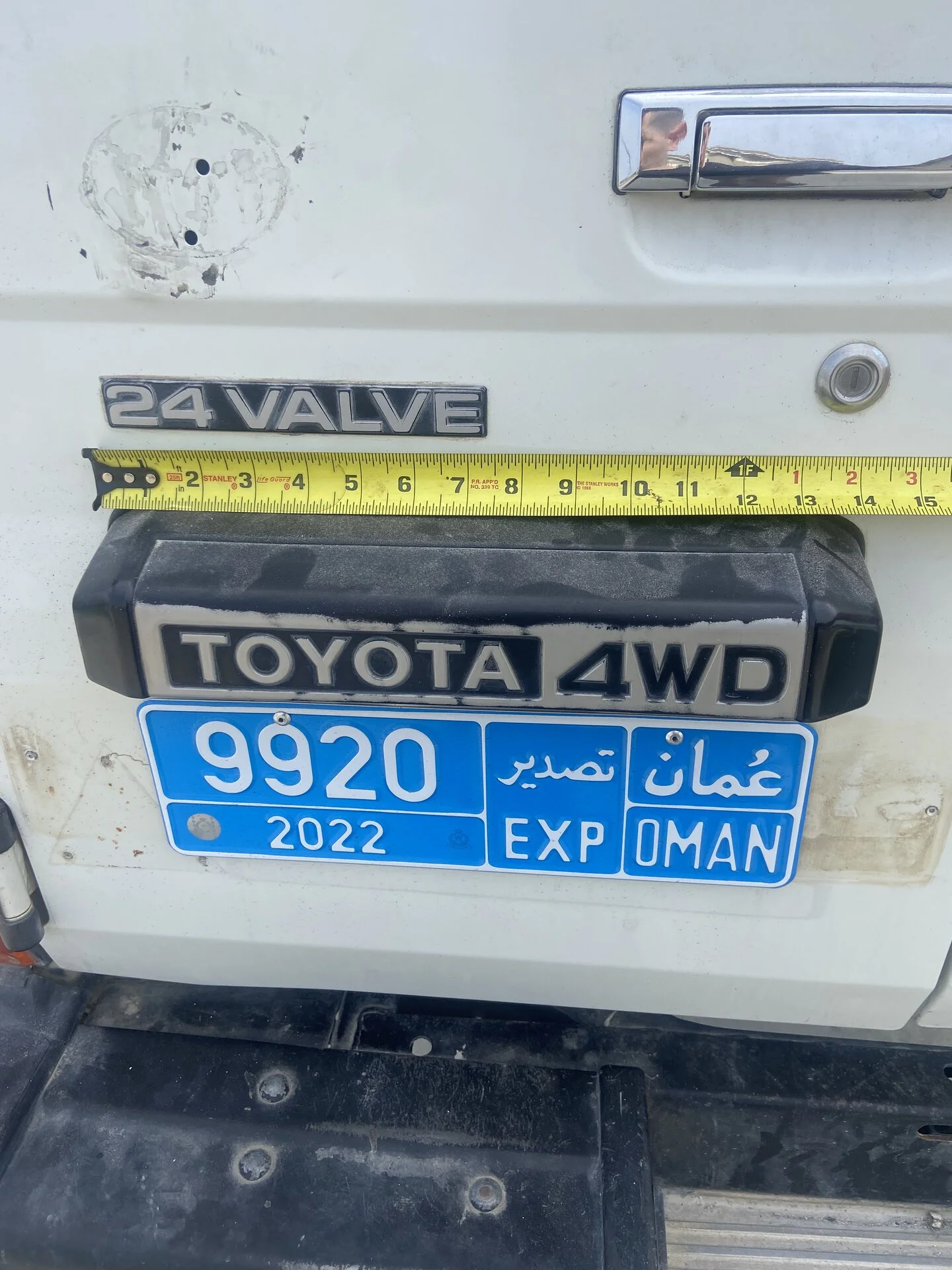

Hope this helps
That is great. I think I can figure something out now so I can stop getting pulled over by the police.

I just looked at the GCC and General Countries '94 80 series and they didn't have the license plate on the optional swing out. It was/is on the left rear door. Not sure which parts you are looking for that are NLA? Do you have a part number?
I had an order for about a month with Amamaya for 8127060120. They had to cancel it because their supplier could not get the part.
My plan for 8127060120 was to place it on a steel plate on the swing out jerry can holder. From what I can tell, the left rear door surface where it normally attaches is flat.
Then I realized many of the 70 Series had the same style light mount. It didn't really matter to me if it said Toyota 4WD or Land Cruiser. My goal was to have a light setup that wasn't going to break after a year. I did this on a 4Runner swing out and it was always a mess.
